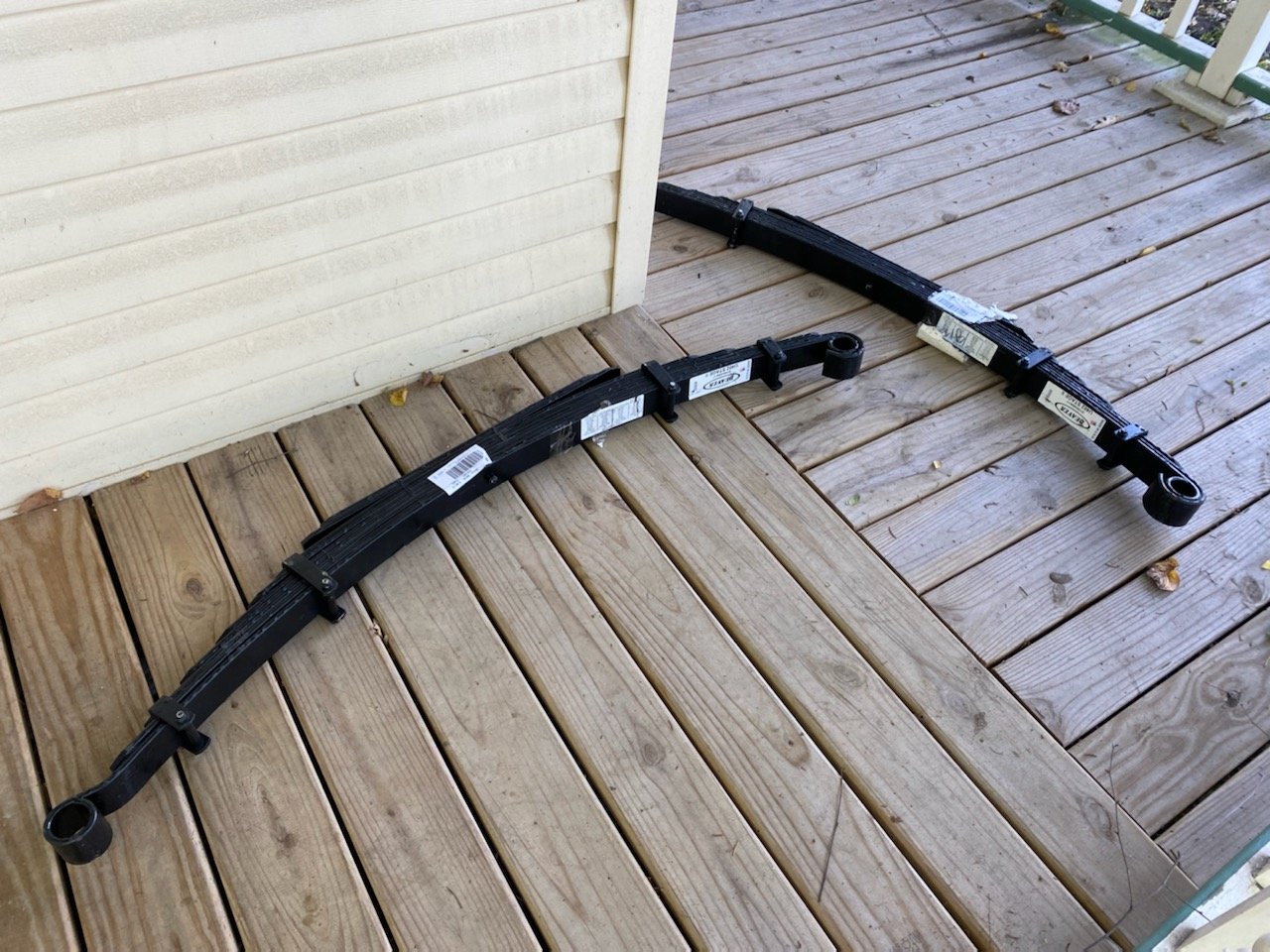

    I purchased from Runnin4Tacos.
    Deaver told me the correct way to repair would be to disassemble, drill out rivet, replace rivet and then reassemble. Deaver and Runnin4Tacos said I could compeltely remove the rebound clip because it's not necessary.
    Runnin4Tacos basically said they're not liable because I didn't pay for insurance. They said to file a claim with UPS or pay out of pocket to have it repaired by Deaver.
    I'm not happy with their response because in their disclaimer they specifically state "We try our best to at least wrap it before we ship it." Yet they did not wrap the springs, they sent them raw.
    (Which leads me to believe the springs were already damaged, and wrapping them would have been proof that they were sent out damaged. So they sent them out raw, knowing that I didn't purchase the insurance.) Call me crazy
    I told R4T that I want to exhange for a new spring, and I will even pay the shipping cost both ways.
    As you said earlier, "You paid a premium for the quality and service... be sure to get the value you paid for." I am not happy with cutting off a rebound clip, I paid a premium and I want to receive the quality that I paid for.
    Still waiting for a 2nd response from R4T...
    What do you think?

    Taking a leaf pack apart is pretty easy. Just use some clamps to hold it and unbolt then slowly release. I use several clamps at same time so I can preset one looser than other while loosening. It only has a lot of tension at begining. But mark front back or always keep them same direction
    I'd cut it off and buy some new clamps you don't have to disassemble. May not be bad idea to put some pads or shims under these. My limited understanding is more clamps will limit flex some but not sure if that matters. I had to add clamps when I added extra leafs to my OME because the clips are pretty short. I used both of these types on mine and seems to be fine so far.
    https://www.amazon.com/inch-Axle-LEAF-SPRING-CLAMPS/dp/B0084HA1GY
    https://www.amazon.com/dp/B001DKSM7Y

    Thank you. I just don't want to have to do that to a brand new set of springs. I understand the ease of it, but I don't think I should be the one taking the hit on this. I have the tools to do it, but I'd rather not. I want them original and new as I had purchased them.

    I’d be dubious of welding on spring steel. Might make things a lot more brittle.
    I’d warranty it.

    No way shipping caused the clip to loosen. It was loose before shipping but a chunk of dirt or paint probably had it stuck in place. Whomever riveted the clip in there screwed up somehow. Personally if the rattle was excessive once installed I’d run a blob of black silicone under it and call it good.

    You have my support! But unfortunately, that's not what you need. I'd keep on R4T and let them know, in a non-threatening way, that there's quite a few people on TW monitoring your situation. It would probably behoove them to make you whole and deliver what you paid for. If the clip can be cut off with no ill effect, great! Send me a new leaf pack, I'll send this one back to you, you cut the keeper off and sell it to the next guy who doesn't care.
    Worst case scenario... I'd take the pack apart and have the rivet professionally repaired/installed... wherever you can get that done locally...?

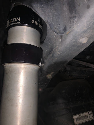

    steve
    be careful with that loose clamp. it can actually make contact with your driver side shock if its all wobbly and skew like my Deaver J66 did:
    AWxXHcnUIlhJn6ccdjVUDkpKZC5px3AZeNU_o4b8_e415036147af2d89f3ee51e9b44a9bed4e316d7f.jpg
    I didn't want to weld it, or re rivet it back into the leaf , or get in contact with beaver deaver cuz I am assuming there is a 10,000 year long back log due to supply chain BS excuse. I just popped off the clamp (it was super loose). The pack is still in line so far. all is well after a few desert trips.
  14. Oct 29, 2021 at 3:51 PM
    #34
    2000prerunner23
    2000prerunner23 Well-Known Member
    Nov 29, 2018
    #274262
    906
    steve
    Yeah like i said mine was loose too (drivers , rear portion). I dont know if it was pulled loose (out of the rivet hole) in shipping as the clamp got hit around, or if it was factory F up, or if it was me beating the shit out of it and my Icon 2.5" shocks are too wide so they knocked it out as the spring cycled.
    I think at full droop the pack is still ok and it wont separate due to our J66 springs only having 11" of travel
