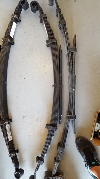

    I had Deaver design a set of leafs for me with a second stage overload like @Jp450 shows. I won't know the exact lift til I put the bed back on because I only measured to the wheel well. I had to pull the overloads off until I get the toytec adjustable shackles set back down. With the Deaver kit you only need stock length shackles to get about 3" of lift. Once I get the toytec shackles back to stock height I should be able to put the overloads back on.

    Finally got the shackles adjusted and the overload leafs put back on. Still not sure exactly what the lift is since I only measured to the wheel well with the box on but it is around 3" I think just from the springs plus 1/2" for the shackles.
