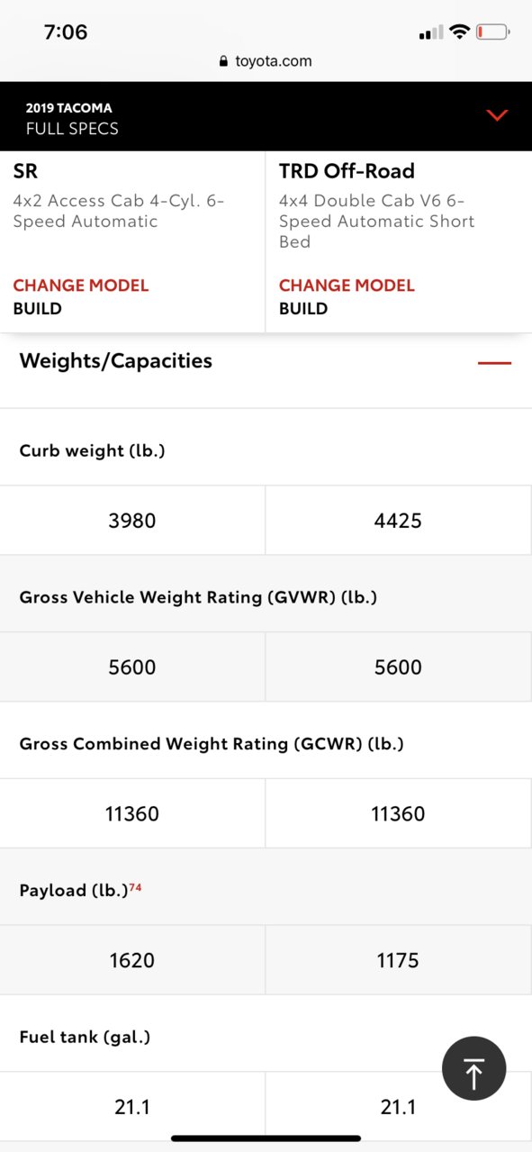

    Maybe consider the curb weight of the truck. I picked the j66 because of how soft it was, and honestly, could have gone softer. I am running 8112s on the softest settings also.
    Considering a double cab v6 4x4 is 500lbs more and has a 500lbs less of a payload ratings seems to me that a correction needs to be made on the evaluation of the springs being used. And, 0lbs payload rating on a J66 is probably rated for the most common Tacoma models, and after correction for a 4x2 access cab, could a j66 really carry 500lbs?
    IMO, these spring ratings are for the DC 4x4 @ 4450lbs starting.
