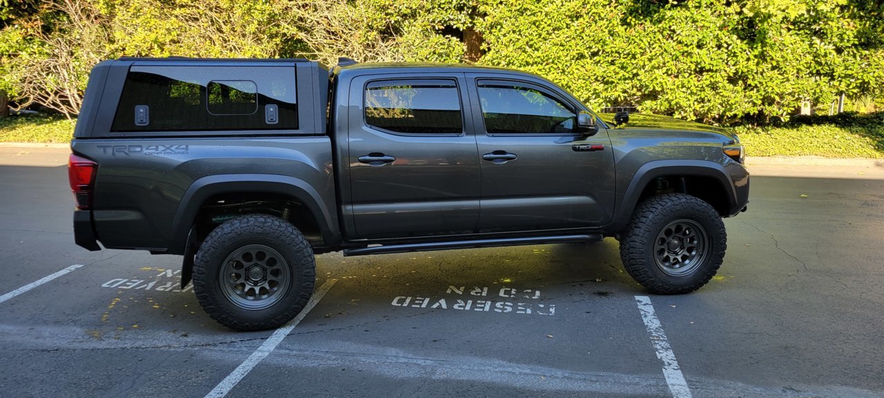

    Not sure on the exact numbers... but a full size 33" spare, BAMF sliders, RSI smartcap, and a steel rear bumper. Even if I add a ton of weight (tools or camping) there is next to no sag. I think properly specified (stage 1, 2, or 3) net you about a 2" lift.
