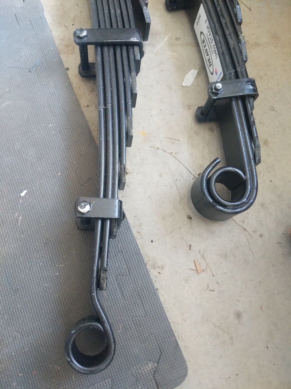

    I found this picture....
    BalutTaco and Tcodyw88 like this.

    I have Deavers... the Military wrap (double wrap) goes towards the front and the Berlin eye (single wrap) goes towards the rear. Assuming you have stage 1 or 2, there's no specific left or right side, unless labeled otherwise.
    The purpose of the double wrap in front, is if you break your main leaf, you don't catapult your axle. At least that's what I read on the interwebz.

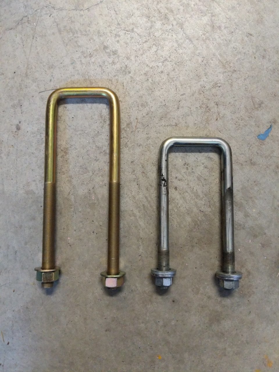

    Nice! Looks like the single wrap is on the aft end. 96-ft pounds sounds like a lot on those u-bolts will at least the ones that I got which look the same that came with my icon AAL kit. Are the Deaver u-bolts zinc gold color? Those were the ones that were sent initially by runnin4tacos with the kit but they had questionable washers and nuts that were different threads on some so I returned them. This pic is in comparison with stock. PXL_20210615_162034600.jpg

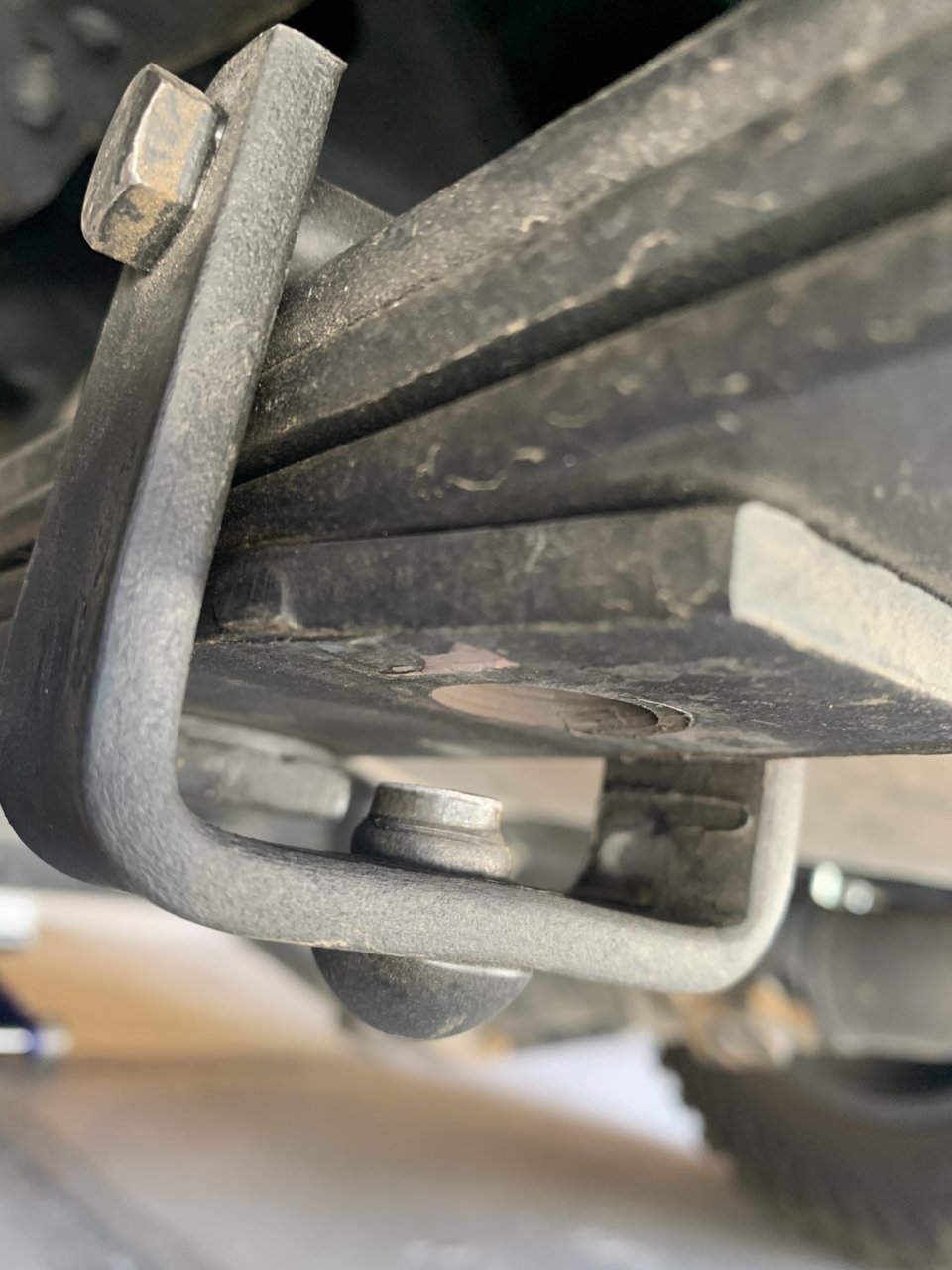

    Went to check torque after a couple days of driving and noticed this on my new Deaver U402 leaf pack mind you I have zero weight in the bed and a stock rear bumper. Kinda frustrating when you think your spending a few extra dollars for a better quality product. But other then this the ride is nice.
    I just removed the clamp as I didn’t want to hear it.
