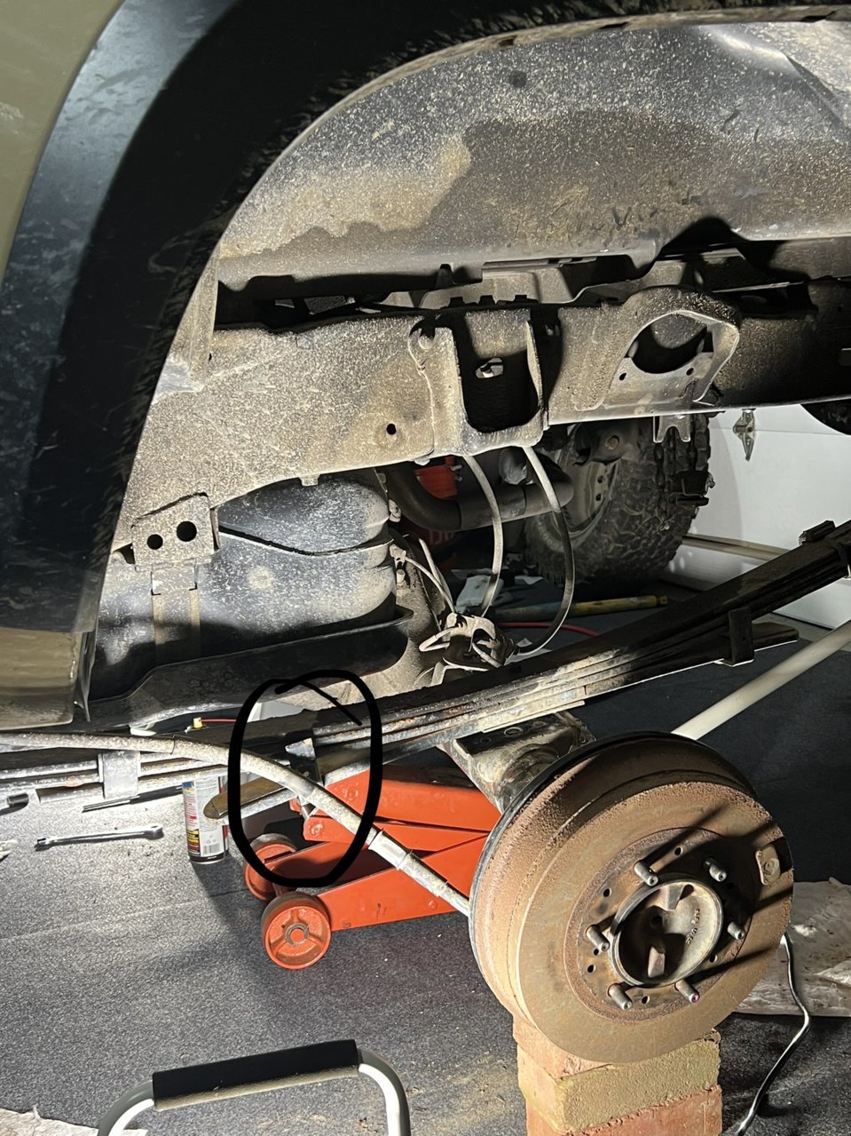

    9217AEC9-A89B-4354-8255-298289DED07C.jpg Where did you guys secure this clip on the new leaf springs?

    I didn’t secure it on the leafs as there really isn’t a place. I’ve checked for wear and have found none. It’s been about 6 months with decent off-road miles. I’ve incorporated check for wear with my other maintenance items.

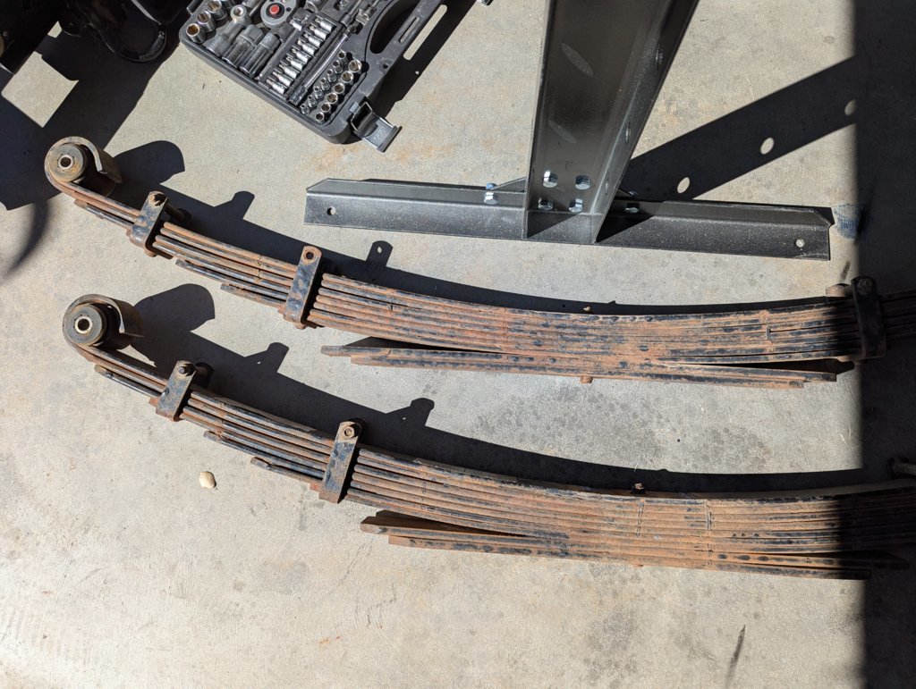

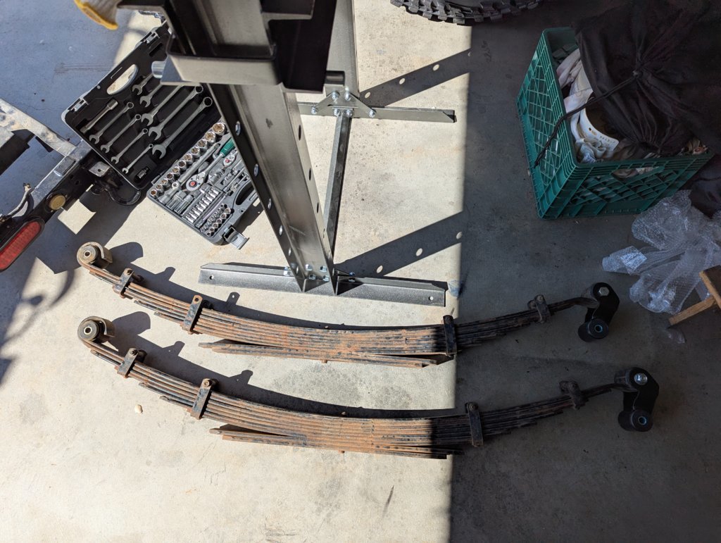

    Looks like the proper thread for my question: how the military wrap leaf should be installed in the pack? I did disassemble the pack to do maintenance and figured out that the second leaf which ends up with military wrap has a slotted center hole(oval), all other leaves have round center holes. It means this leaf can be moved in the pack to make a contact with the front eye on the first(main) leaf. So, it can mostly touch(wrapping) the eye or it can touch it just a little bit. Looks like it can't move while the center bolt is in place.The photo of the stage 3 leaf pack after 4+ years of hard using before I disassemble it. Just looking for a confirmation how should I proceed.

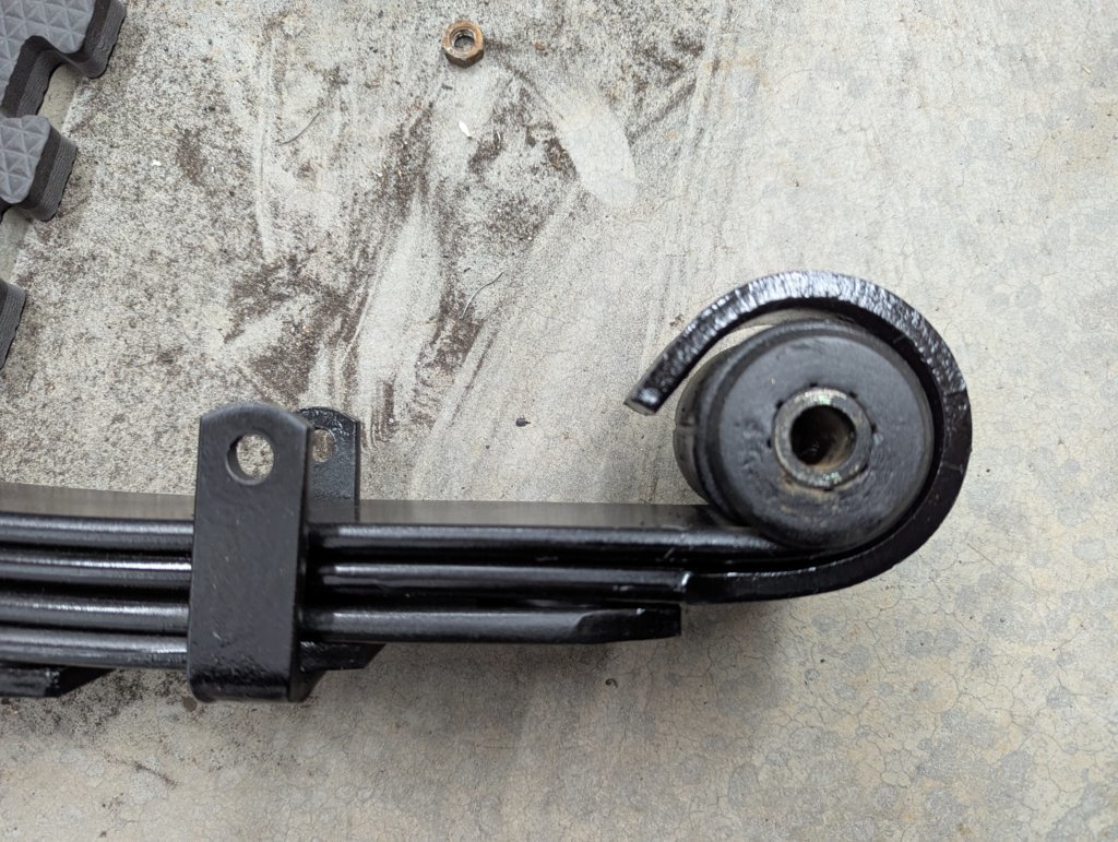

    Looks to me like they are assembled correctly. I would bet the oval holes you are talking about didn't start out oval. They are probably oval due to 4 years of use.

    The photo above was taken before I disassemble it. This is after maintenance and assembly.
