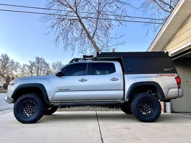

    It went great. I'll need to dig up some pics and edit the post later. For now I'll say that when I finished the install it looked sky high. My suspension was 5 1/2 inches taller in the rear. That said, I was on stock shocks that were beat to hell with a GFC on the back. The rear was sagging pretty significantly.
    The 5160/Deaver Stage IIs settled some, but the lift is still over 2 inches. That's because their load range is rated 400-600 and my constant load is only about 375. It's not too stiff, it just sits higher. I used the brake line spacer that came with the 5160s but nothing else. No carriage extension or extended brake lines.
    edit:
    pic right after install
    pic after it settled
