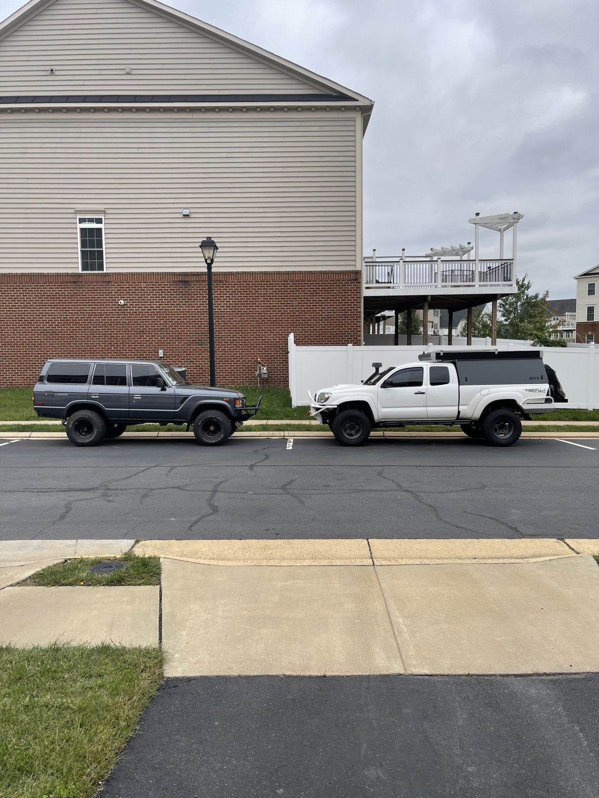

    I got a set of used stage 3 leafs. I think I've calculated my rear weight as it sits, around 650lbs. 275 for the GFC, 320 for rear bumper/swingout with tire, and misc in the bed. I also have 285s. Also note, my front flares are trimmed 2". I want to add more weight but also want to stay light. Its always a tradeoff

    Yup...I have about the same stance...with out your weight of course. I don't like how it seems to load the front so much
