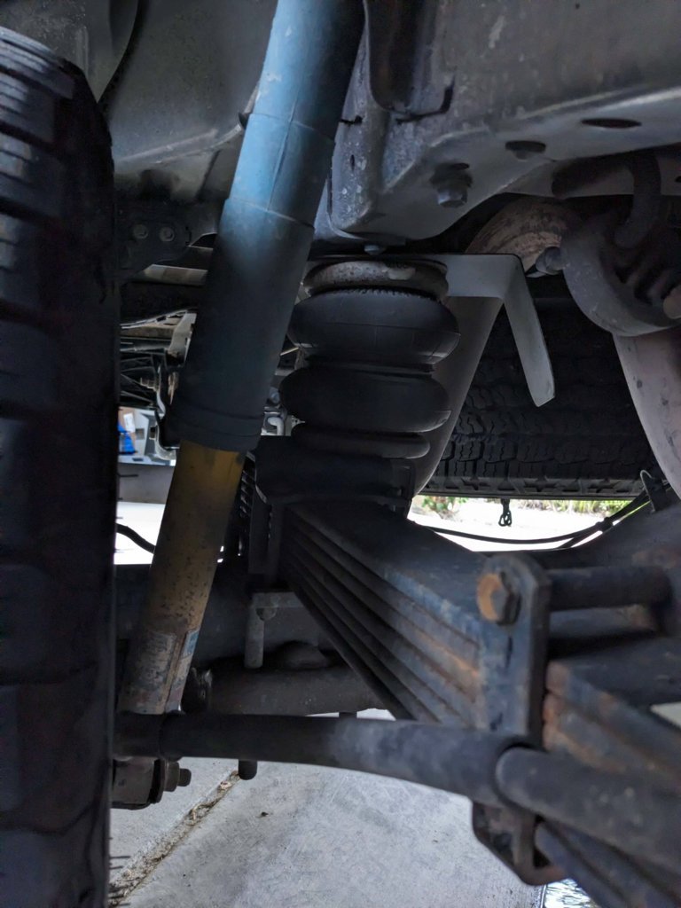

    I had a camper (4WC Swift, ~1000lbs) on my 2018 OR (double cab, 5ft bed). Previous owner swapped stock leaf springs for Deaver Stage III. It rode great with the camper on the bed, but now that I've sold the camper, the truck is miserable to drive. Bounces all over the road and you feel every little bump. The previous owner also installed airbags (put them in before the Deavers, decided they weren't enough for the camper), but I've never pumped them up. My driver's side rear shock may also be blown, not 100% sure.

    Post a pic of the shock that may be blown so we can see

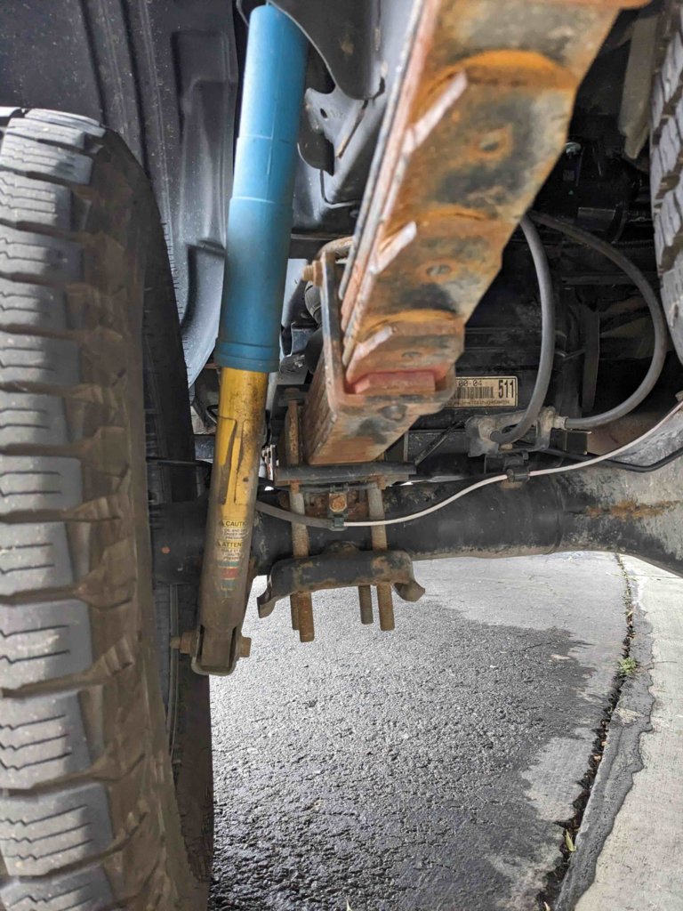

    Pict of the driver's side (1st image) and passenger's side (2nd image). I know nothing about these things, but the guy I sold my camper to thought the driver's side looked blown.

    Those shocks aren't leaking, just dirty..

    ×2, I see nothing visibly obvious to indicate those shocks are blown.
