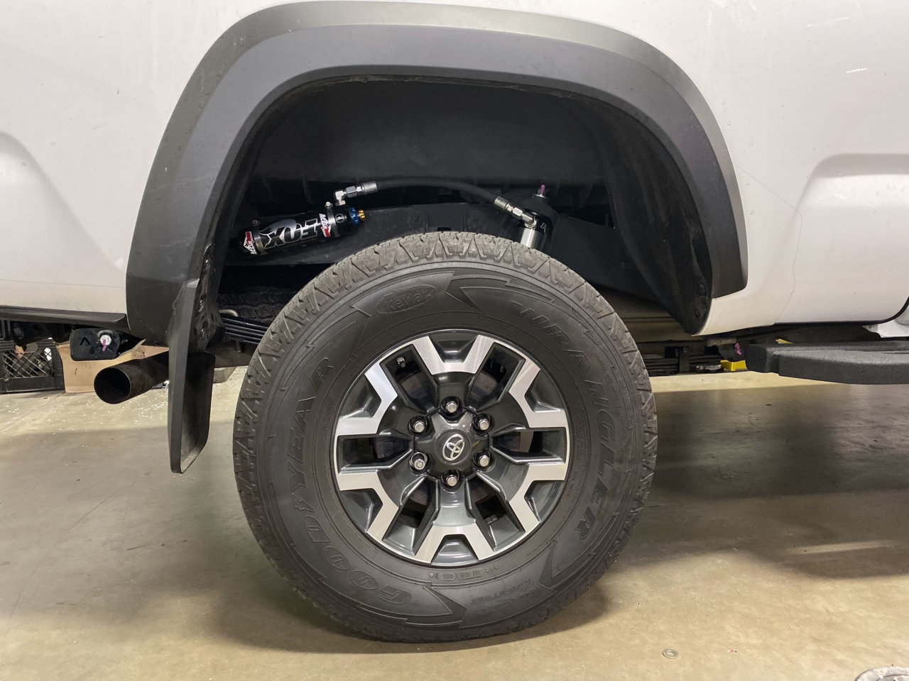

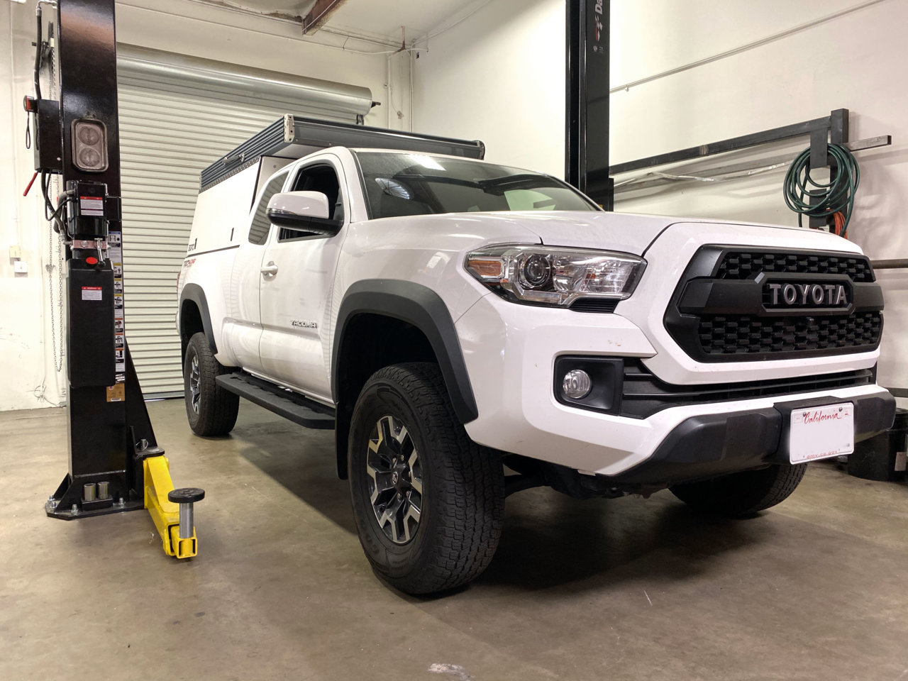

    We just installed a Stage II leaf pack along with Fox 2.5 shocks. Its about 25" from center of wheel to fender

    Those measurements were with the camper on the truck, as you see in the photo. (sorry not exactly what you were asking for)

    I see this customer has a GFC (they weight about 250-270 pounds) do you definitely recommend going with the stage 2 if running something that weighs that much?

    I don't recall this customers entire setup with weight. Looks like their are steel rocker guards as well. Its best to add up the approx weight on your vehicle own vehicle and compare that to weight ratings on the leaf packs you are interested in.

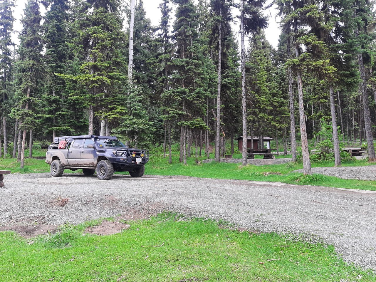

    Here's my Deaver stage 2s got about 2.5 inches of lift in the rear with the weight

    That actually appears to be a home built Ripcord camper, not a GFC
