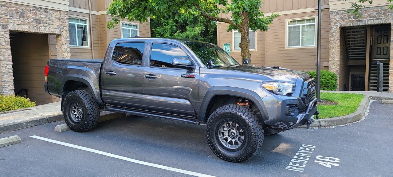

    grex
    grex Member
    Jan 7, 2016
    #174283
    21
    2016 TRD OR, DCSB, MGM
    What are you running on front suspension? Tire Size? Looks super nice!

    Bert
    Seattle, WA
    2017 TRD OR DCSB
    All the things!
    At that time, I had ADS 2.5's with 650 lb coils. The tires are 285/70/17.
    Thanks for the kind words!

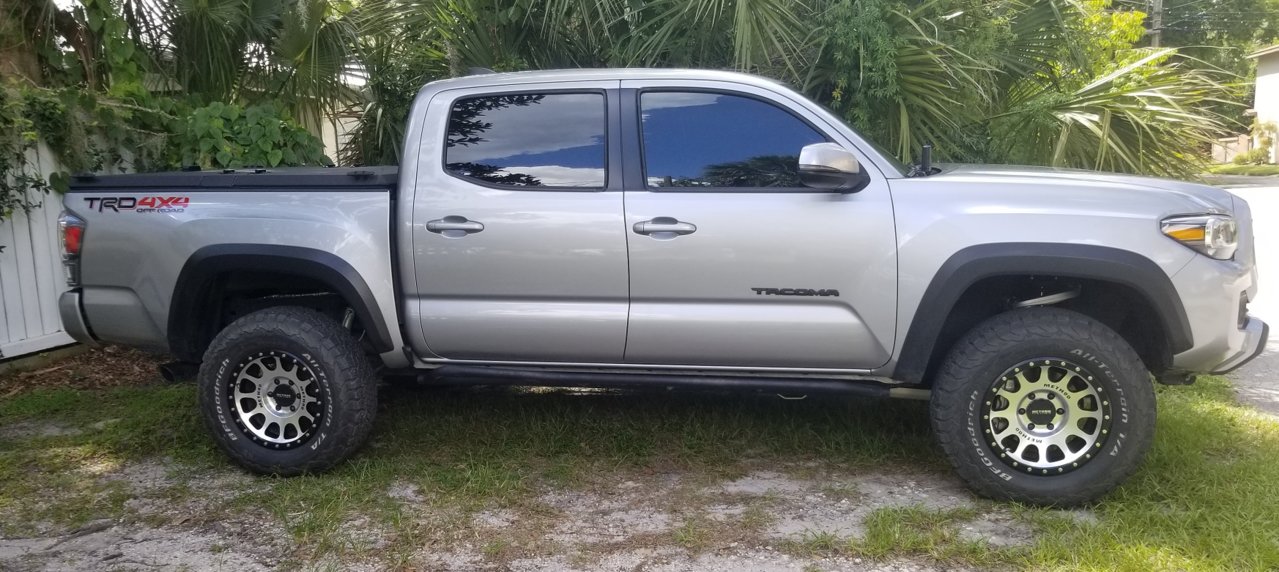

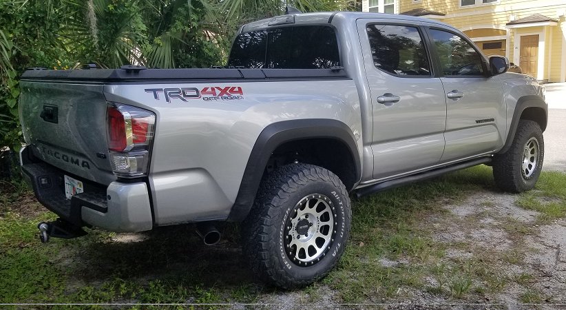

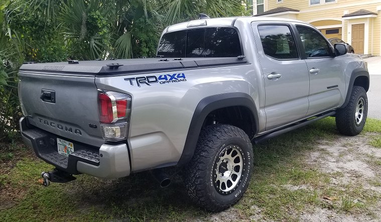

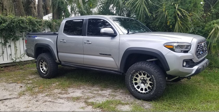

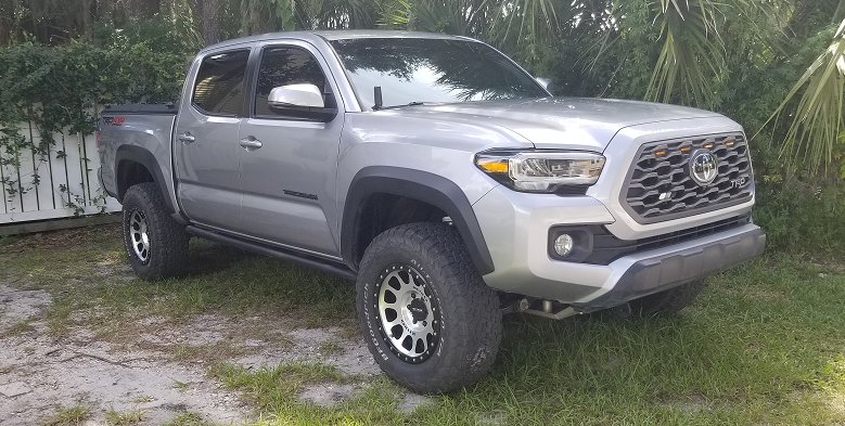

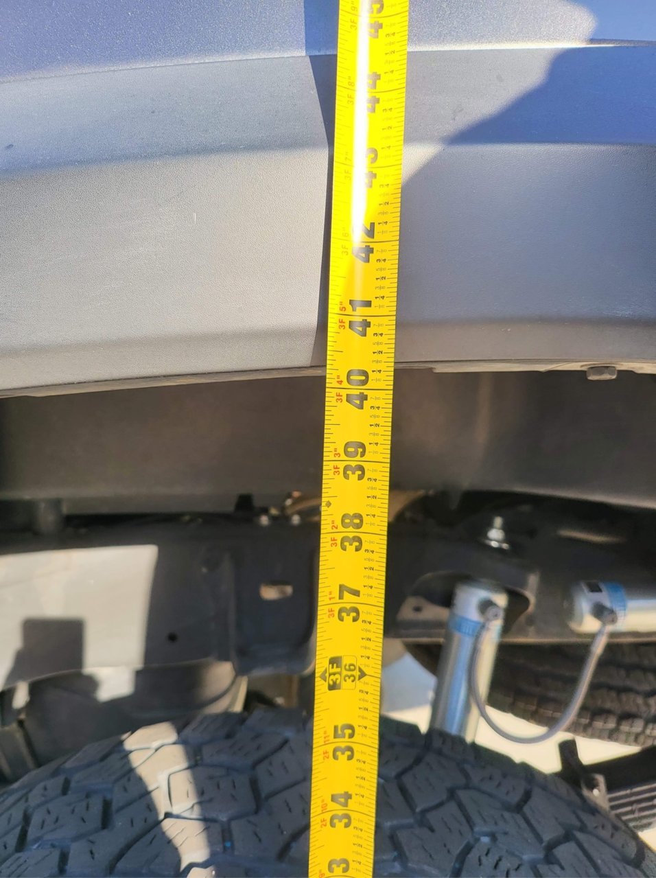

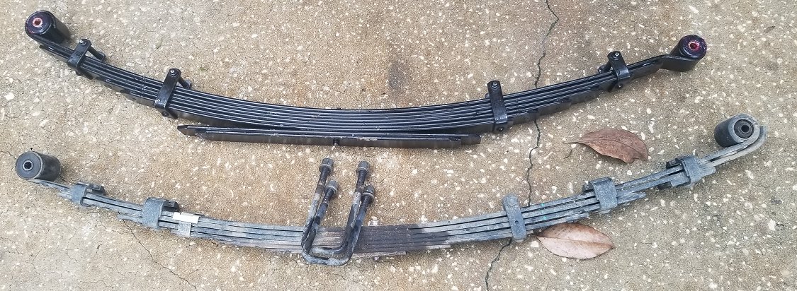

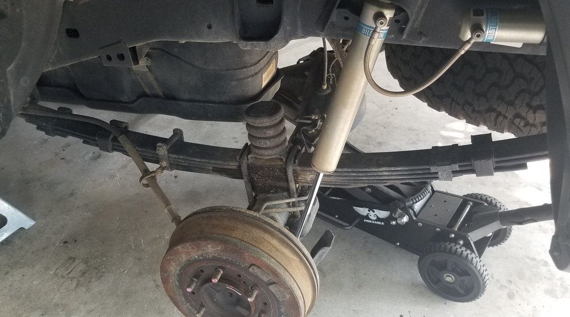

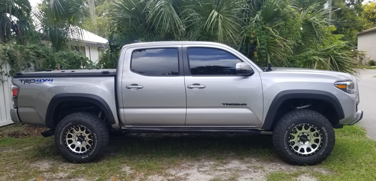

    Replaced Headstrong 3AAL w/3 degree 1/4 driveline angle shim with Deaver U402 stage 1.
    Before and after pics made easier b/c I just pulled off the stock RED bedside sticker and put on a vinyl blue one.
    The images with red bedside sticker are with 6112 600# in front and HS 3AAL.
    The blue bedside sticker images have 6112 650# and Deaver U402 stage 1.
    Bed weight is the same in both images and I tried to put the truck in the same spot
    - DB cover with tool bars, tools and 2 lights mounted (55#)
    - Lithium battery box w/inverter and power management (46#)
    - ARB single (19#)
    - Safe jack and steel mounting plates for 2 bottle jacks (17#)
    - Front molle (estimated 20#)
    - bed mat (???)
    - Lil bees bed stiffeners (11#)
    - Tools and misc. recovery gear including maxtrax and homemade steel mounting brackets to mount to DB cover (estimated 25#)
    - DRT hitch skid (9#)
    Total bed weight ~ 202#.
    I also have sliders, full aluminum skids (an SSO bumper and SB winch on the way) and I have full size spare with aftermarket wheel which is heavier than stock.
    Hope this helps someone on the fence about Stage I and II. So far I am very happy with this decision but time and some trips with additional packed weight will tell.

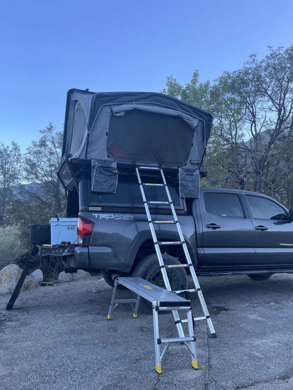

    Deavers Stage II with RLD Cap and FSRGo Odyssey RTT. Roughly 315lbs constant weight. 37 1/4 inches from floor to fender. No issues. Took them off and no weight. 40 inches and bouncing around. Trying to figure out which leaf to remove to make it more compliant. May trade for stage I.

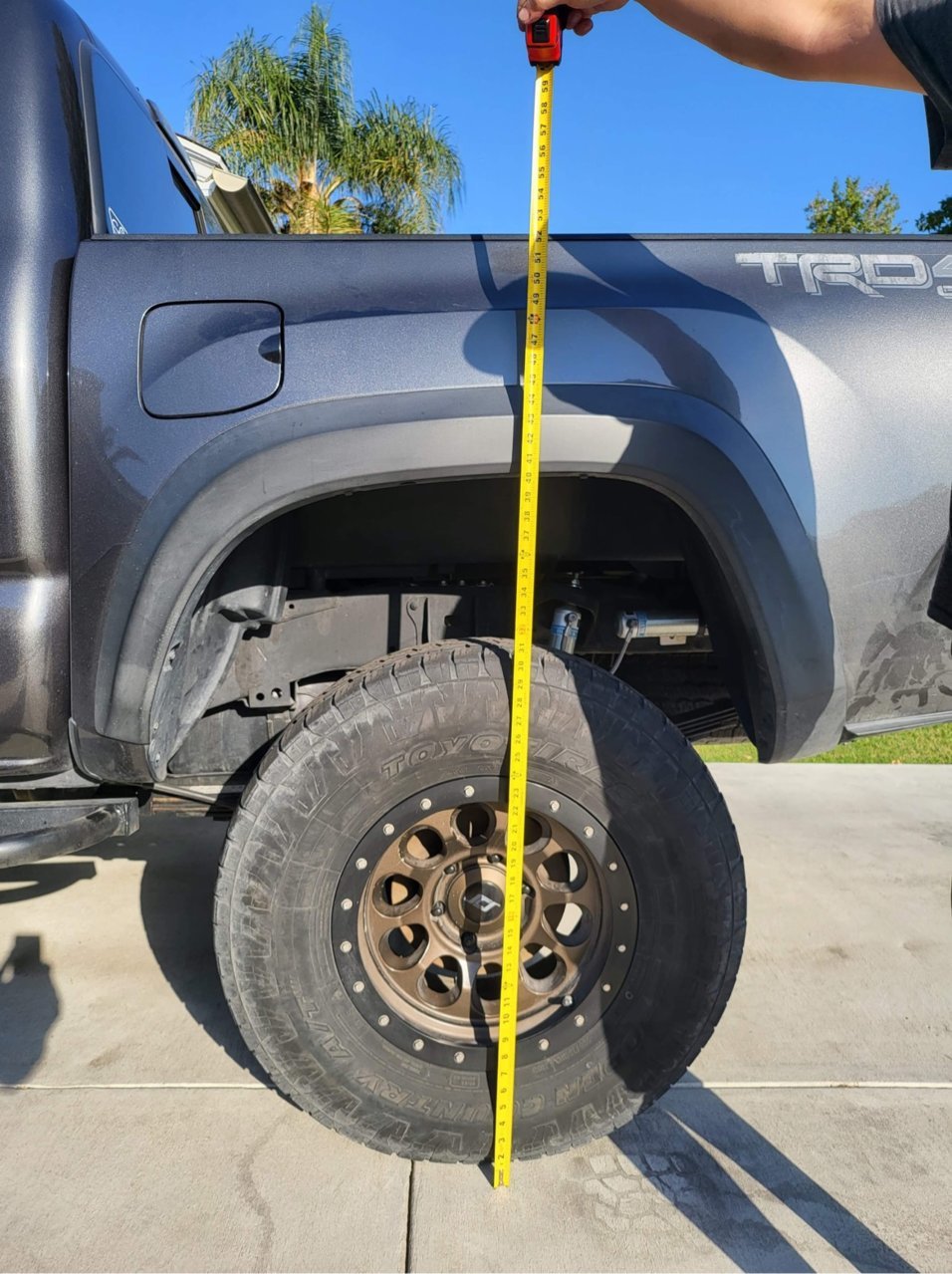

    Not trying to be rude, but the only lift measurements helpful to anyone else on the internet is center of hub to fender
    ETAV8R and TacoSurfer27 like this.
