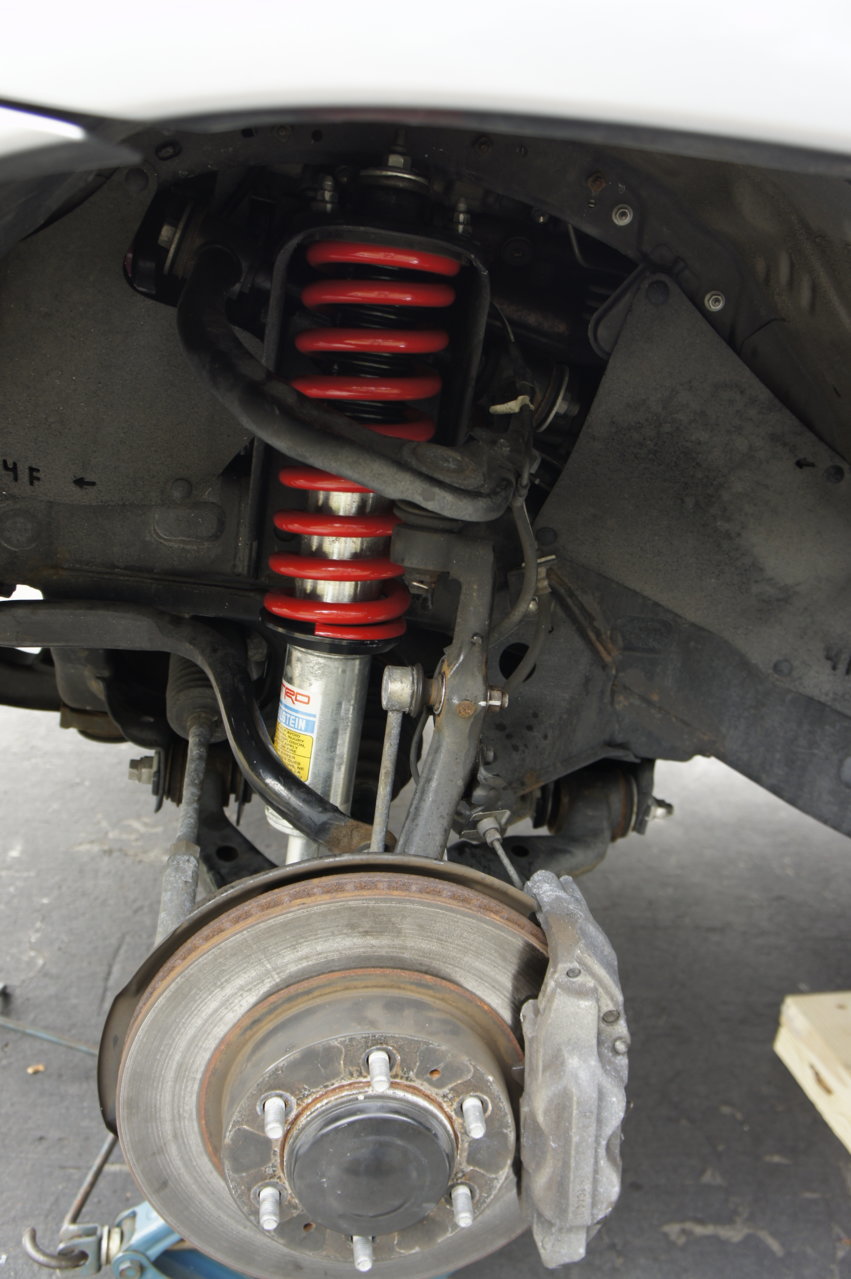

    I added a set of 6112/5160 along with Deaver Stage 1 Leaf Springs almost 2 weeks ago now. Loving the much improved ride. All purchased through Hotshot Offroad.
    The ride height has already settle some, current gains with a full tank of gas and an additional ~300#s of bed weight, before and after...
    Before Front DS 34 3/8 After 36 3/8.
    Before Front PS 35 3/8 After 36 3/4.
    Before Rear DS 35 1/2 After 38 1/8.
    Before Rear PS 36 1/8 After 38 7/16.
    memario1214 likes this.

  20. Dec 14, 2024 at 4:16 PM
    #100
    -Rorschach-
    -Rorschach- The Black Helicopters are coming…I gotta go!
    May 8, 2020
    #327337
    5,862
    2019 Silver Sky Metallic Tacoma DCLB TRD OR 4x4
    Finally got a around to getting a current side pic for reference, see above.
    Dfpftw and Taco#50 like this.
