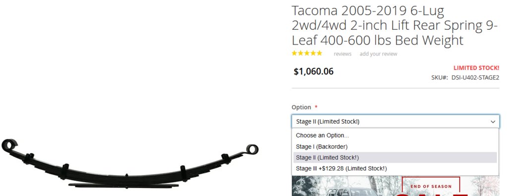

    So who's got the best deal on Deavers right now? Wheelers is at 15% of tell the 7th. putting them @ 800 before shipping

    I've been calling around for stage 2 & nobody has any in stock. Just as a heads up if someone is on the fence

    I spoke with Wheeler 3 times just a few days ago ago, looks like they are sister stores. Does trail gear have a brick and mortar store or is it only online

    I have no clue if they have a store, I submitted a request for the proper link to wheelers and trail gear responded with above link
