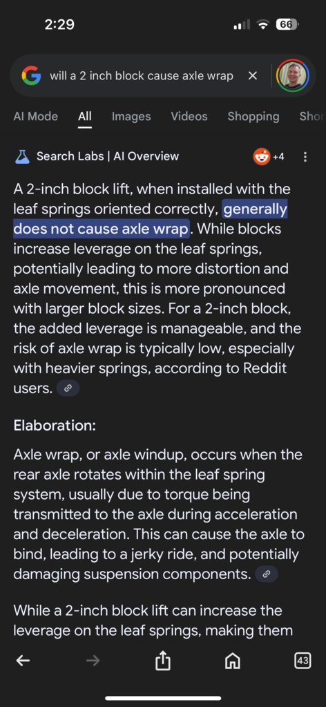

    Yeah, was just making a comparison. I’m not sure if my leafs need to replaced or not. Don’t have no issue with them, other than the 2” block. I am really starting to lean to AAL’s

    What’s wrong with the 2” block? What are you wanting to achieve by changing?

    Interesting. I was under the assumption that using a 2 inch block is bad that it can cause something called Axel warping. no, I don’t know exactly what that is. I would have to research it. But in other posts many are telling me to get rid of the 2 inch block and do an AAL or upgrade the leaf springs. so I’m just basing my information on those who I think should know what they’re talking about, but it looks like I am going to have to do further research on this.

    AAL and most aftermarket spring sets will be higher rate and will generally ride stiffer. This is needed to support more load. You might not need that.

    So just to clarify…you’re saying there are no negative effects from using 2” blocks?

    I’m not saying that necessarily. It depends on use. If you’re not trying to carry more weight, then it’s a perfectly reasonable approach in my opinion. If it is performing fine to you now, then maybe just leave it alone.

    Axle* wrap*

    OK so what’s causes this?

    Apparently a 2” block isn’t so bad

    Maybe read the article attached.

    lol, sorry. I was at work, just glanced at the post, thought you just sent a picture.

    According to an AI summary of internet comment sections... It literally says "according to Reddit users" lol. You ever asked a technical question on Reddit before??
    You won't feel the effects of axle wrap driving around town. But in deep snow or mud, or on gravely/rocky inclines, you will immediately see why axle wrap is bad. It's a problem with leaf springs in general (some have design features to minimize it tho, like military wrapped ends), so adding any leverage to the center of rotation just makes the problem worse. But there isn't really a universal "too much" for block height. Just more is worse.
    All leaf springs squeak. There is nothing about the design of any of them that ensure squeaks or no squeaks. The squeaks are environmental. If you live anywhere where rust is an issue, you should just get used to greasing the slider pucks every so often. It's easy to do, and makes the leafs ride even smoother after. And make sure you don't grease the poly bushings before putting them in the spring eyelets. Only grease the metal sleeve (both sides) that goes in the middle.
