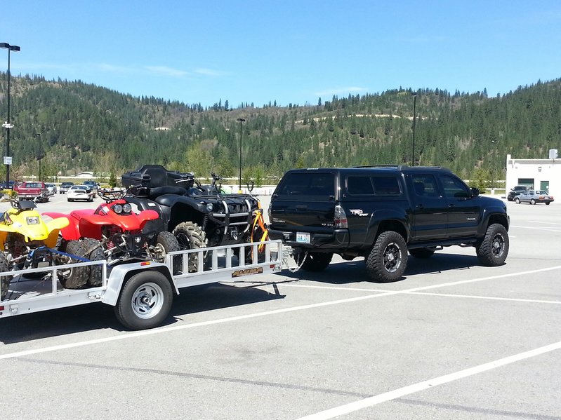

    Here's mine with Dakar's W/AAL towing and bed loaded with probably 400lbs+towing.jpg
    Edit: I'm running Timbren Bumps in the rear which are a huge help with bottom outs on bumps
