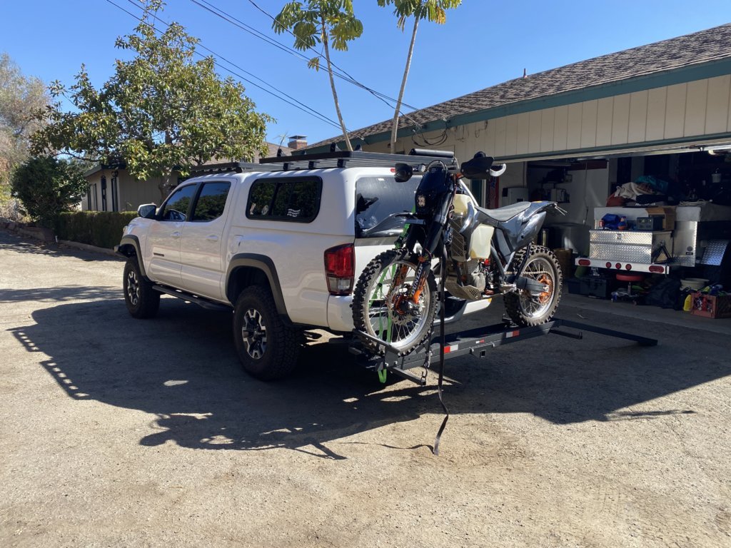

    The main reason for the Daystar cradles:they only mount to the frame, and have a “cradle” for the bag to rest in, allows full suspension flex without stretching the airbag(will tear).IMG_0448.jpg
    Basically it allows us to run airbags for towing while retaining full suspension travel for off-road fun and such.

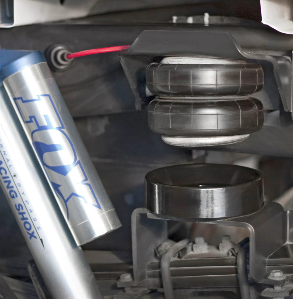

    Correct deaver Stage 1's (I forget all the prevalence of the "Stage 1" term). Awesome, thanks for the quick response, I will be running a similar setup but with TRD pro foxes that I got cheap and rebuilt. Sorry to sub thread this but with the deavers and bags are you also running an upgraded shackle hanger or shackle or needed extended brake lines? I wasn't planning on doing the shackle hangers or shackles yet.

    Hey what shocks are you running? those look like 1st gen raptor takeoffs? I have the Internal bypass TRD Pros on mine that I got dirt cheap and rebuilt (I rebuild shocks on the side), but mine are oriented the other direction (shaft pointing up, piggyback down).

    That photo is pulled from the google machine, not my setup. I have Deaver stage 1s, ext Kings and the ride rite bag system with daystar cradles.

    well... That makes perfect sense. Also makes sense why the spring pack looks significantly different from a deaver pack. Alright thank you again

    Question about the orientation, as i do not know. My thought process may be wrong, but installing the shocks upside down with the piggy back on the bottom would effect fluid flow as the shock is designed to be mounted opposite? Not sure if that is making sense, just wondering if it has any effect on the shock dampening as the res is at the bottom instead of top for fluid expansion flow.
