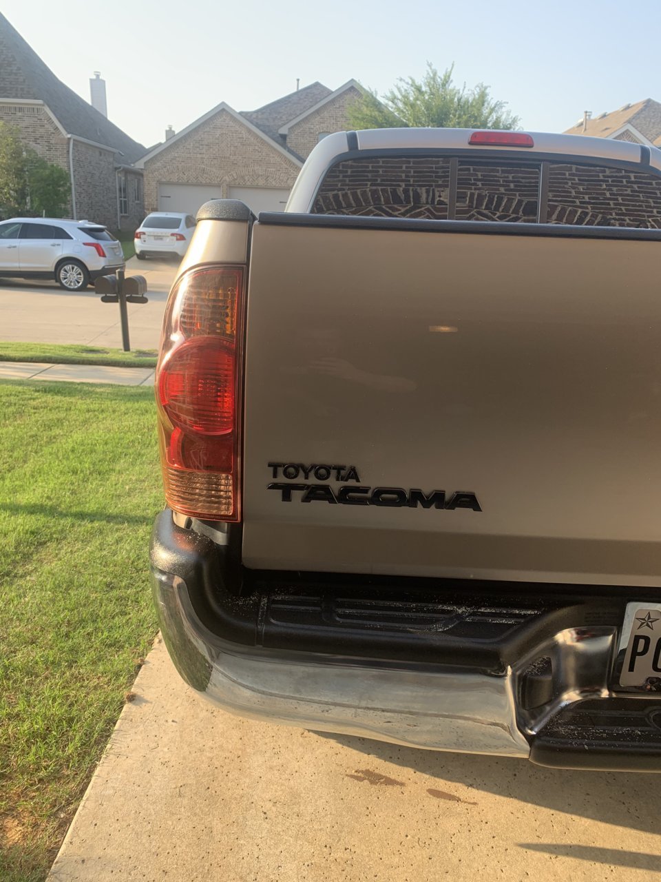

    I’m using a eraser wheel on them and fishing line and it’s coming off easy in the Texas heat. I really didn’t know the term for it. I have one badge that’s going to be different so that’s the one I’ll dig my da out and compounds this helps.

    I’m installing newer taco badges on her and they look a lot better

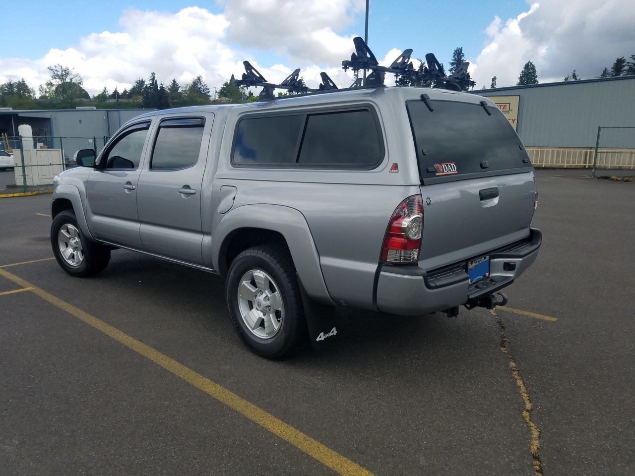

    Did the full rebadge last month... I used:
    1) fishing line
    2) low heat gun, my finger, and a rubber glove (kinky, I know)
    3) goo gone (worked a bit)
    4) Mcguires Ultimate Compound (this worked great!) https://www.meguiars.com/automotive/products/meguiars-ultimate-compound-g17216-152-oz-liquid
    5) Mcguires wax
    The ultimate compound is the shit...
    ETA: I pulled the badges off a 2014, 7 year old pickup, the blend is perfect, can't tell where the badges were located. I have a set of black badges but I like the look for now.
