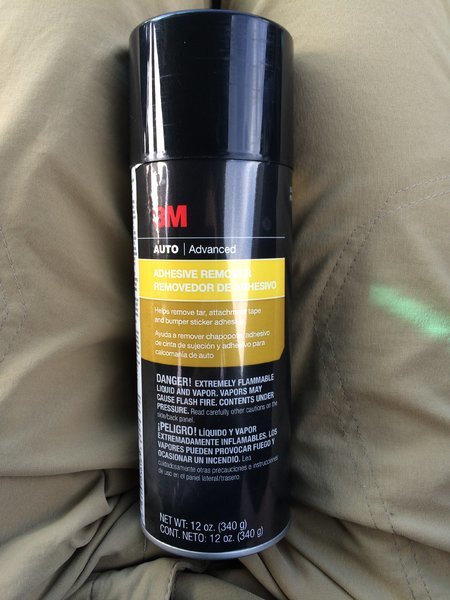

    Can someone tell me if this stuff is clear coat safe?

    I would be wary of directly spraying onto your paint.
    Soaking onto a rag and then area of the body makes it less abrasive.
    And if your debagding your truck, using some fishing line will "cut" behind the badges that have the same 3M taping holding them on the body. After that use the rag and place it right on top of the sticker left over. Once it soaks in use a plastic scraper and it should slowly come up.

    We skipped the 3M remover and went with the roll-with-your-thumb method. Then we used Meguiars ScratchX to clean up the area. Worked like a charm.
