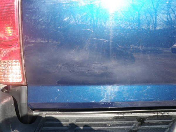

    So I debadged my taco. It looks great...from a distance...without any sun on it lol. I don't know if I did something wrong but you can still see the outline of the letters and I don't want to put anymore elbow grease into it because as you can see it already looks like I managed to scuff up the paint. Any ideas on what I can do?

    did u use anything like goo gone? that worked for me. also, where in westchester are you?

    I had the same issues...go down and get some Maguiars Paint Cleaner and buff the area really well and then wax the hell outta it! A powered buffered would be ideal rather than doing it by hand
    The outline will go away and look good as new :cool:

    yeah i used goof off. I know a lot of people have used the goo gone and I haven't seen anyone have this problem. It looks like the goof off messed up the paint and i dont wanna make it any worse. I'm in Pound Ridge. Good to see another TW member in the area. You know any good places to take the taco off road around here?

    great I'll have to pick some up. Thanks for the advice.

    I just used "Goo Off" thinking it was "Goo Gone" on a plastic roof rack wind fairing to get some sticker adhesive off. Took the glue, and half the wind fairing with it. Just about melted a hole right through the plastic. I hope it did not hurt your paint to bad. :eek:

    damn that sucks, i think goof off must be more concentrated than goo gone or something...yeah i'm hoping that too...i was gonna debadge my doors but after seeing what it did to my tailgate i'm holdin off for now.

    Just as an FYI...WD-40, with a little more elbow grease, will take off any badge residue and will not hurt paint or plastic.
