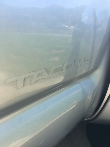

    Hello everyone,
    I just picked up a 2007 tacoma access cab prerunner and I'm debadging the doors right now. I took off the passenger side emblem and now there's the imprint left by the badge. I've been at it for 20 minutes now and it's not getting any lighter/ better. Help please!

    Use Goo Gone or rubbing alcohol and a microfiber cloth.
    With a 10 year old truck you might see some ghosting, but that looks to me like residual adhesive.

    If GG hasn't worked then I think you're up shits creek, but see.
    Is the surface completely smooth or do you feel those grey areas?

    I can feel the grey areas

    That's what I figure.
    You might need to let the Goo Gone or whatever you use sit for a minute or two, and you might need to rub the shit out of it with a microfiber since the adhesive is old and hardened, but it should come off.

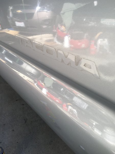

    It's gotten a little better, I let the alcohol sit on it for about a minute then went at it again

    soak it in wd40 for a few minutes then use your microfiber so it 'grabs' the adhesive. use your alcohol to clean off the wd40 once done.

    try some paint thinner on a microfiber rag...

    Just did this and still the same :/

    Don't use paint thinner, Jesus no, just
    You just have to polish it out. It's pretty common for that to happen.

    Ghost Tacoma? I might just leave it, the wd40 and rubbing alcohol hasn't worked and I don't want to use paint thinner
