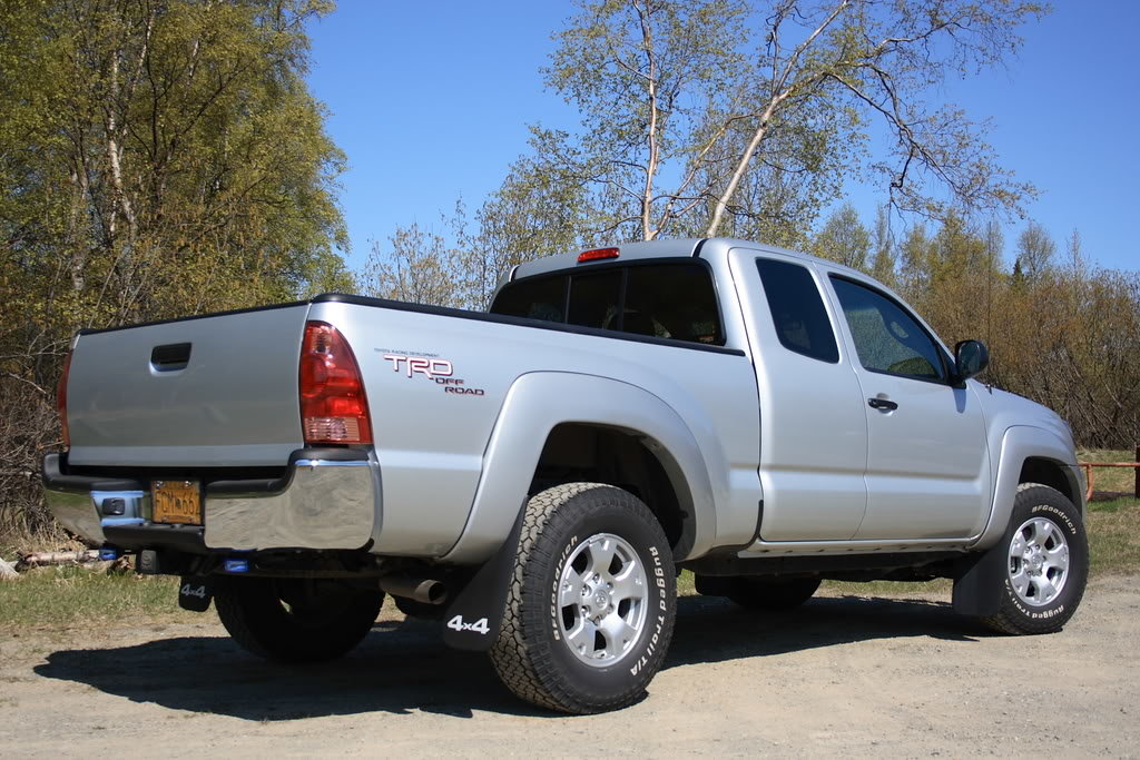

    This thread is weak on pictures:
    All badges are off, the TRD sticker is still on, and staying on. The badges came off very easy with a heat gun, goo gone and a re-application of the wax.
