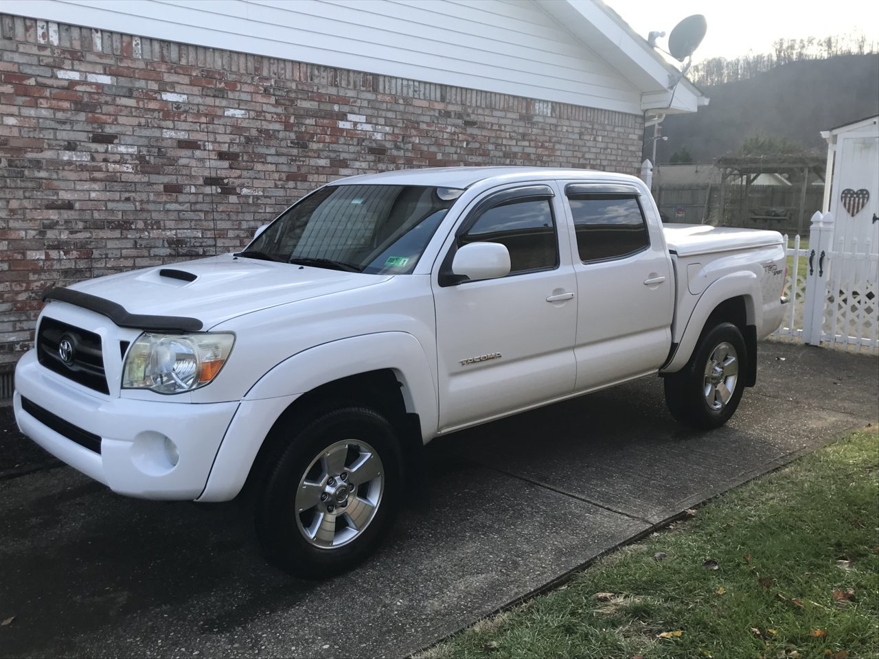

    OK guys, I think I'm going to debadge the 06 DCSB I just bought. It's super white and has been garage kept since new and is very clean. I don't think I should have any issues with ghosting but thought I'd get your thoughts and tips on cleaning it up if I do. Here's a pic of the truck now just for reference.
