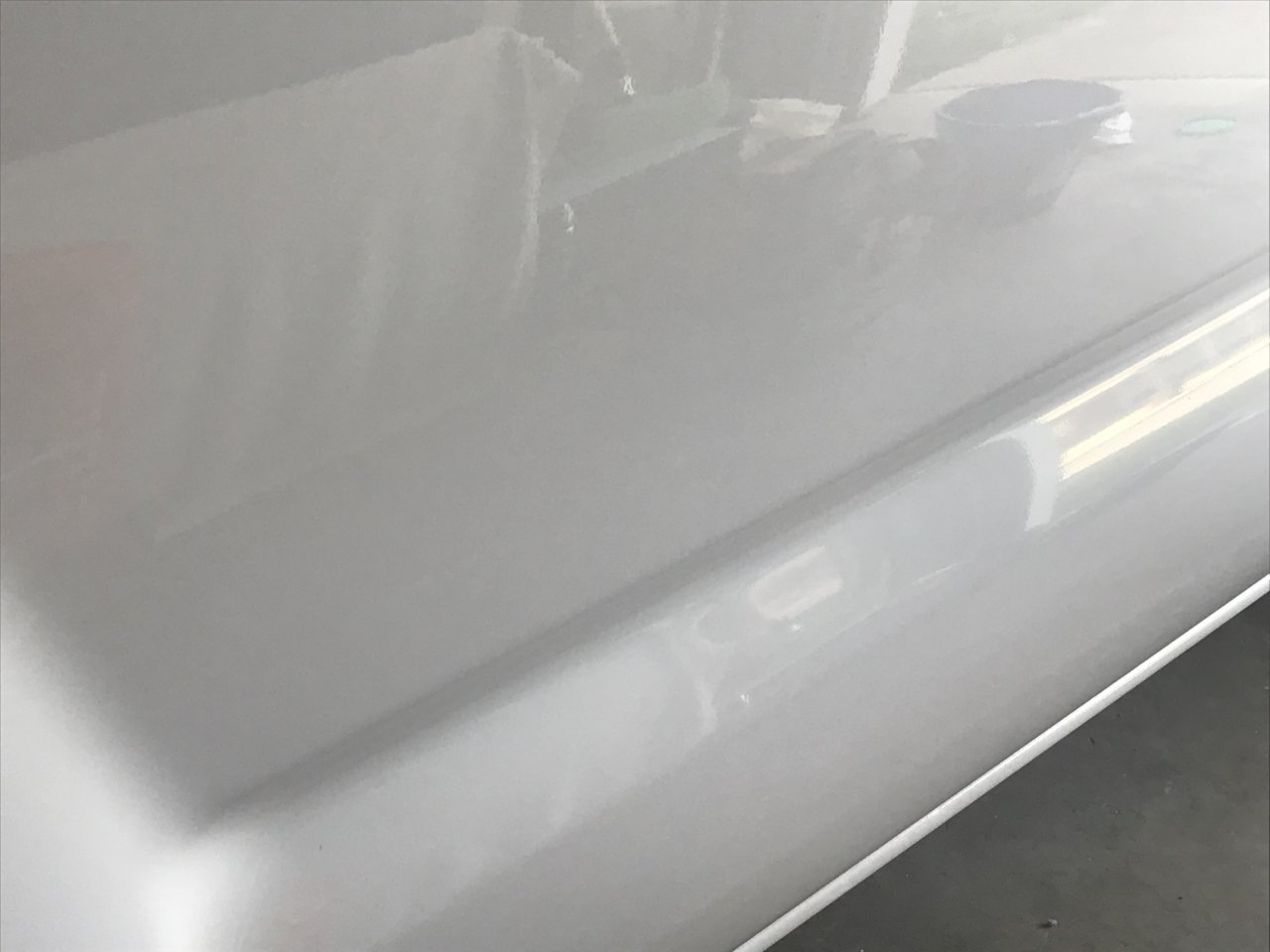

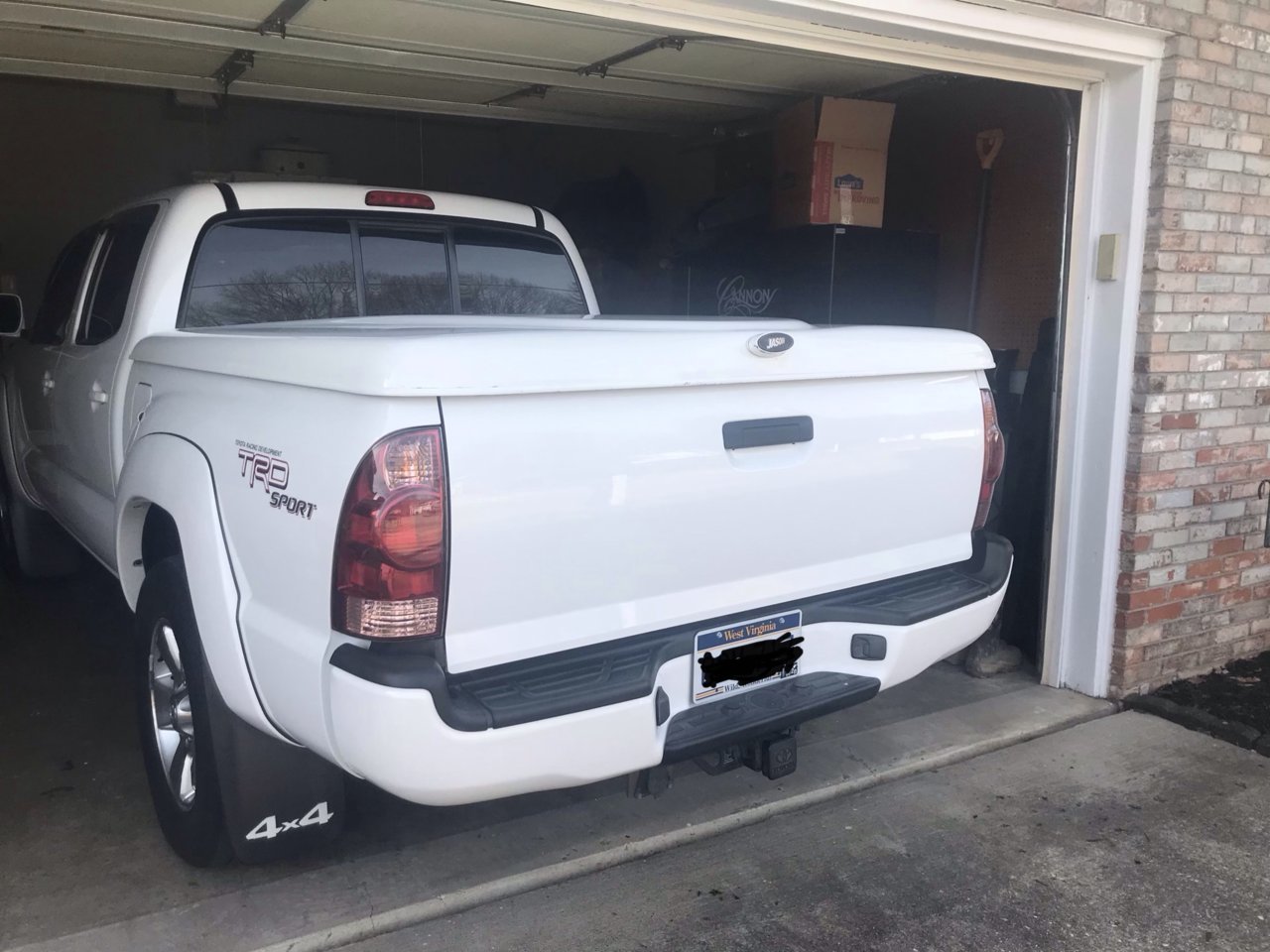

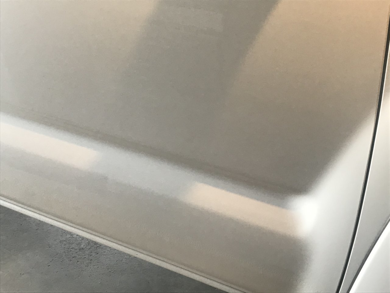

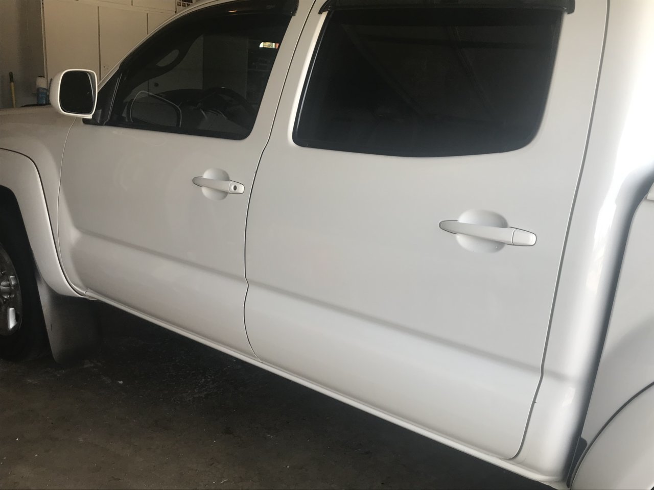

    Well... it got up to 60 today so I washed the truck... used 60ld braided fishin line and popped the badges off... then used goo gone and a credit card to get the adhesive off... a little rubbing compound, polishing compound and topped it off with some wax... no ghosting that I could tell.. took about an hour and a half...
