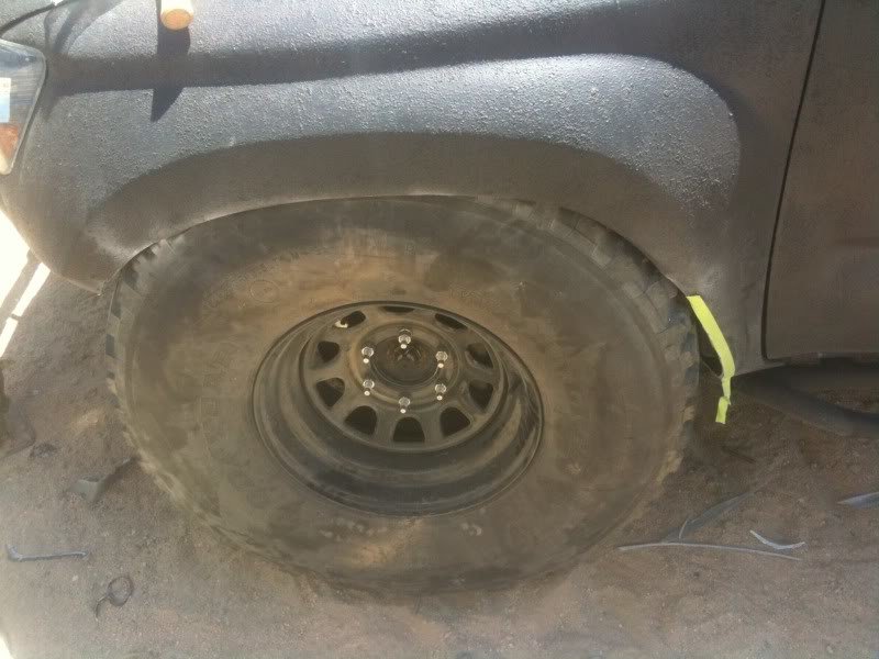

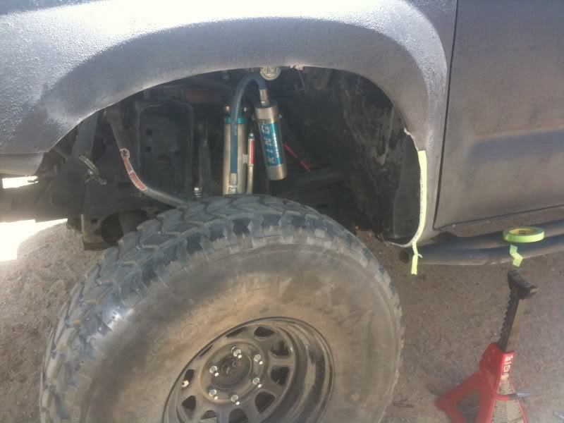

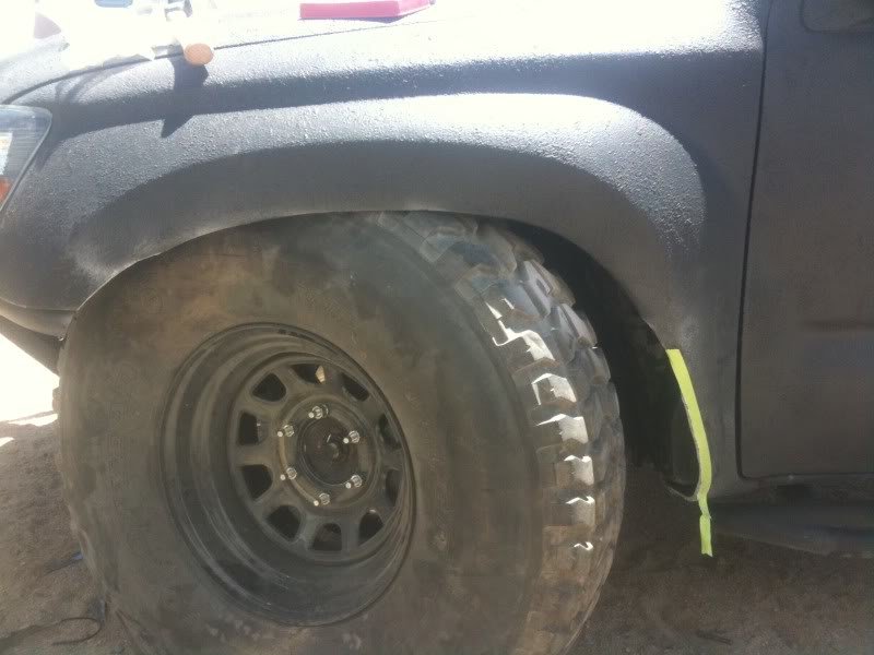

    Read his build he has a lot more then glass he was showing pictures of the trimming cutting and bfg modifications and the best way to so it.. Almost positive the Torres there are a lot bigger then 285 :p

    Those pics are crazy?! You'll have to do a CMC for sure, and a $hit ton of cutting and crap to get a 285 70 17 to fit non lifted.

    It's going to happen and I will keep everyone updated just a matter of time or getting my tires sold to pay for new ones.. Pretty sure his pictures are 37" h1 setup though a lot bigger then what I will have as I said though I could be wrong about his pictures cause he did run 33"s for awhile
