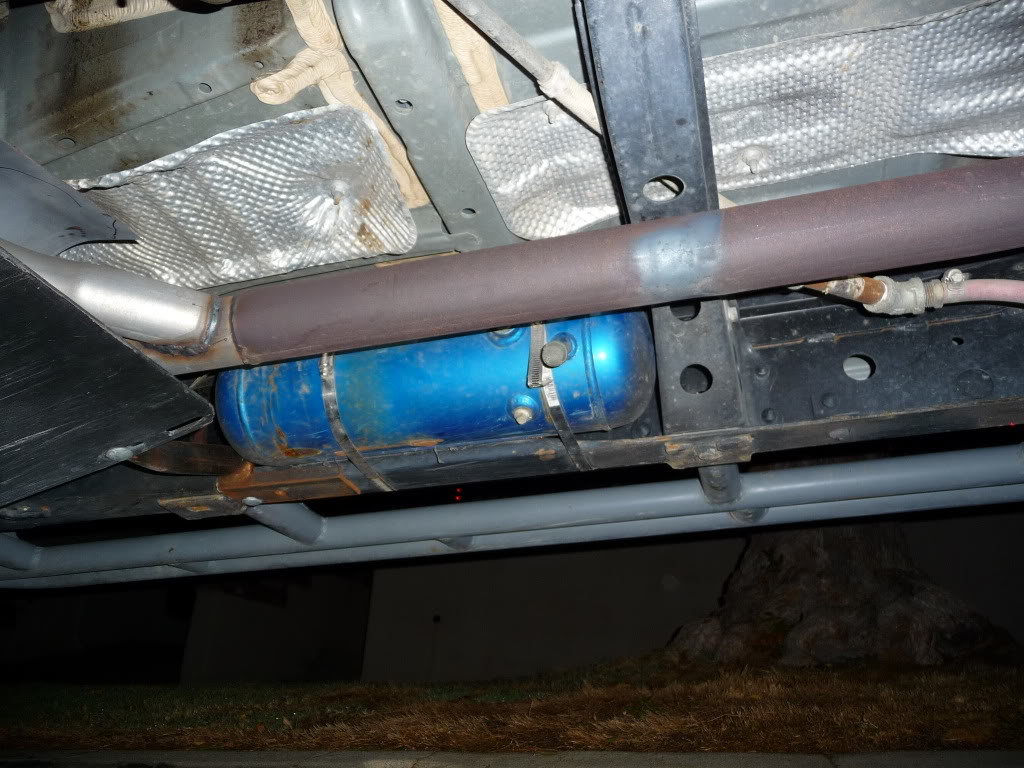

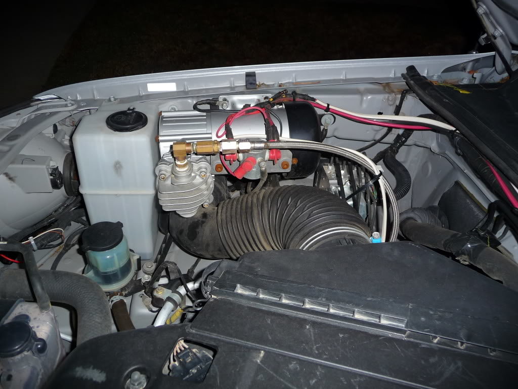

    Here is a link to what I have been using for 4 years now, Well Kind of. I pulled it apart and mounted the compressor under the hood and the tank under the truck along with some hose and a different pressure switch. It kicks ass! 3.0 cfm at 90 psi. or you can just leave it all together and carry it in the bed but it is kind of big.

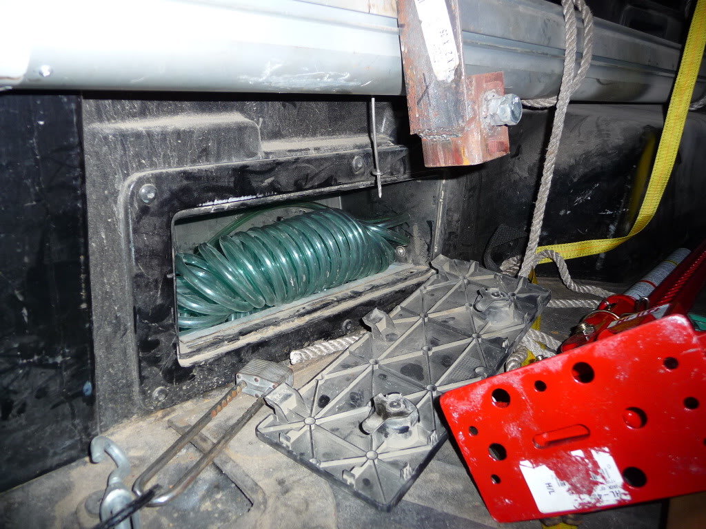

    Here is a pic of the compressor mounted the tank and where the hose is stored. If you want air and don't want to stand around for an hour re inflating this is a good option.
