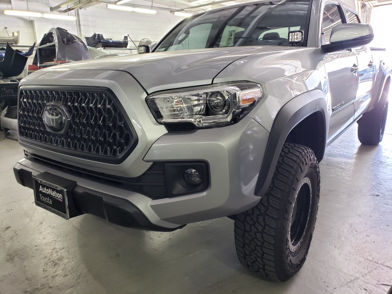

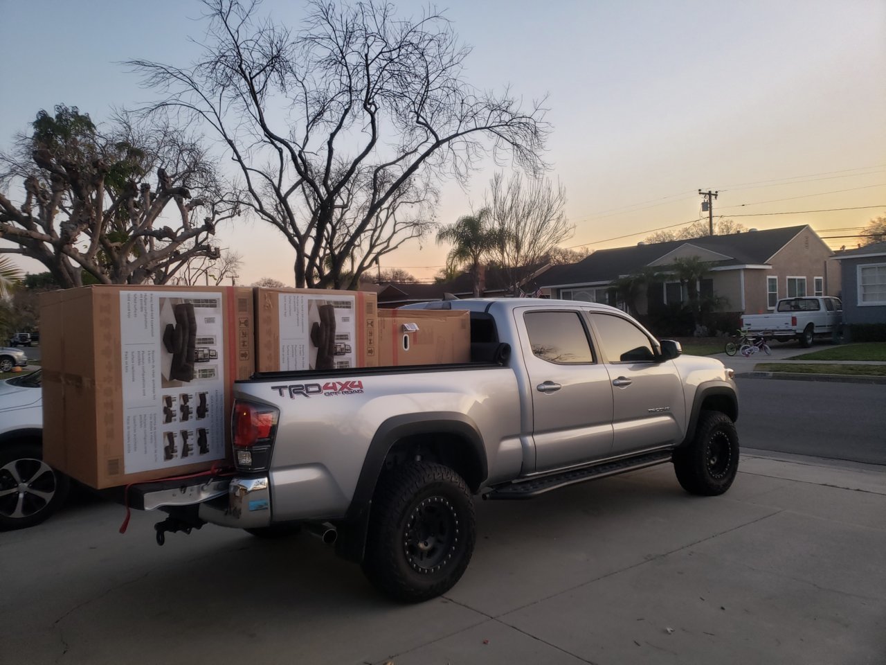

    What did you use to lift the rear ? Any pics !
  10. Jan 15, 2020 at 7:42 AM
    Superdave1.0
    Superdave1.0 Grandma Dave
    Dec 27, 2018
    #277158
    6,220
    SoCal
    LX470, 2025 Civic Si
    Dakar medium leaf springs. ($450). I had a block spacer b4 and it sucked. The truck felt unstable in the turns. Dakar are much better than stock.
    swoly and Emannn24[QUOTED][OP] like this.
