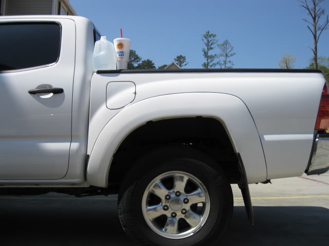

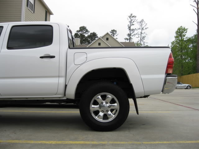

    Get it done! It will settle. You WILL be happy!
    before:
    After:
    before:
    after:

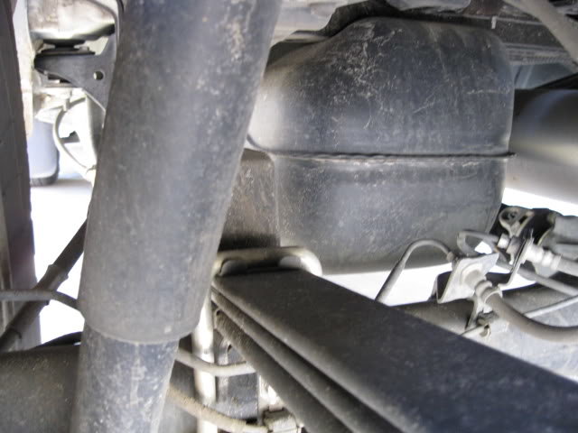

    this is the TSB and 5100s set at .85.
    the tsb rasied my back 1.5 inches, but about a week later when i went to install the 5100s i remeasured the back and it was only 1 inch higher. so that why i set the front at .85.
    so basically the truck sits about a inch higher, the truck is slightly firmer, drives very well, and i have no problems with the 265/75R16 i installed afterwards.
    if they are offering to the tsb, DO IT. the new set up makes the truck firmer, better to carry loads, gives you a little lift. All this for free.
