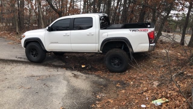

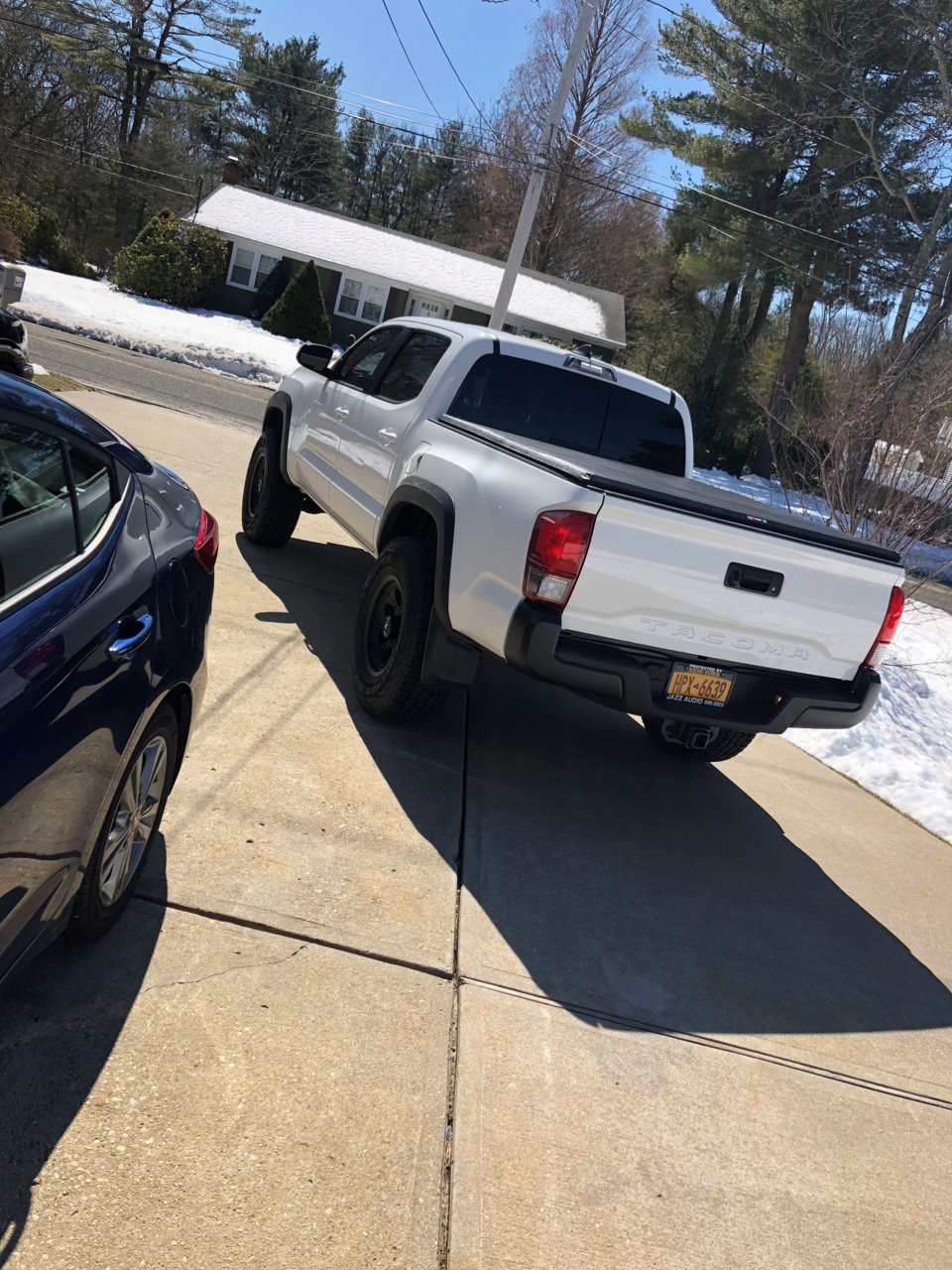

    285/75r17s (34s) on 8" wide -12 offset rim. 1" of lift all around. i should of went with 33s i wouldn't recommend going bigger then 33s unless your MT or going to re-gear the AT

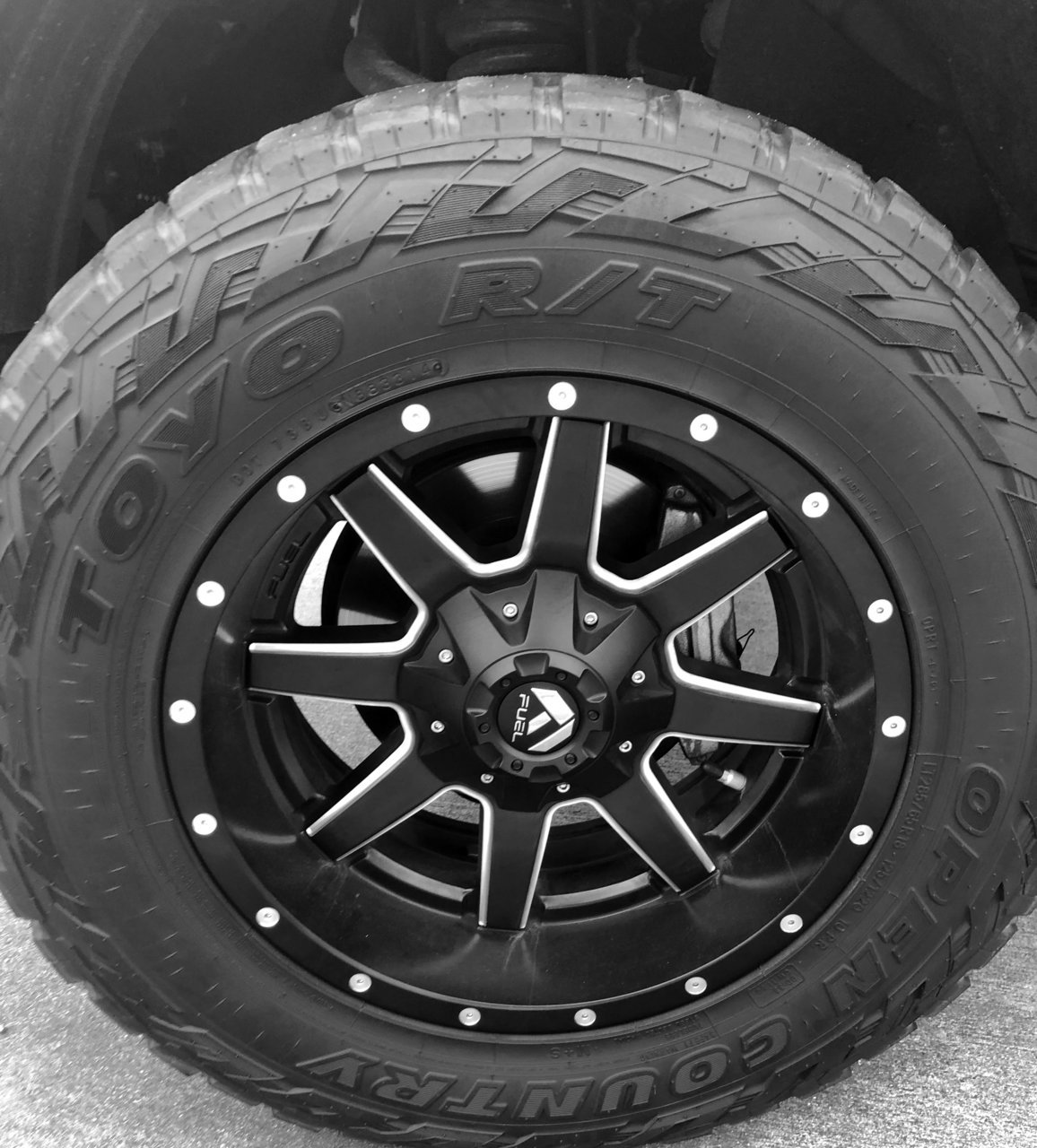

    this thread has been educational.
    These are the wheels and tires that were on my Tacoma when I got it.
    Would this be a good brand to stick with for the next set? Seem to get some vibrations at 50 mph but I heard that is normal.
