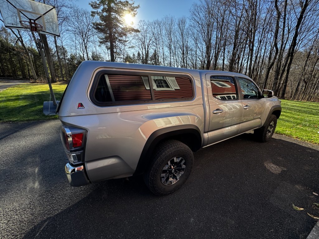

    I have a 23 TRD OR I’d like to remove the decals from the bed. I’ve seen some posts saying use a hair dryer and goo gone. Do I use the goo gone on top of the sticker before heating it? Or just heat it, peal it, and then goo gone the residue? Thanks.
    UPDATE Hairdryer and goo gone worked like a charm! Thanks all.

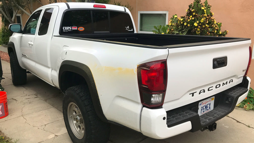

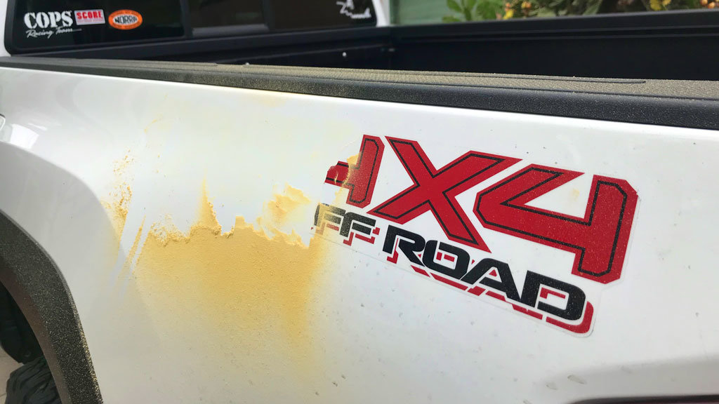

    I must be the exception and not the rule, as I did/used pretty much everything on the list above, and my OR bed sticker left a residue like no other. I've used GooGone a lot for sticker residue and it didn't even make that stuff flinch.
    I ended up using 3M sticker removal wheel chucked in a multi-speed drill.
    Now that worked.........It was all that worked too.

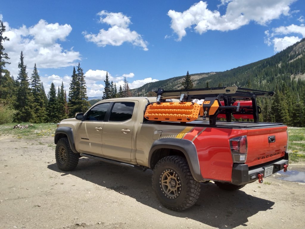

    If they are like me, they didn't remove them because they didn't like the look of stickers on the bed, they removed them to put on something different........
    Or in my case a whole new wrap on the a$$ end
