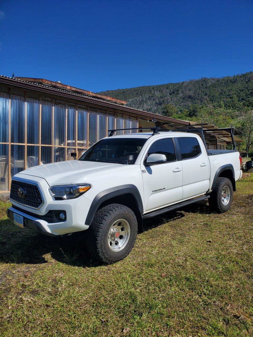

    1.5" Eibach springs, 1.5" Icon add a leaf, Bilstein 5100 shocks, 1" rear blocks.

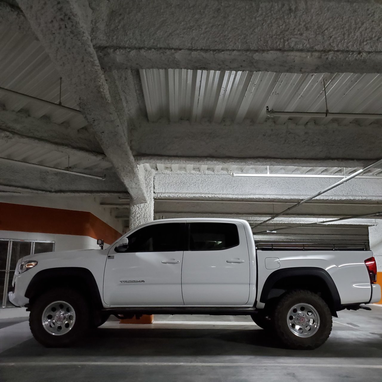

    5100s, eibachs, icon aal with 1" blocks. 265/75 16 ko2s. Hub to fender is 21.75" front and 23" back.

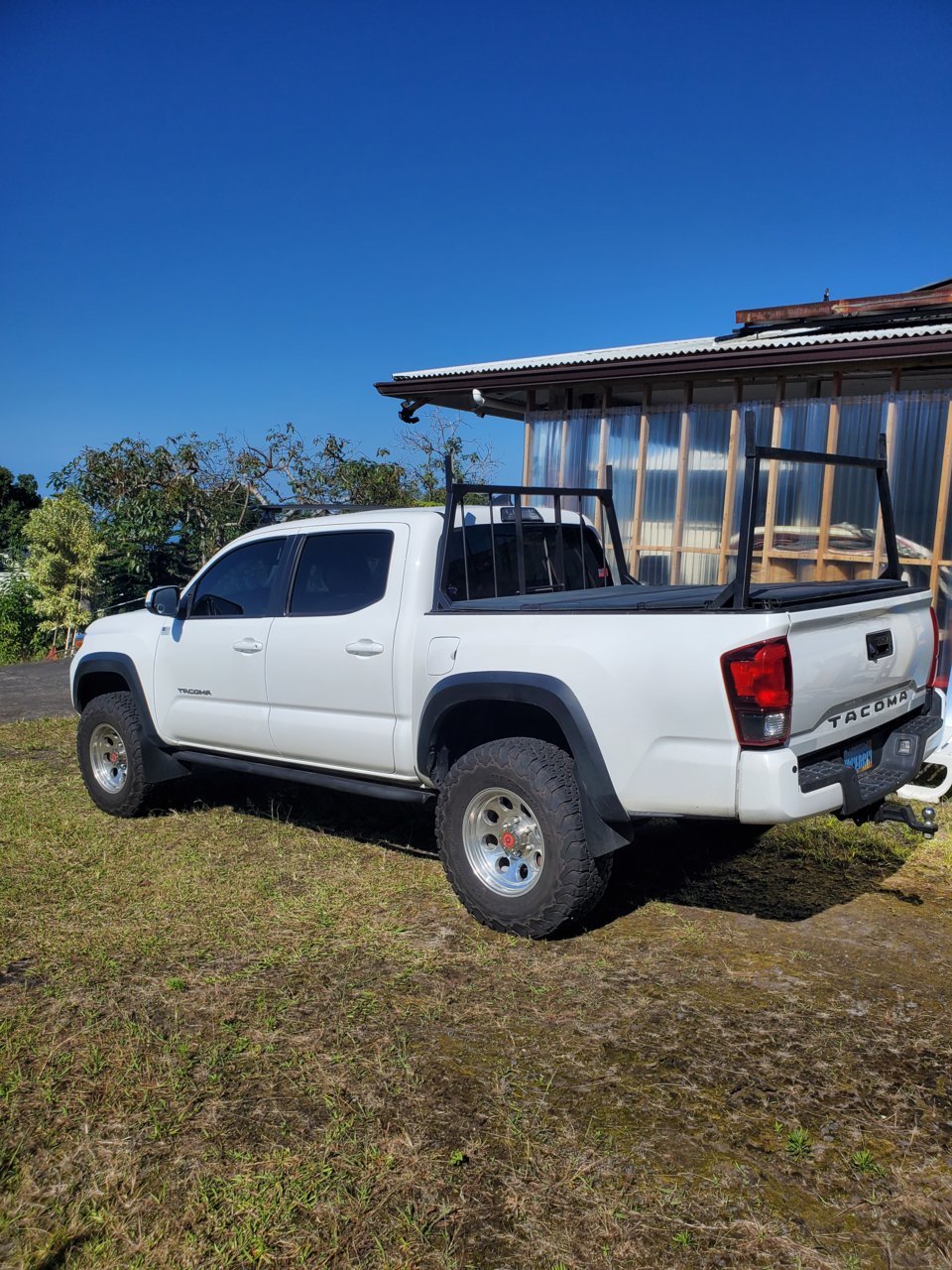

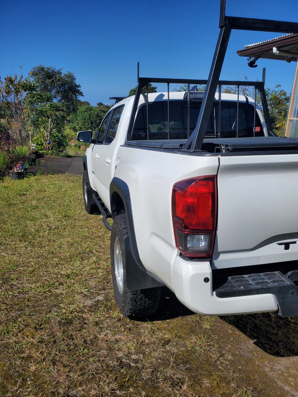

    What's the specs on your wheel setup? Looks nice man! Do you happen to have like a front or back shot showing the side? Want to see how much your wheels pop out. Looks like it has a nice stance!

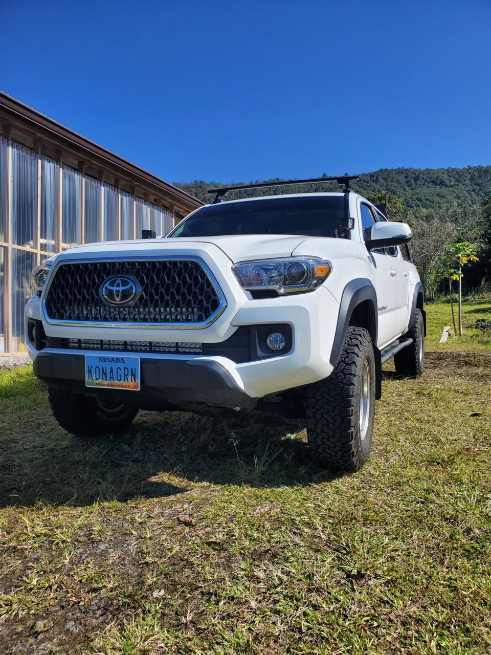

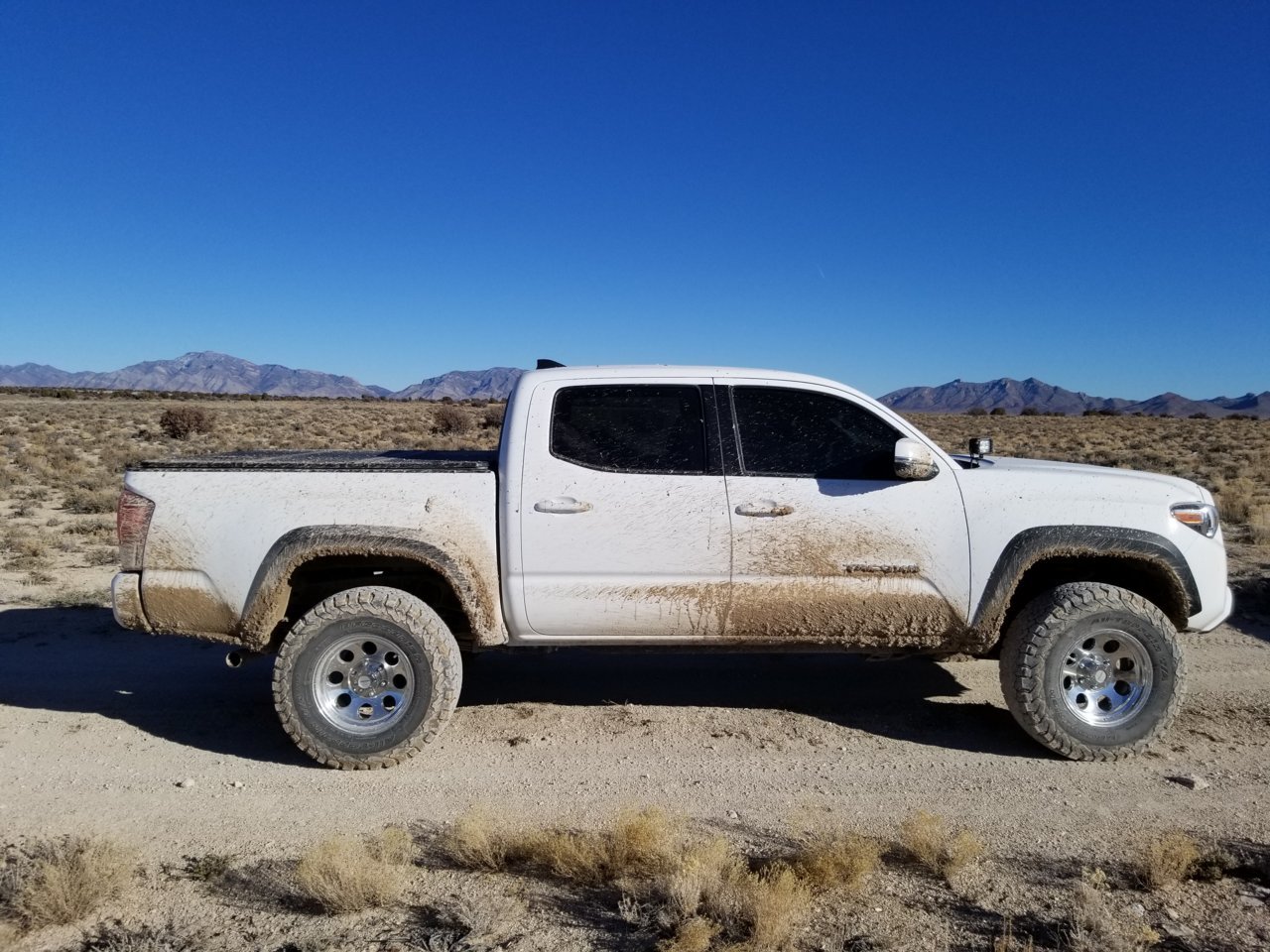

    Nice man that thing is nice! Do you have a negative offset or how are you getting that stance? I love it!

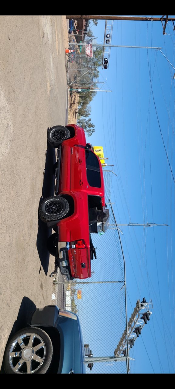

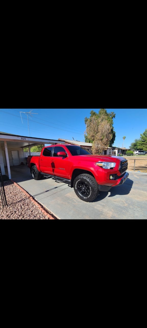

    This is mine here, it has a 2" level kit up front stock in the back. But planning on going with a 3" soon. And once the tires are done ima upgrade to 285/75/r16 I currently have 265.

    -12 offset. I had spydertrax 1.25" spacers but it rubbed more so I removed them.

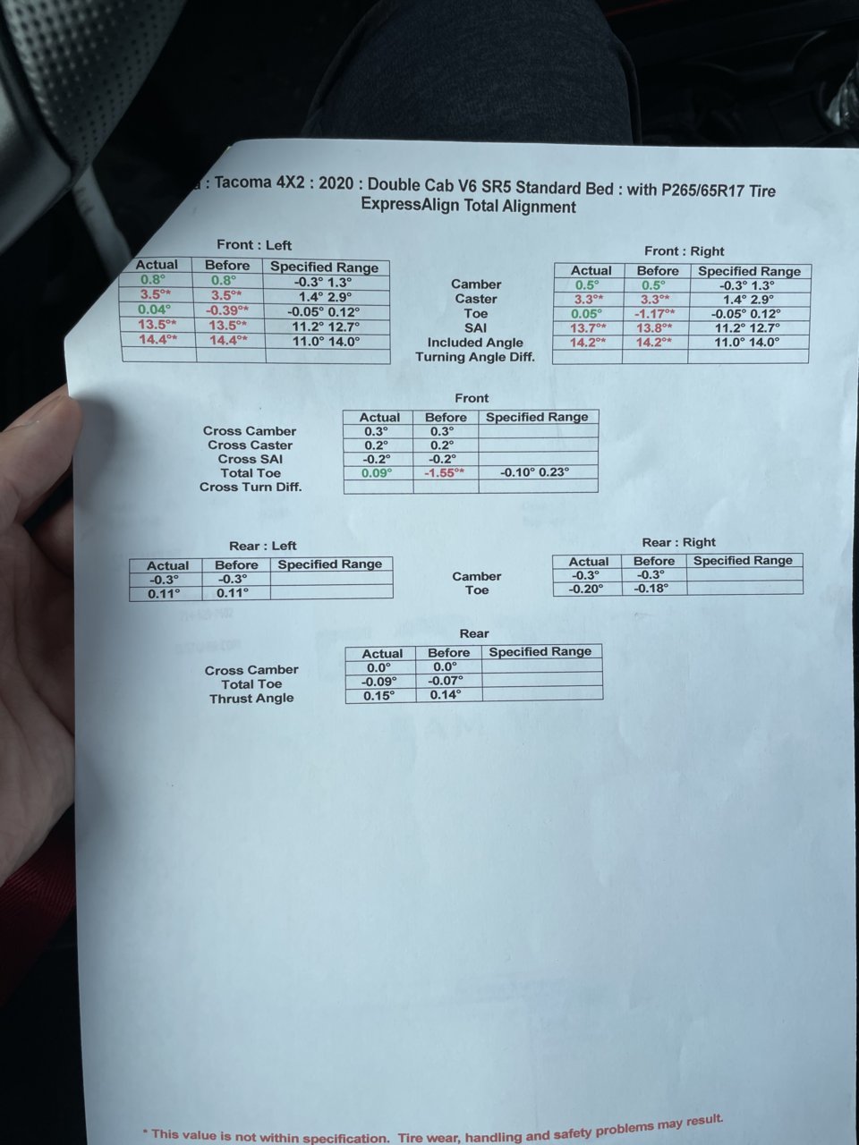

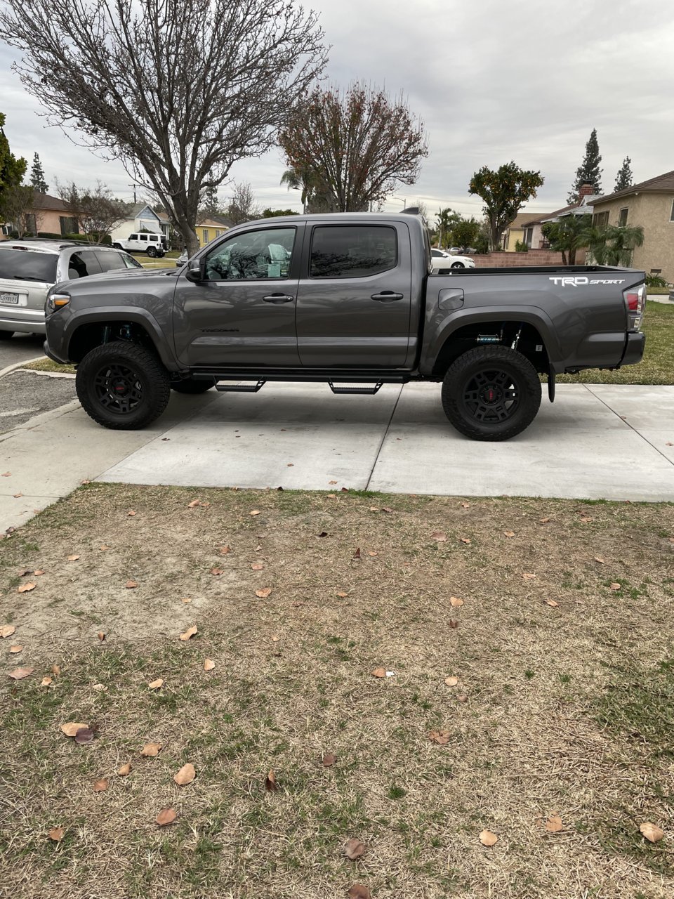

    How did you guys do with the alignment after the lift ? I have a 3inch lift on mine but can’t get it aligned just right.
    king 2.5 with Camburg uca
