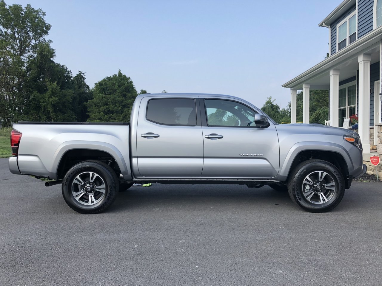

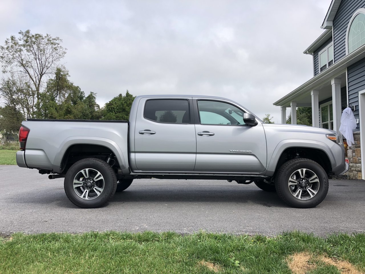

    Just put in the front Fox 2.0 coils and rear Fox 2.0 shocks with resevoirs and a Headstrong AAL last week. VERY happy with the ride and feel. Will be leveling it out on Monday - but here is a before and after. Stock vs everything installed (Note - still need to raise the front to level it - but gives you a good idea). I vote Fox

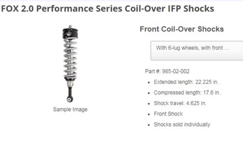

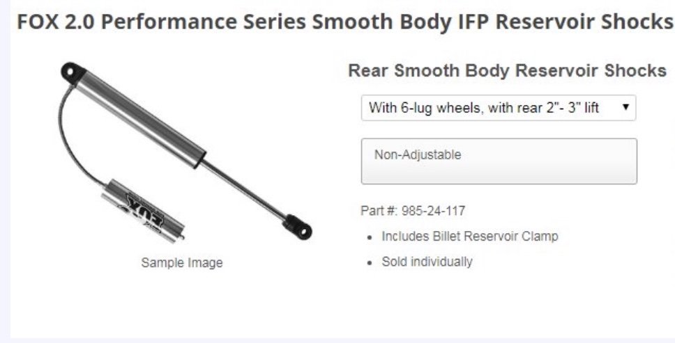

    I shopped around. ORW had a coupon code - Headstrong had great customer service - that’s why I used both.
    Here are the part #’s for the suspension I ordered (again - the front coils I should have adjusted up before putting on - but - love em). And - the AAL fRom Headstrong is on their site.

    Once I adjust them up a hair this coming week (when I get time) - I will net about 2” to 2 1/2” up front.

    I was prob around 1 1/2” out of the box. You can easily adjust them up before you put them on.
