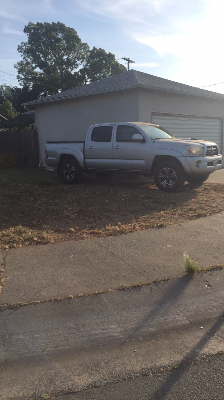

    Hey guys, I just bought an 07 double cab for a daily and hunting truck. It needs tires soon so I’m looking at Nitto Terra Grappler G2 in 265-70/r17. I’ve run nittos on my old truck that I’m selling and had good luck. So going from a full size truck to a taco I’m unsure how stiff a sidewall I need. I’m not doing anything hardcore, I’m trying to leave the truck pretty stock, thinking just tires and shocks. But the trails I have to go down are kinda rocky. So the nittos come in 265/70R17 115T And LT265/70R17 E 121/118S. The 115T, 121/118S is where I get confused. Could you guys make suggestions and explain why? Thanks
    Edit: tires on it now, assuming stock, are p265-65/r17
