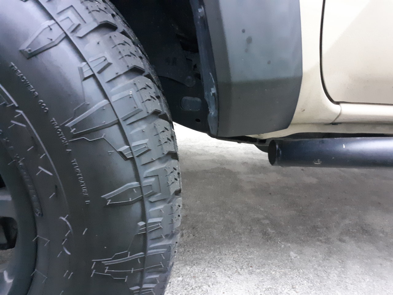

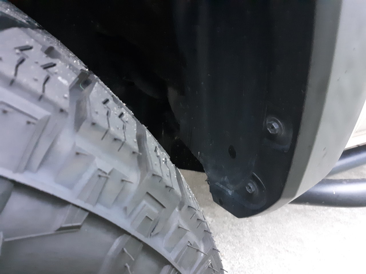

    0F16F05A-DC93-48BF-99FC-D83FE41157EC.jpg 4BB16F37-A1EA-40EF-B0D1-3AEA7007EB01.jpg I have a 2020 trd pro and immediately switched factory tires for Nitto Ridge grapplers 285/75/16 on stock wheels. I had some rubbing on the back of the wheel well. I had brand new mud flaps and their attachment point is where it was rubbing. I really don’t want to to the cab mount mod on a brand new truck and didn’t really want to take off the mud flaps either (it might have rubbed even with them off). I had my tire guy use a heat gun on the mud flaps and then it only rubbed slightly at about 3/4 lock on uneven ground. No rubbing at all on the control arm. I then got a 2 1/2 in lift (tuff country) because I thought it would look good and fix the rubbing too. The lift actually made the rubbing worse! It does look good though IMO. SO now I’m just living with the rub.

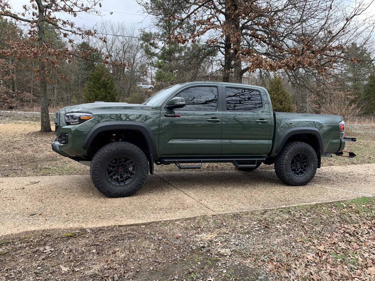

    After the lift

    It doesn't rub even with the mud flaps on during city driving. I took those off and went wheeling and it rub slightly. I used the heat gun for now and will do some more off roading and check if it still rubs before I start cutting.
