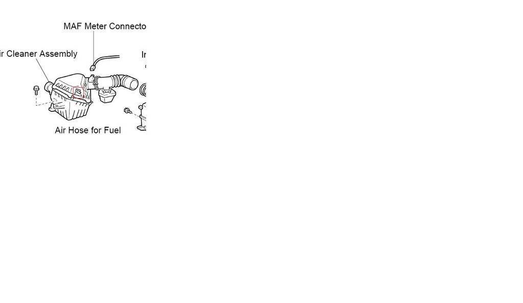

    i dont exactly understand that chris... i see the silencer i think and i really want it louder but i dont get how if it comes undone it would suck in unfiltered air

    ok its that little tube that is right behind the box

    yeah......i think there are maybe 2 tunes coming off the main tube.....just take them out and tape up the hole thats left...then replace the silencers.

    NO. Its NOT a tube. In the link that I posted. Look at the air intake assembly. On the bottom of the intake tube (the big tube comming from the air box) you will see a smaller one, about 2" or so in diameter, going straight down, into a plastic object. Thats the one.

    I GET IT NOW!!! thanks... um whats that tube that is right behind the filter....

    this one

    i'm pretty sure thats where one of the vacuum hoses attaches..nothing that needs to be messed with
