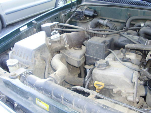

  14. Aug 31, 2009 at 3:29 PM
    #74
    tacoman101
    tacoman101 Well-Known Member
    Jul 11, 2009
    #19550
    1,074
    scott
    vermont
    2001 Tacoma sr5 xtra cab 4wd
    blue led headlights, 285/75/16 grabber AT2's, custom pedals, custom shifter, flowmaster 40 series muffler, bedlinered fender flares, 2.5" lift kit via shackles and spacers, custom exhaust out the back, chrome exhaust tip, and Herculined bed, Weathertech floormats, Cabelas Trail Gear Camo Seat Covers ... Nice thing was I got the truck for $4000
    just double checking, is this the silencer:
    here is a far away:
    and a close up: its the little box in the center of the pic
  15. Aug 31, 2009 at 3:31 PM
    #75
    tacomaman06
    tacomaman06 Carolina Alliance: Enforcer
    May 1, 2007
    #1475
    26,212
    Will
    York,South Carolina
    '16 Tundra TRD Pro
    getting there....
    that would be it.
