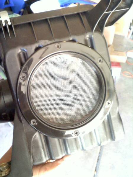

    My deck plate MOD, let me know if you have any questions. Not too hard actually.

    Looks good. Slowly getting the material to do mine. How did you attach the screen?

    At Home Depot I just purchased a roll of screen like you would use for either a screen door or window. Cut it into about a 5x5 square then after cutting out the hole in the air box place the screen over the hole. Then insert the deck plate, and while keeping pressure on the plate screw in the screws. This will tighten the screen as you screw it on. Then get a razor knife after its screwed on and trim of the excess screen. Done!
