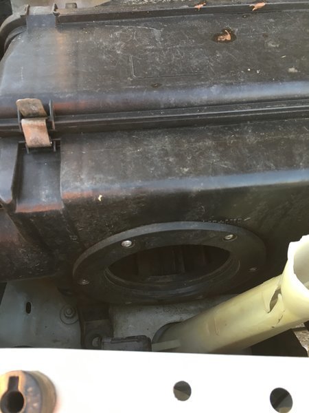

    RV or boat shops. Or online. Here a picture of mine i did a 6" deck plate and cut the front of the box. Sealed and with screen door mesh to keep pine needles and stuff out.

    I bought one on Amazon. I already had a 4.5" hole saw. it does make a little more noise when you get on it and that may stimulate the butt dyno but all in all I think at most like 2-3hp with everything else being in top shape.
    somewhere there was a post on this if you search, it had dyno results

    I did it on my 99 and I did notice it was more responsive . I don't have any numbers because I never had it dino tested. But if I had to guess I would say 2 maybe 3 HP.

    It's uncovered in the beginning, you'll cover it up when you realize that you get
    No real HP increase
    And as long as you stay out of the mud it won't get any dirtier. If you play in the mud it will get dirtier than pulling air from inside the fender.
    If you have a 5hp gokart that is at full throttle all the time and add 1 hp to it, you'll notice it. If you have a 100hp and you add 1 hp that you only see at full throttle, it's a completely negligible increase. When a main focus of a mod is that it's 'completely reversible', it's probably a worthless mod.
    MOST bolt on mods fall into the worthless category. You'll spend a bajillion dollars to get 5 hp that you almost never see.
