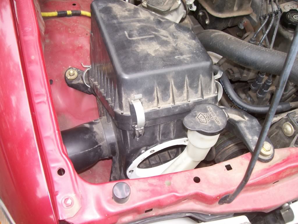

    well heres a picture of my intake box. I really want to clear the windshield washer valve but i dont think one will fit.

    It will fit just fine. Remove the intake box, and put the deck plate right in front. THe windshield washer fluid filler will be in the front, but its not a deal. It will still flow fine. Use a 4", and get some sensor safe sealant. :)

    heres u a pic homer, same air box.
