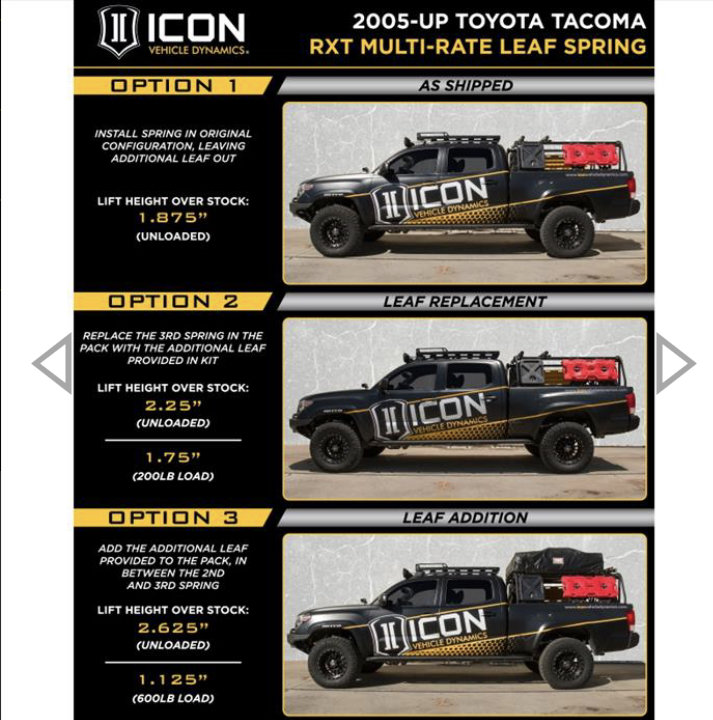

    I have a decked drawer system on order and am working through some ideas.
    I currently have Bilstein 5160 rear shocks and a 3 leaf AAL.
    For those who have Decked, what did you do for rear leaf springs?
    I am wondering if the OME AAL might work, or if I should go full leaf pack.
    My load will be basic tools and recovery gear as of now, so maybe 50-70 lbs of additional weight on top of the Decked which is 205.
    What ideas do y'all have for rear set up?

    I’m happy with the Icon RXT pack so far. Decked, shell, rack, and tent on the stage 3. It’s an easy install and seems a great value.

    Icon RXT Option 3! /close thread
    (well, maybe option 2. It’s a tweener).

    I can't find them with options... I'm assuming the options are weight ratings...

    RXTs come with an extra leaf not installed. As they come is stage 1, replacing one of the leafs is stage 2, and adding the extra leaf into the pack is stage 3.
    I have mine at stage 2 and they have been great.

    I see now, thanks.
    Option 3 seems like the best route.
    I assume this pack would function okay with Bilstein 5160 rear shocks?

    You would be between 2 and 3. I have a relatively empty bed with a diamondback cover and a little extra weight would be perfect for me. I’m using 5100s right now so 5160s will be fine.
