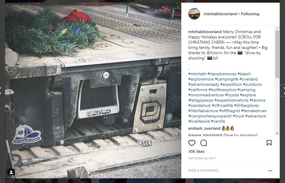

    I'm into the final ordering of parts for my adventure build and I'd VERY much like to add a decked system to it for the storage as well as making a much larger flat floor which, to me would be much more useful. Since I'm mounting a GoFastCamper to the bed I'm planning on adding bed stiffeners to keep everything square and solid on and off road.
    Can anyone tell me if the Decked system for Tacoma's will for sure work with Bed Stiffeners in particular the Rago Fabrication ones I already purchased.
    If not can someone give me the exact measurement of the drawer from the truck to the drawer (not sure if I'm explaining it right) but basically to make sure that the opening and closing of a drawer won't interfere with this stiffener and vise versa. Thank you TW.

    The DECKED system doesn't extend that far back.
    But check with @MTNHABITOVERLAND ... he haz dem in his awesome truck
  4. Mar 9, 2018 at 9:28 AM
    aaronarakaki
    aaronarakaki Well-Known Member
    Jul 25, 2016
    #192913
    196
    2020 off-road 4x4
    They have bed stiffeners on in that pic.

    Post #92 I provided an overhead pic of the area in question. Plenty of room and yes, I have TC bed stiffeners in place as well. Hope this helps! Let me know if you have any questions!

    Yes it will all work together. I just installed mine a few weeks ago (had stiffeners installed already). The decked system does not reach that far back.

    Ok, so looking at those pics as best as i can on my iPhone screen it looks like no issues what so ever with a decked system as far as the drawers pulling out. They same well inside of the brackets so there is no clearance issues.
