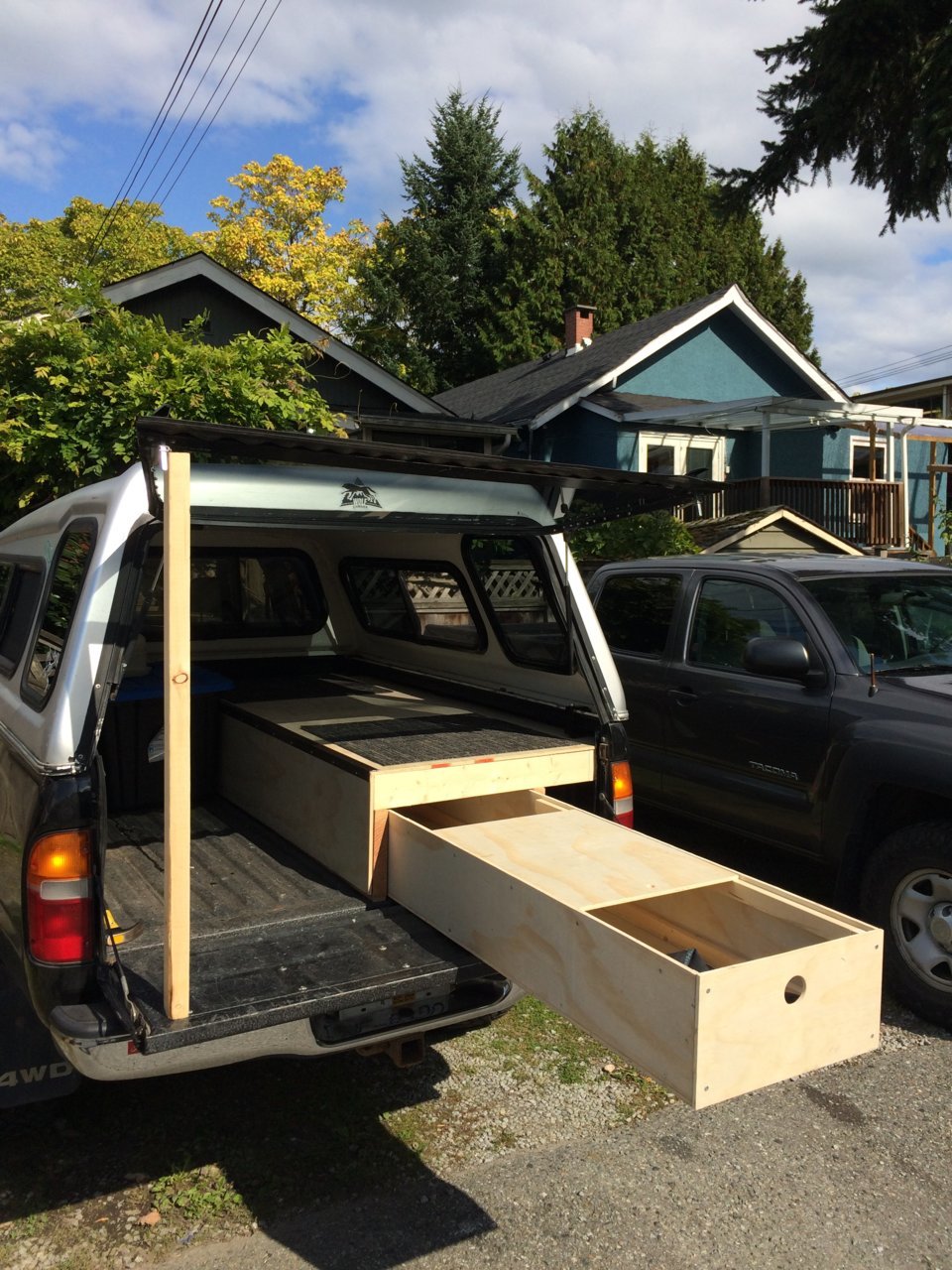

    There is a few on Youtube I'm considering.
    I currently have this set up without drawers. I've seen the drawers on either side and it seems like it'll work just fine but I'm thinking a drawer system where its set up like "Decked" being that it goes across the entire width of the bed. I'm only in there to sleep.

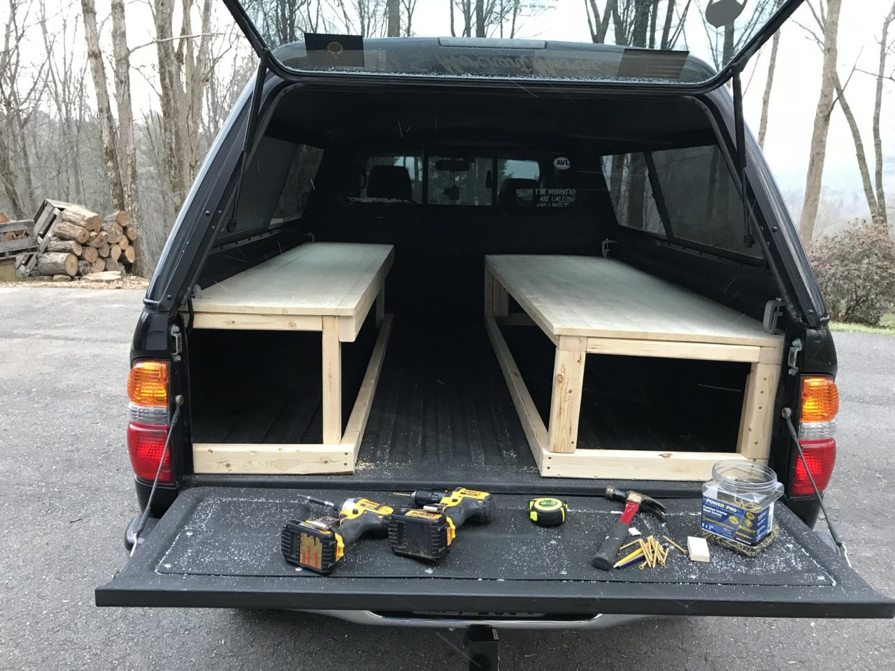

    Similar to @QMEDJoe , I also ended up building my own drawer system. Though I'm liking his the more I look at it!
    First time I've ever built anything like this. I opted to only do one side to keep the rest as flexible space (totes, snowboards, etc.). Worked great for camping - though definitely some lessons learned while making this. Thing weighs a ton!
    If you have access to some basic power tools, save your money and build one that meets your exact needs. There's a huge sense of accomplishment and satisfaction when you bring your ideas/designs into reality :)

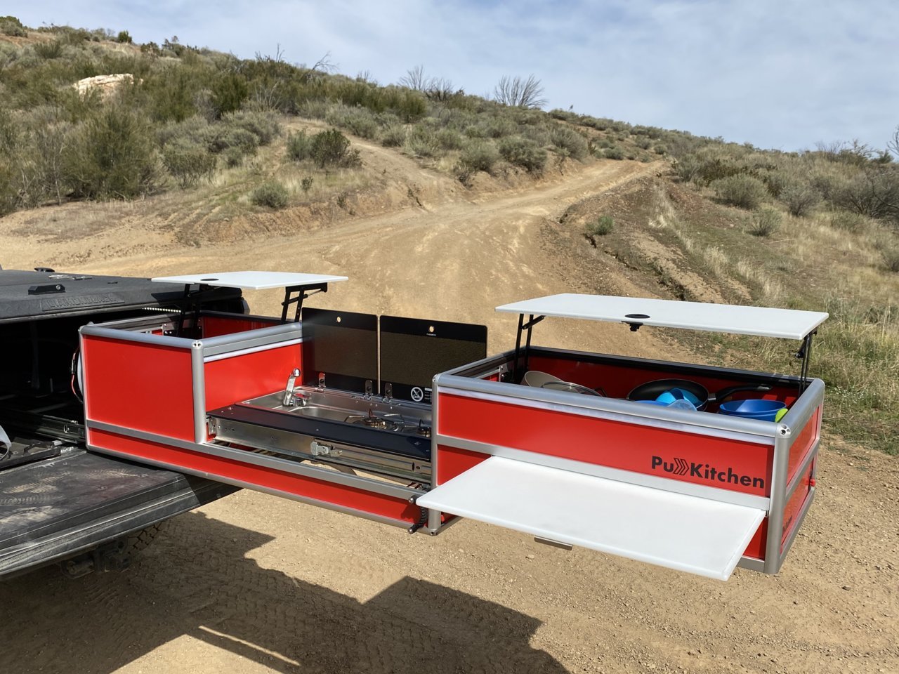

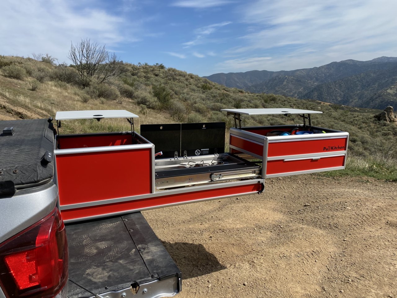

    Thanks Matt. The kitchen design is L 58.75” x W 21.5” x H 18.75”
    I wanted to combine a solution that had self-contained water, power, pantry, sink, burners, and storage. Plus once the mounts are installed it takes 3 minutes to remove to get your truck bed back. Fits most trucks depending on bed height.
    Good luck with the build!
