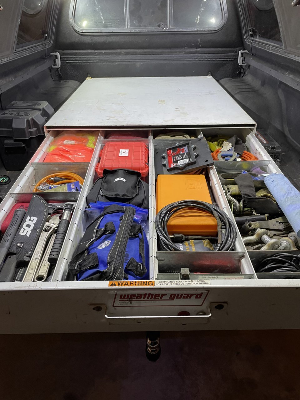

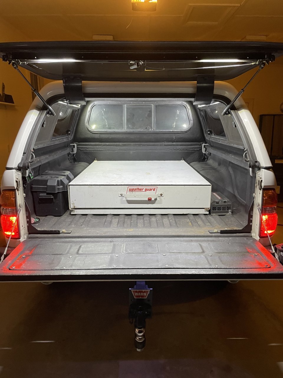

    This is the packrat system that I'm running. Found it on craigslist for $300.00, but I think it also weighs close to 300lbs empty. I have thought about switching to a decked system like you're wanting as well. Took me a long time to get my ride height where I wanted it, so I'm leaving it alone. This could easily be covered, and act like a sub-floor, but I'm getting lazy.
    The drawer is very easy to open and close, but I guess it depends on what you want. I’m the type of person that “sometimes” money doesn’t mean a damn thing to me. If it’s what I want, I’m getting it. If they made the decked kit for the first gen’s, that’s what I would have.

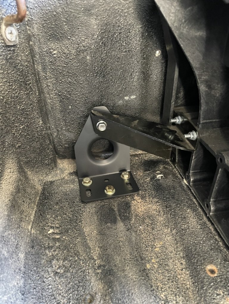

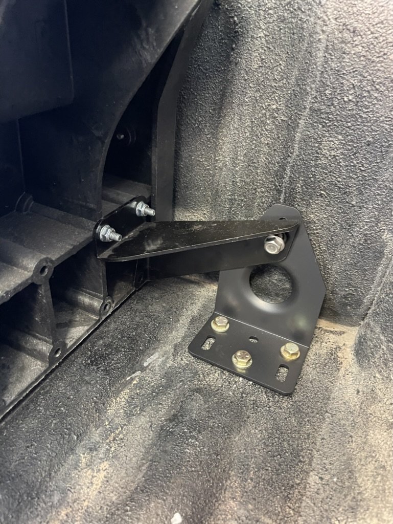

    The Mid size Long bed fits. I made some brackets to bolt to the floor to mount the front and the rear attaches to the stock tie down hooks.
    PM if you want a set of brackets.
