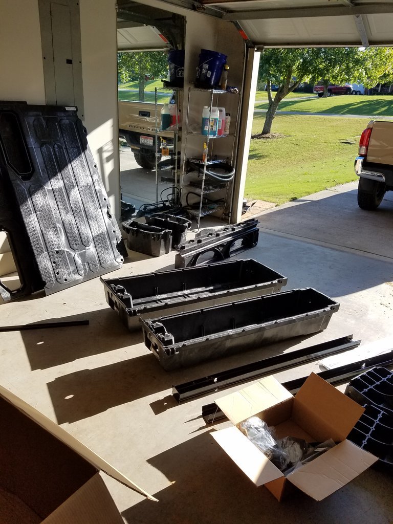

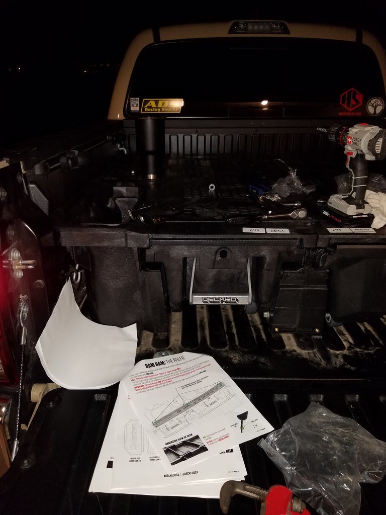

    This was the beautiful sight after I got the pieces all laid out.

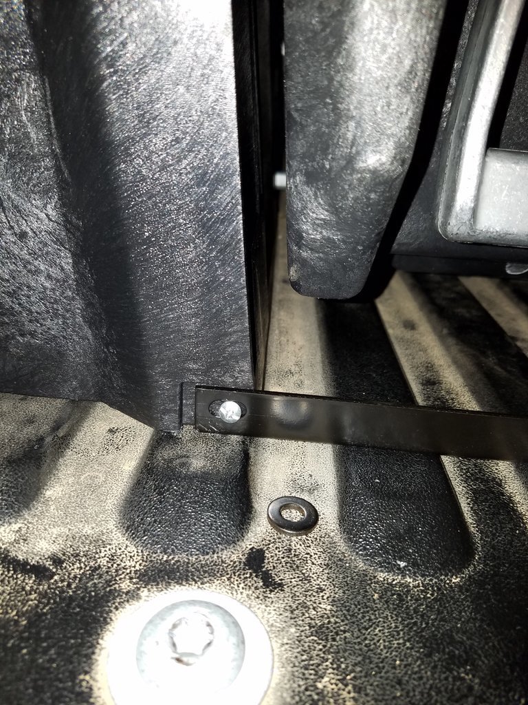

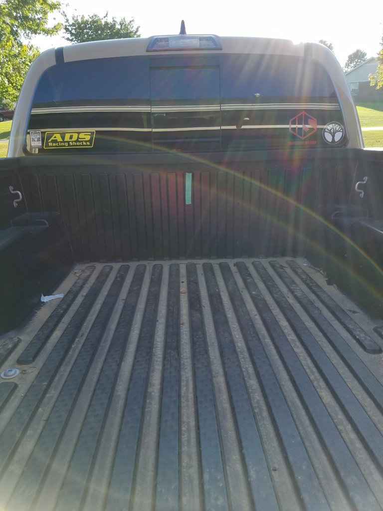

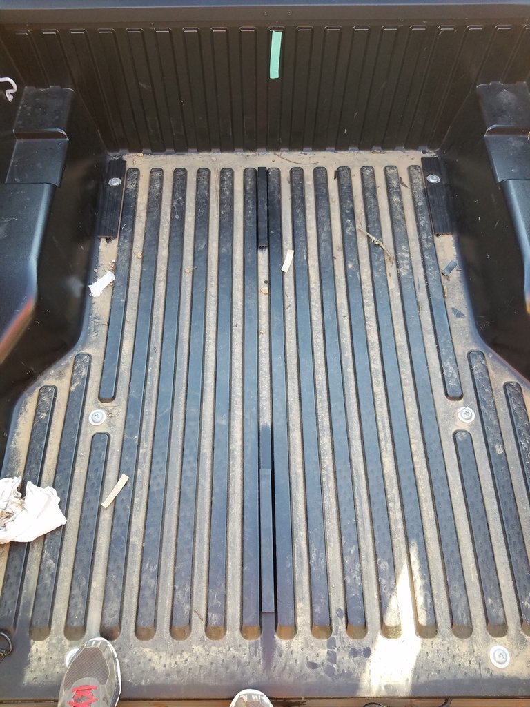

    First step was marking the midline of the bed. 28.5" from the side above the wheel wells. I didn't have a wax pen like the instructions said so masking tape it was. (Don't skip this step, you'll need it as a reference to line up the middle vert)
    The next step is installing the shims. 3" from the cabside with the small shim (lined up with the front of the channel), 6.5" from the tailgate side. The two big shims just go around the bolt heads on the can side. I cleaned the area with APC prior to sticking them down (they habe double sided tape on them).
    Don't judge the bed dirtiness, it's been under a bed Matt!

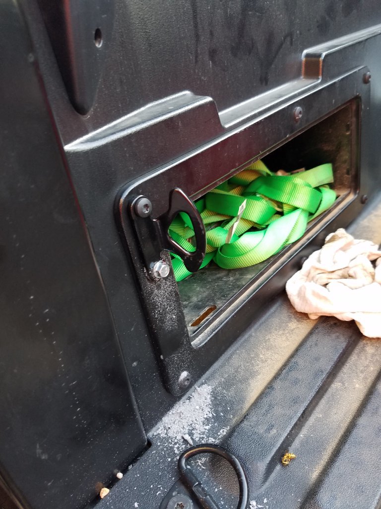

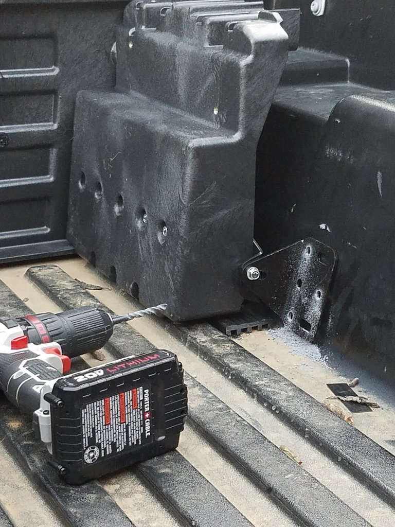

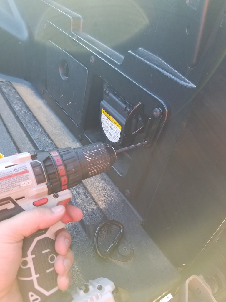

    The next step is to get a hole drilled for the rear side mounting brackets.
    Unscrew the top t30 torx head from the big storage box and the bed outlet. Install the bracket loosely, Mark where the hole needs to go, move the bracket out of the way and drill baby drill.

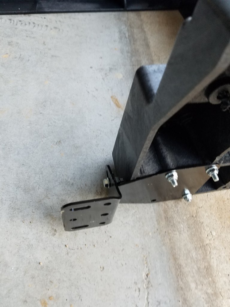

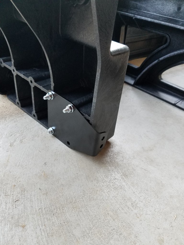

    Next youre going to attach part of the front mounting bracket to the side support. Pretty simple. 3 bolts tighten down.
    After that you attach the second part of the mounting bracket to the support. One bolt.
    (The second part of the bracket is backwards from how it'll actually be on the truck in this picture)
    Next you'll set up your masterpiece in the bed and get it aligned with the center line you taped up.

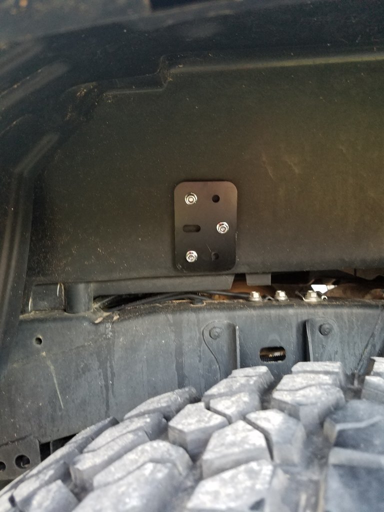

    Then you'll get the mounting brackets flush with the wheel well and drill out the three designated holes on each side.
    Then using three bolts you'll attach it via the mounting bracket on the underside of the well.

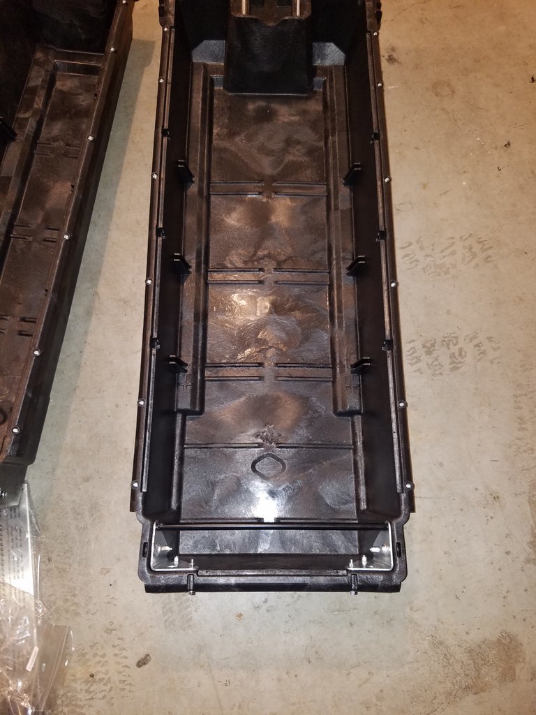

    Next you are going to install the channel guides in on both sides. Using a bolt and nut on the ammo cans (which you add in during this step) and just 2 bolts on the cabside support.

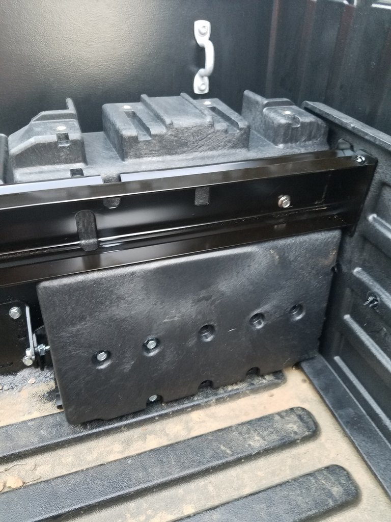

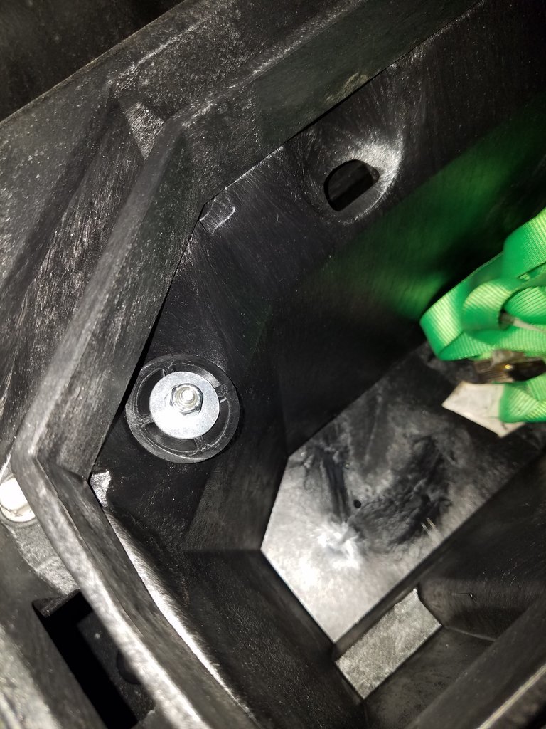

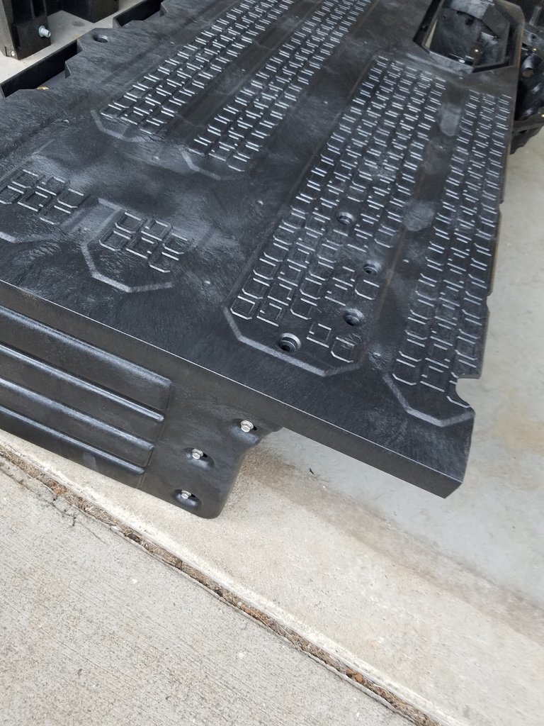

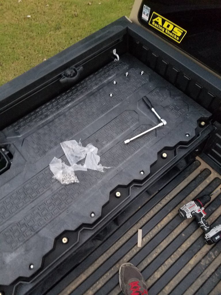

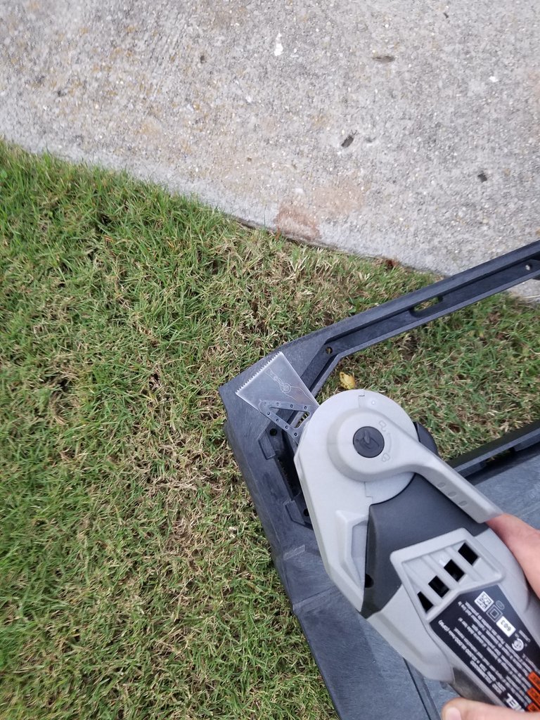

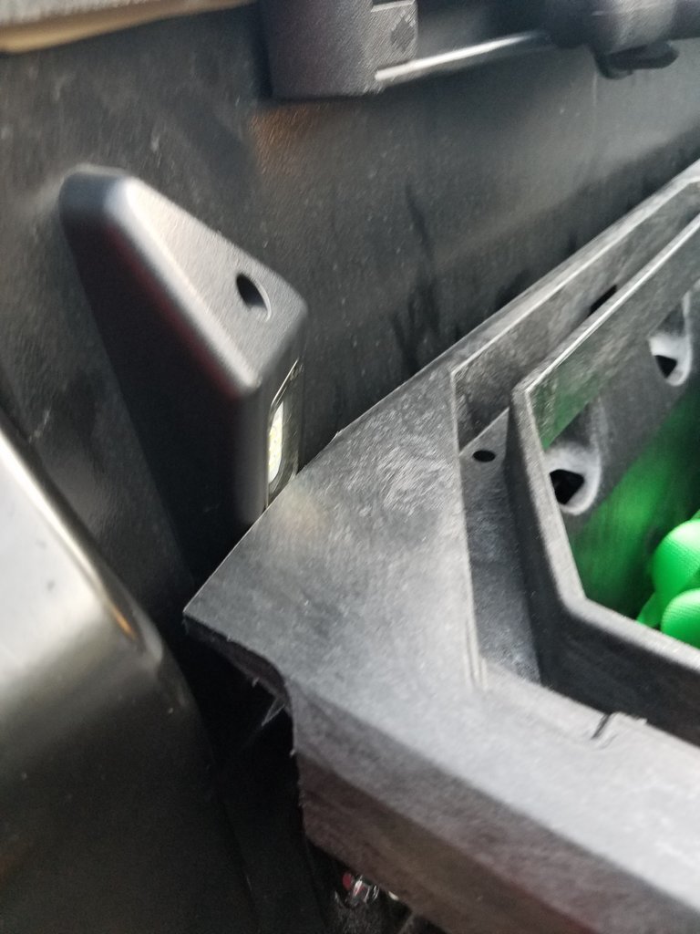

    Next, you will be installing the top pieces. The 12 bolts that go into the ammo cans and side supports will need o rings. The 5 that go into the center support will not. I had to take mine back out, as the bed pieces did not clear my LED bed lights. Super simple to trim, took me less than a minute per side with a all-in-one. :sawzall:
    It may look as if it's touching here but it's just barely not.20171011_182955.jpg

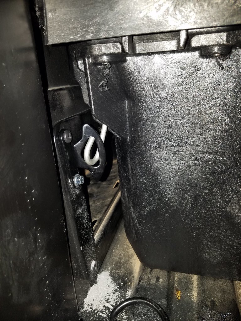

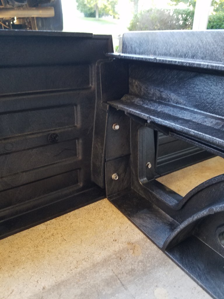

    Next will be the J hooks that hold the rear side in place. Easiest way I found to install was to push the hooks through the ammo can and around the mounting hooks you installed in the rear earlier.

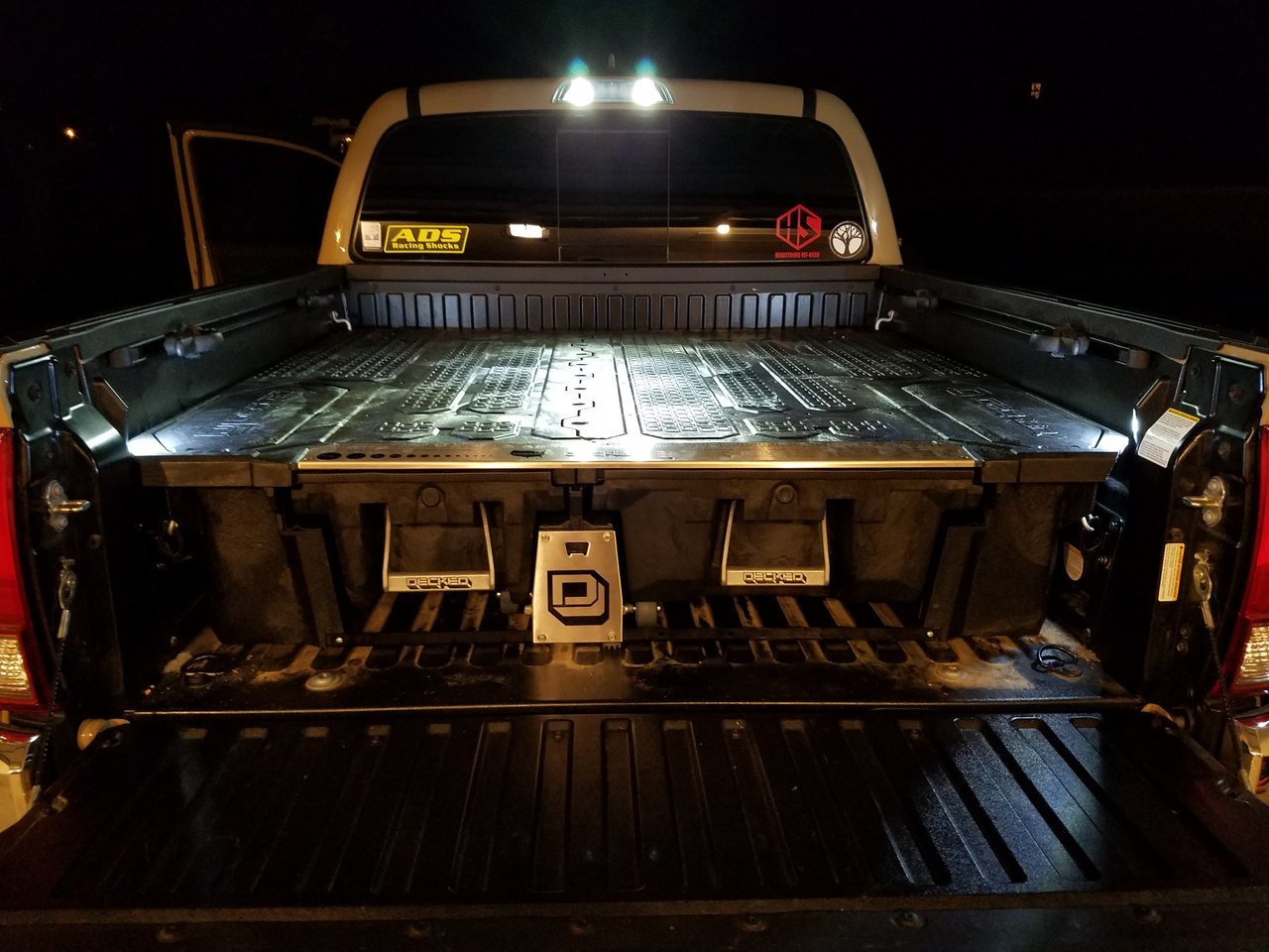

    Next steps are simple, I neglected to take good pictures of these steps but you will take the silver top piece and screw it in with three supplied screws, install the torsion bar with the two center bolts and two side bolts (my system didn't have the side bolt holes so I just screwed two of my own screw into the place, part of being a beta tester! If you order one yours won't come like that), popping the two ammo can lids in,and installing the end piece with my favorite addition the bottle opener!!
    And whala shes done.
    The install took around 3-4 hours. Moving at a steady pace, no beer or food breaks.
