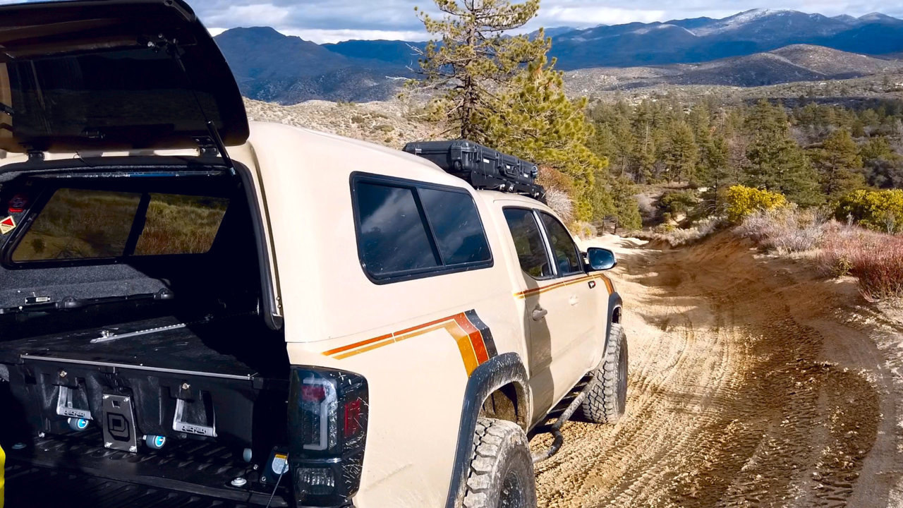

    When my wife likes to overprepare I put stuff on and inside Decked.
    This is what I put:
    2 Costco size bins
    2 Plano boxes stacked
    1 suitcase
    1 clear bin
    2 big sleeping bags
    misc other bags
    1 box of chips
    1 case of water
    And still have some room.
    Also when I want to keep my gear dry and safe when offroading, it's gotta be Decked!

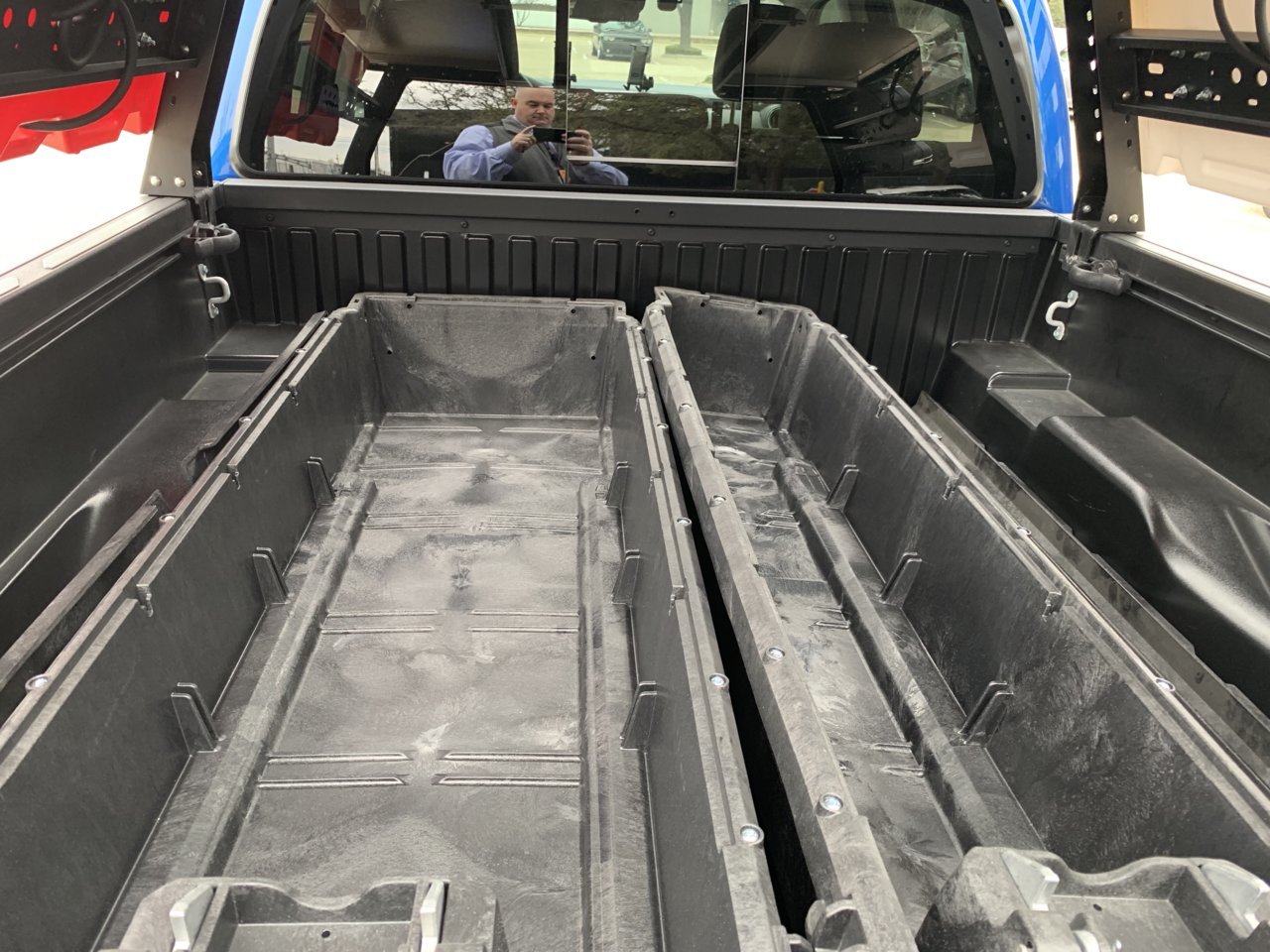

    The shipping box was too long to shut the tailgate, so I took everything out of the box and put it in the bed and back seat. Left work early and then started putting it together when I got home. Just got done with the MT5, lock set, and D Box. Too dark for pics, but I'll have them up soon.
    It would have gotten done faster but my helper is a hungry teen male that has difficulty putting a phone down.

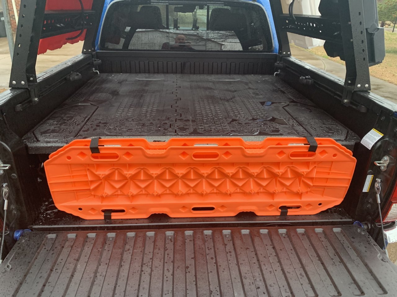

    This is a pretty solid mod. I still have some things left to do (Core Trax, dividers, maybe some other stuff) but I've already freed up my interior stowage from the cab, and put in some tools that I didn't have room for. It's very securely attached and I'm not disappointed in the equipment at all.
    Found the perfect space filler. This keeps my traction mats secure, and also prevents anybody from being able to mess with the drawers. I have the lock kits installed, but there isn't any room to reach down in the bed with the mats carried in this position. I plan on running a security cable along the rear tie-downs that I can secure the mats with just for complete security, but with the tailgate closed they are in there rather tightly.
    Here is a view of how the mats fit into that dead space between the tailgate and the rear of the deck.
    With the mats oriented this way, the teeth on the traction surface basically interlock with the rear of the drawer overhang. They are in there tight, and with the cable I don't think they will be very easy to rip out.
    When I have more time I'll put up some more pics and my thoughts on everything.
    Highly impressed with the quality of manufacturing, clarity of printed instructions, and the components. Having a list of the tools needed is something that isn't always included, but it makes prep go much easier. The modularity of the system is genius, and I really appreciate being able to buy only what I want, and potentially extras of things that I need (boxes, cargo locks).
    I will say that installing the lock set is not fun, and if you have somebody with tiny little fingers they would be of much benefit. Also, chase the threads on the lock cylinder body with the lock nut a few times before you actually install the parts. It makes that step go much easier, and it is still meticulous and challenging with big pasty Mick fingers.

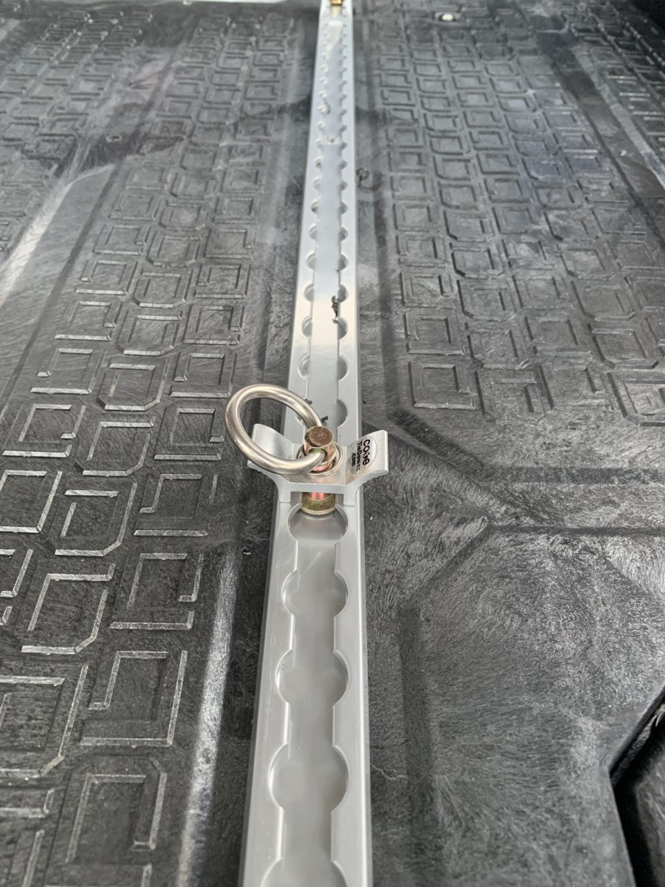

    Installed Core Trax. @DECKEDUSA, does the load on the Load Locks have to be perpendicular to the Core Trax? It seems that if there is a slight angle to the pull the Load Locks slide.
    Install was easy. I used some Gorilla tape to hold the Trax down on each end as I started the pilot holes on the ends of each. Had no problems until the very last hole. The drill bit broke off when I was drilling the pilot hole. With a bit that small I was concerned about that happening, so I was glad I made it to the very last hole to do that. Getting the shard out was not a lot of fun, but I was able to get it out. And like the instructions state, make sure you use a #3. Even with that you might need to watch how you run the screws in to keep from stripping the head.
    Really like the Decked system.
    Today I went back and used a small flat screwdriver and hammer to rotate the locking ring onto the lock cylinder body.
