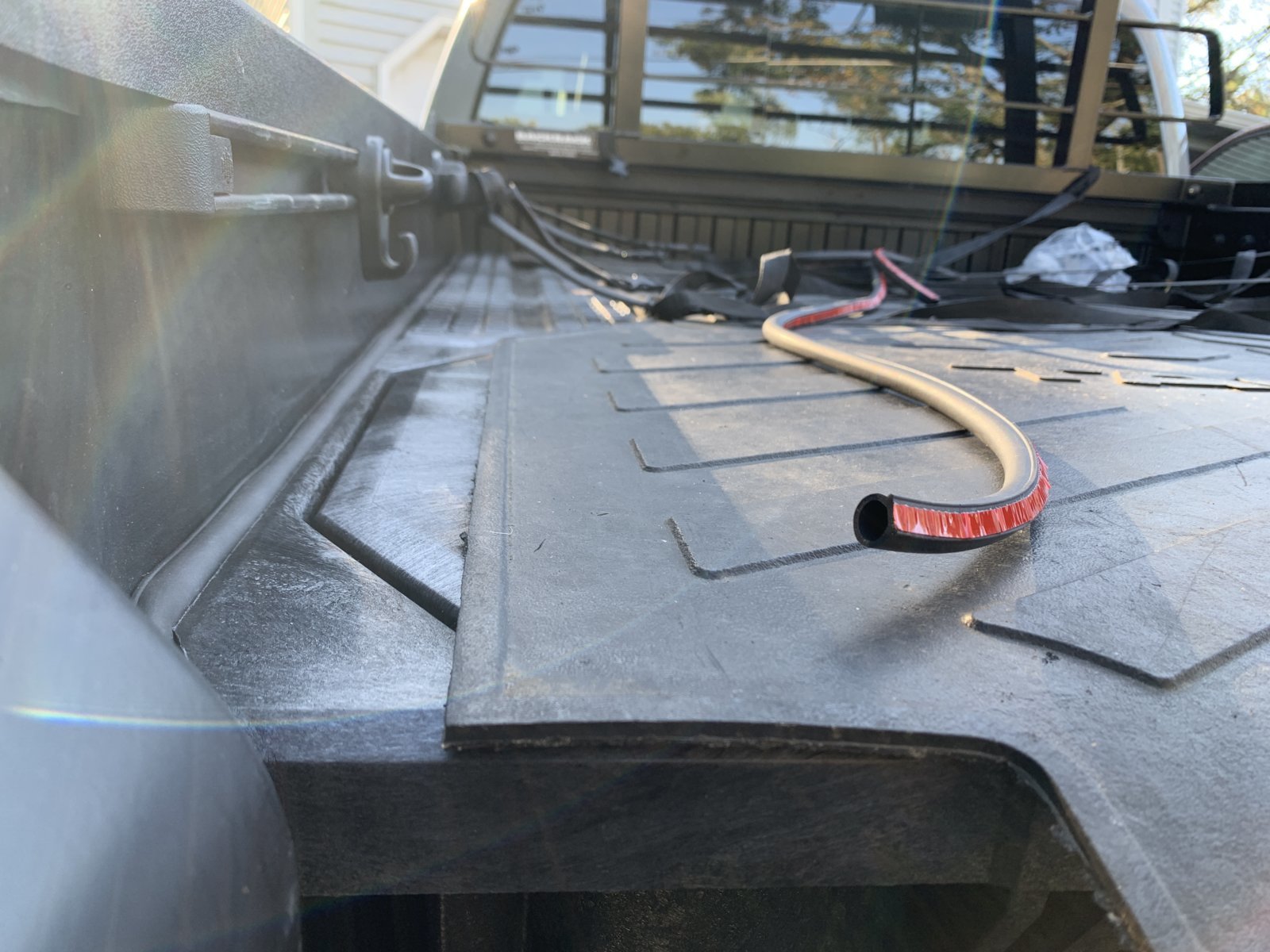

    I just bought a used Decked system for a 3rd Gen DCSB. It was previously on another DCSB, but I'm not 100% sure it is the model number made specifically for the DCSB Tacoma. Are 1/2"-3/4" gaps on each side of the box normal? (Between the box and the bed sides)
    If so, has anyone come up with a clever idea to keep debris from accumulating in the gap? I'm thinking about a fairly porous foam strip that will allow water to pass through but prevent leaves and other things that may fall into the bed from composting under the box...

    One of the most common requests we received was to 'seal' the edges of the deck to the truck bed. A decent way to do this is with a foam weatherstrip stuck to the bed, or better yet, a bulb seal in a D profile. Don't make a hard piece to connect and fill or you'll crack the decks. They expand a lot in the sun and will quickly crack, which is why the gap exists in the first place.

    I slept in my truck bed last night on my decked system and almost lost my glasses and truck keys to the gap. A lighter did make its way down.
    I was gonna go to Home Depot and grab some form of rubber or foam padding to stuff between but was curious if anybody had any other suggestions for prevention when using the truck bed as a camper

    I ended up using that adhesive expanding foam trim molding (not the stuff in a can, but the stuff that comes in a black roll), and it works great. Allows for the flex of the truck bed and hot/cold expansion, and will keep most anything from falling through the cracks.

    Do you have a link to what product you used? I installed a Decked today and had been thinking of using a spray foam with a couple of small tubes as weep holes.

    I've attempted to use spray foam for various projects and have always been disappointed in the results...it's just too hard to make it look good. I think it's also a little to rigid for this application.
    I used a foam weather strip tape that expands a bit to fill in the gap pretty nicely. just make sure the truck bed is as clean as possible when applying it.
    https://www.lowes.com/pd/M-D-13-ft-Expand-N-Seal-Foam-Window-Weatherstrip/3434324
    I've used this in my Ram 2500 for the same thing as well. I've been happy with the results. It keeps the big stuff from getting below the boxes and lets air flow nicely.
