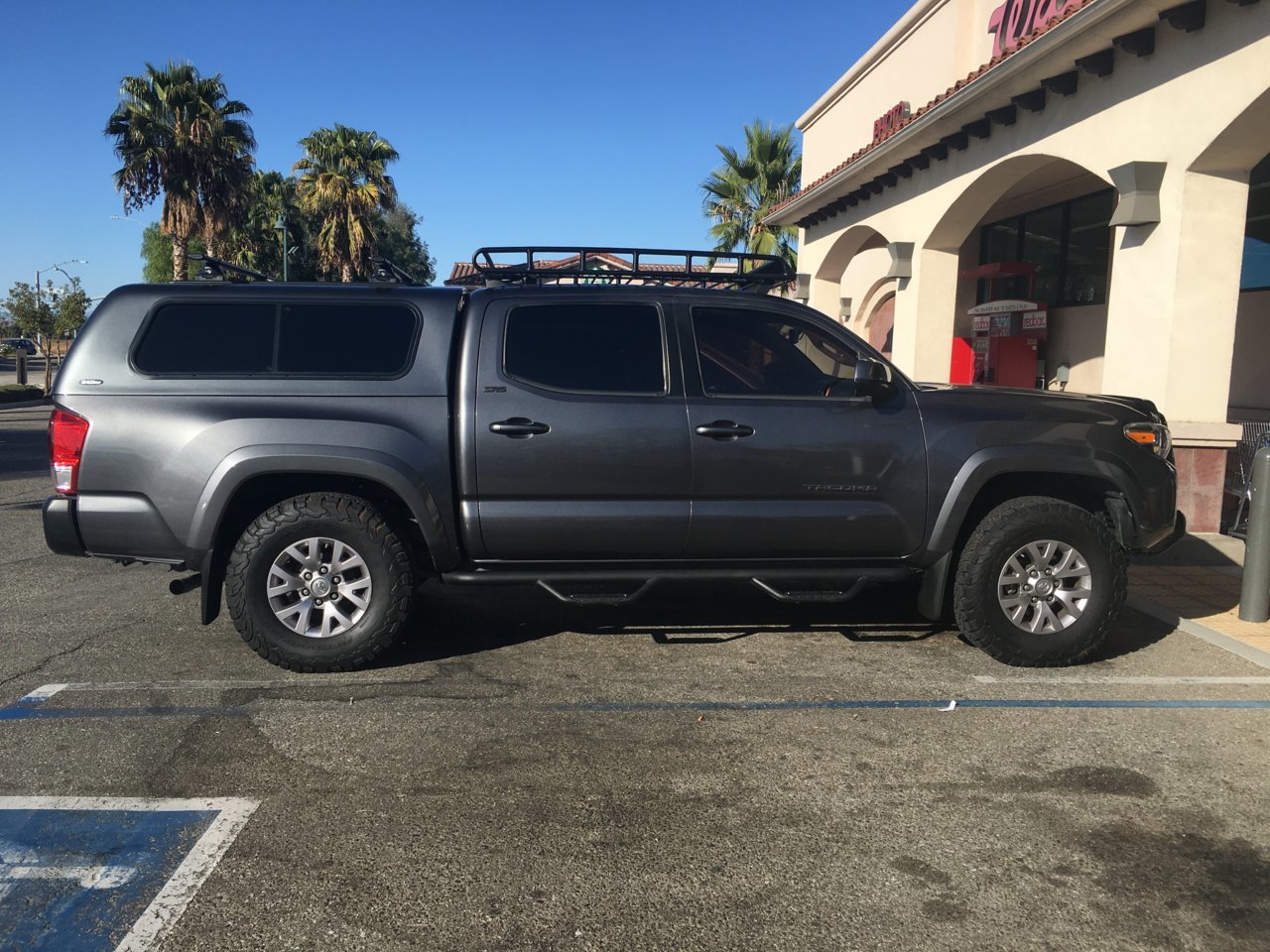

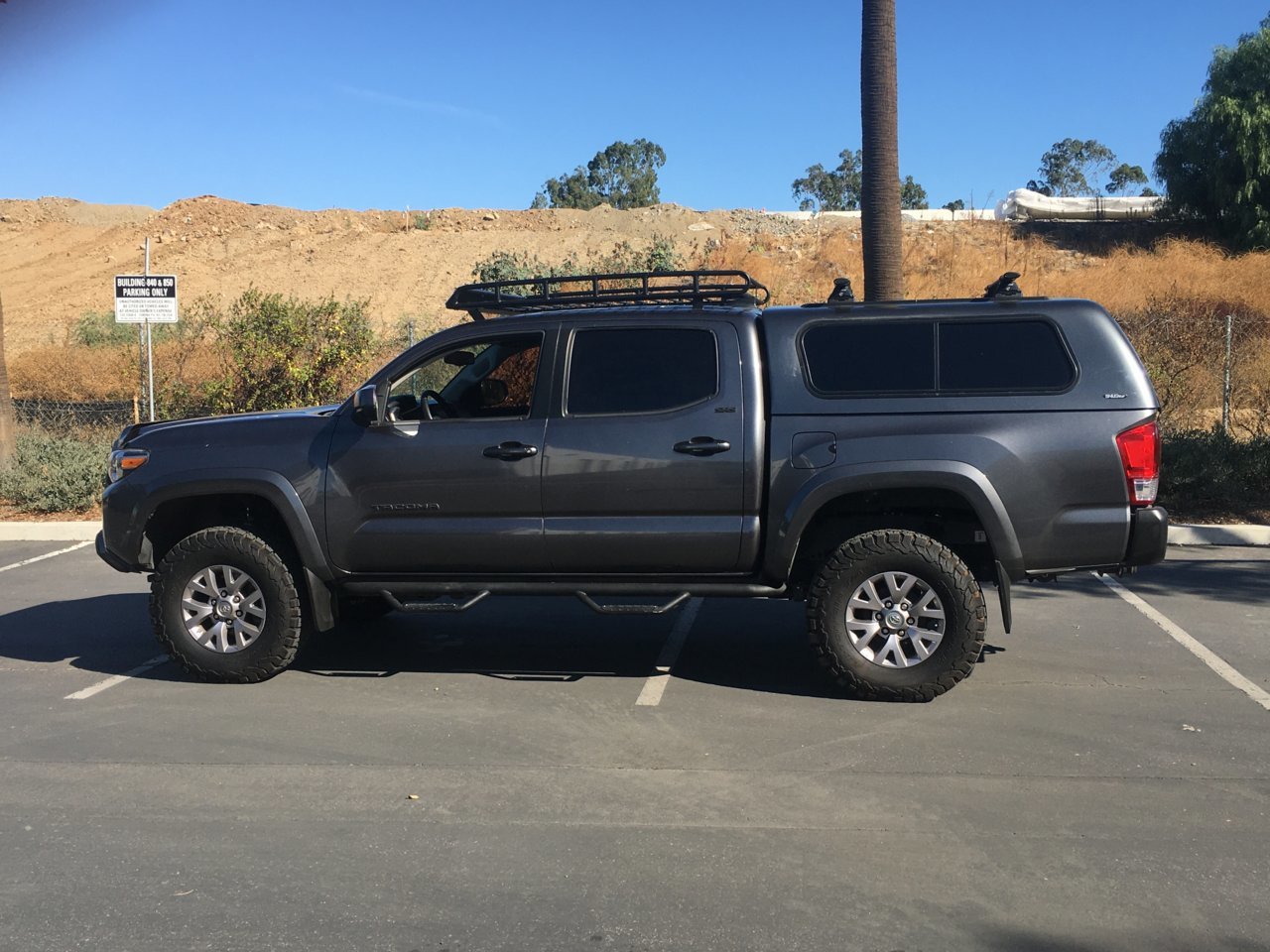

    Top is before lift and bottom after lift. About 4 days since install and at 2” lift over stock so far. Hope it doesn’t settle in more than 2”. Ride is way better than stock IMO, but ride quality is subjective.

    It looks the same?

    In the picture it kind of looks the same, really gotta compare the space in the wheel wells. In person it is very noticeable, rear was sagging alot. To me it looks so much better now.

    Bilstein lift kit w/OME Dakar HD leaf pack, but I changed the fronts for 6112:
    -Bilstein 6112 set at 6/5
    -Bilstein 5100 extended
    -ECGS Bearing
    -OME Dakar HD Leaf pack
    The kit came with extended u bolts, carrier bearing drop kit, extended brake lines.
    Got all the parts except the ECGS bearing from @HeadStrong Off-Road. Please speak to Marie for quote.

    I see a big difference in the pics, looks sharp man. I've piled on the miles on this truck and dumped cash in to it and now I'm itching for a tundra...

    Thanks, that picture was taken right after lift so there was quite a bit of rake. Things have settled and in comparison (using side view mirrors) height is similar to TRD Pro. I wasn’t looking for anything more than 2”-2.5”. 3” would be nice if I didn’t have to worry about parking garages.
