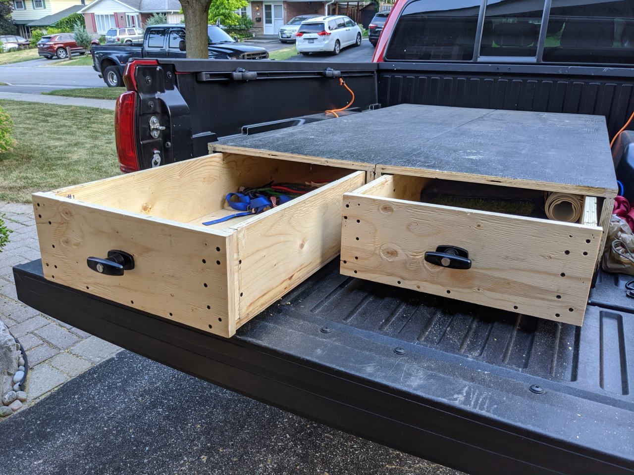

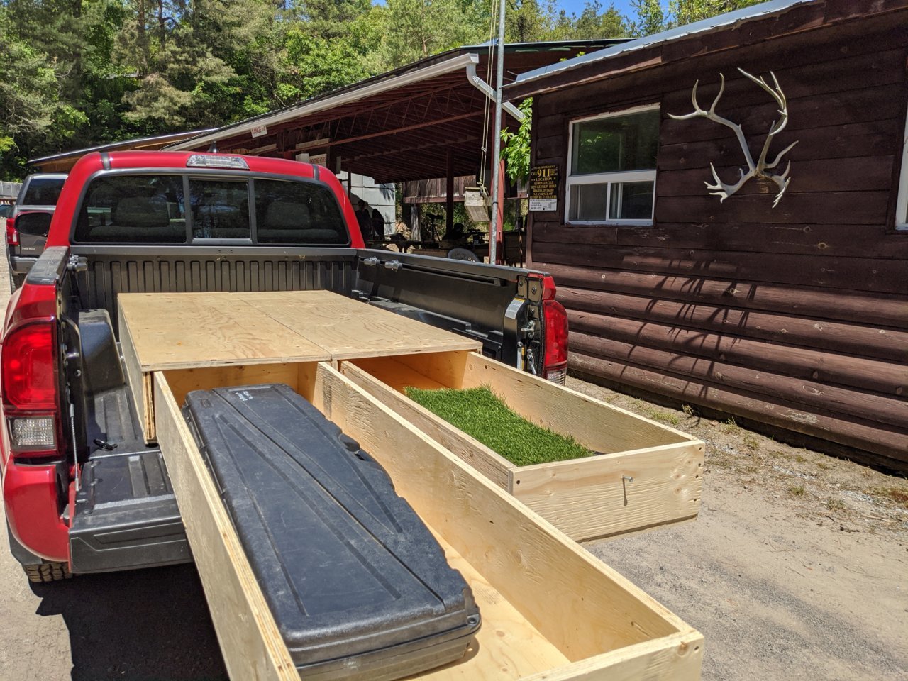

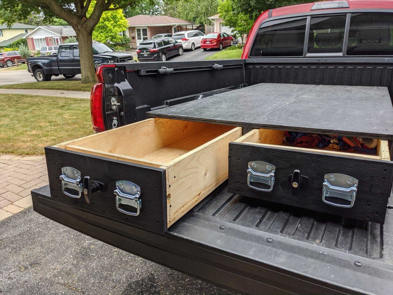

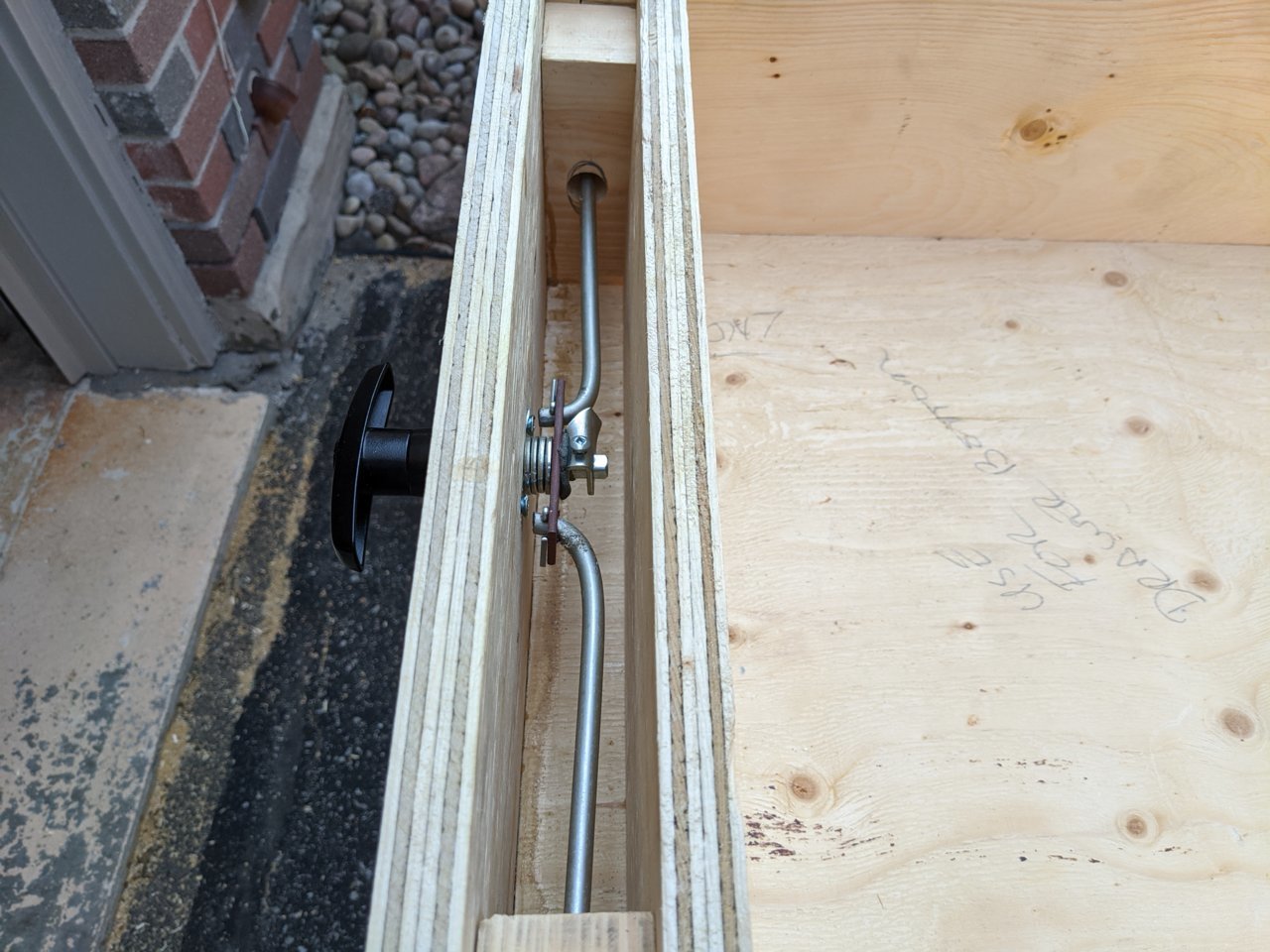

    I think they look great and totally well made, just too pricey for me. I ended up making my own version, starting with two drawers. I may add a sliding tray on top to make loading in/out easier of things we carry that don't go in the drawers. The drawers were built to carry two rifle cases. I wanted the top of the boxes to be flush with the wheel well tops. I just secured them with turnbuckles. I can leave them in, run with only one, stack them if I chose too, or take them both out should the need arise. I followed the youtubes for ideas and parts suggestions.

    Based on that locking t-handle system, I know exactly which youtube video you got your ideas from :D

    you probably could sell those boxes

    Yup! Giving credit where it's due. https://www.youtube.com/watch?v=d-BWmPaBfjQ&t=5s
    Hard to find a better solution for me. Rough carpentry at it's best on my side, the youtube dude is more precise, but it worked out great.

    I think you're on the right track. I used 3/4" plywood, several sheets @ $50 each, plus HDPE for the sliders about $65, no wheels, or bearings to save cost, The locking T-handles were about $80 CDN, from the local truck topper store, the chrome handles were $20 for a pair from Lowes and a gallon of paint $70 (used about 1/3) the rest will be used for annual recover when/if needed. Miscellaneous hardware for anchoring the boxes to the bed, T-nuts, cap head bolts 3/8-16x3/4", turnbuckles etc another $20 or so.
    It adds up, but still way less than $1K plus tax and delivery and exchange rate to CDN $$
    Good luck with your project, post the results!

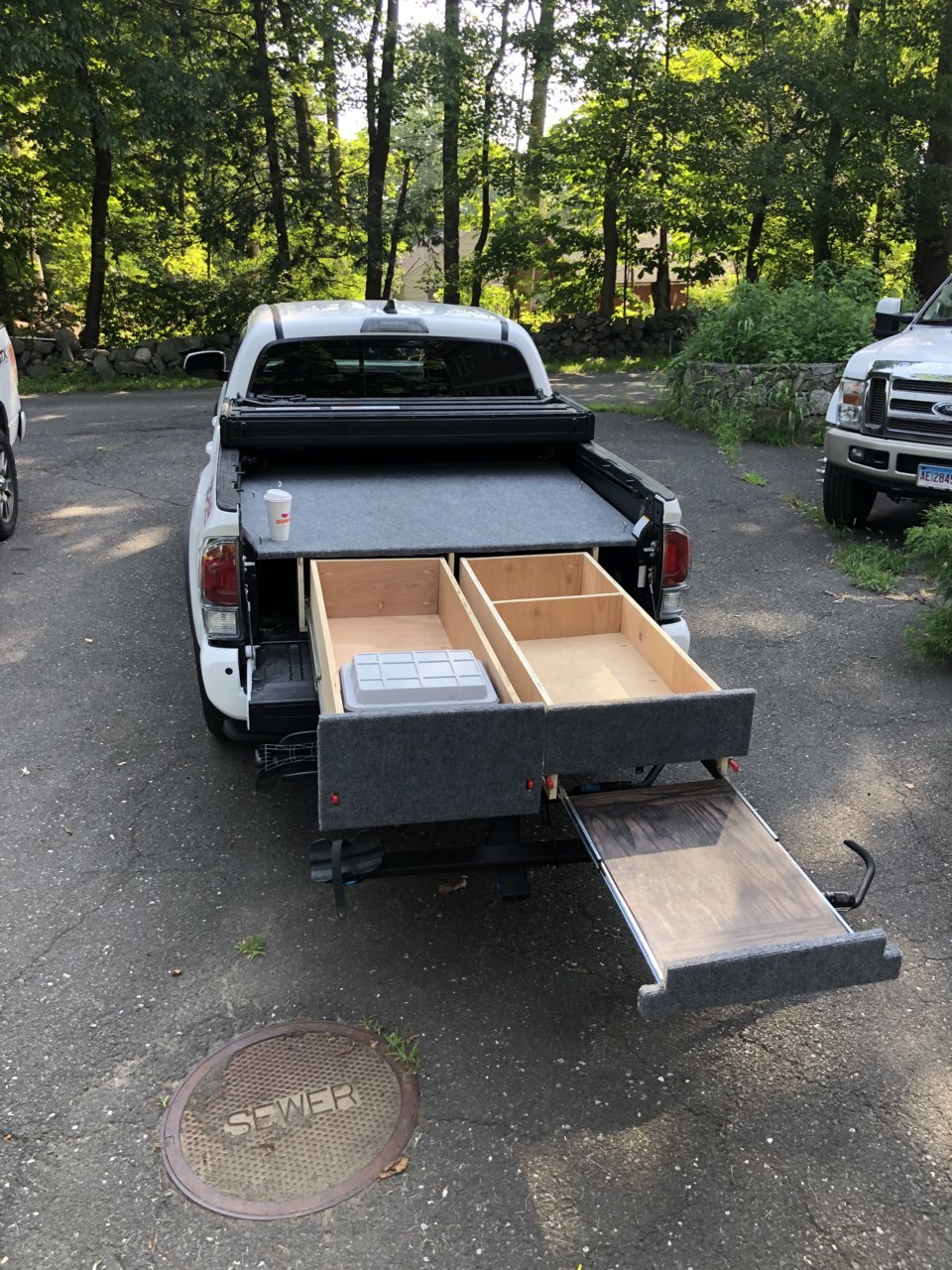

    About $600 in materials including 2x 48” 500lb locking sliders and 1x 28” slider, 3 3/4 birch plywood sheets, screws, carpet, glue, etc.
    Worth it for me but I’ll have a fiberglass shell to harbor it in so it’ll be out of the elements. Decked is the way to go if it’ll be outside all the time.
