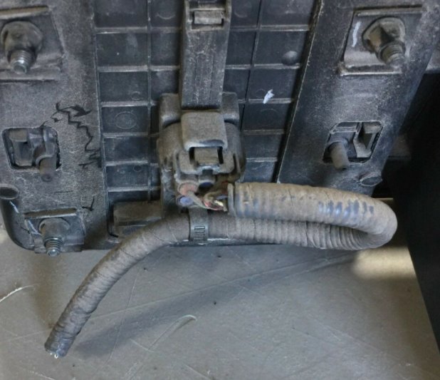

    I picked up a used DECKED system for my DCLB for $350 last week. I saw the deal and I jumped on it as that is a crazy deal. I am excited to get it installed and put to use, however I am waiting on some missing some hardware to arrive that I have ordered from DECKED.
    I know the biggest complaint I have seen with this system is the loss of the power outlet, and frankly, I don’t want to lose that ability either. I run a woodshop on the side that has a commercial CNC machine that can cut all sorts of materials. I plan to make a bracket out of HDPE on the front right of the decked system to add this OEM outlet and my end goal is to make this plug and play.
    I have ordered the OEM outlet, part 8553004020. Picture below. I am having a difficult time finding the wire harness part number, or even just the clip/socket so that I can make an extension harness. The end goal is to basically make an “extension cord,” so that you can remove power to the outlet that is no longer accessible and apply it to the outlet that will be accessible via this bracket, at the front of the DECKED system. This way if you ever remove the DECKED system, you can restore power to the original outlet.
    Any help finding this part number for the harness or clip/socket, would be greatly appreciated. I will keep you all in the loop as I move forward with the build.

  5. May 11, 2021 at 8:47 AM
    kmorgan3
    kmorgan3 Redside Electric, LLC | VLEDS
    Aug 22, 2019
    #302994
    1,774
    Kyle
    PNW
    2019 Tacoma SR | 2020 4Runner SR5 Premium
    I have the male and female part numbers for you to make an extension. Do you have the right crimp tool?
  6. May 11, 2021 at 8:54 AM
    BoomerTaco8
    BoomerTaco8 [OP] Well-Known Member
    Mar 10, 2018
    #246891
    86
    KY
    2017 Black TRD Sport DCLB
    Thats awesome - I do not as I am just getting started down this path, but I dont mind buying new tools, haha.
    Do you mind sharing those?
    kmorgan3[QUOTED] likes this.
  7. May 11, 2021 at 8:59 AM
    kmorgan3
    Aug 22, 2019
    #302994
    1,774
    Kyle
    PNW
    I shot you a PM with a diagram and the part numbers :thumbsup: You're going to need a sealed open-barrel crimp tool. Amazon has some decent ratcheting style that are affordable.

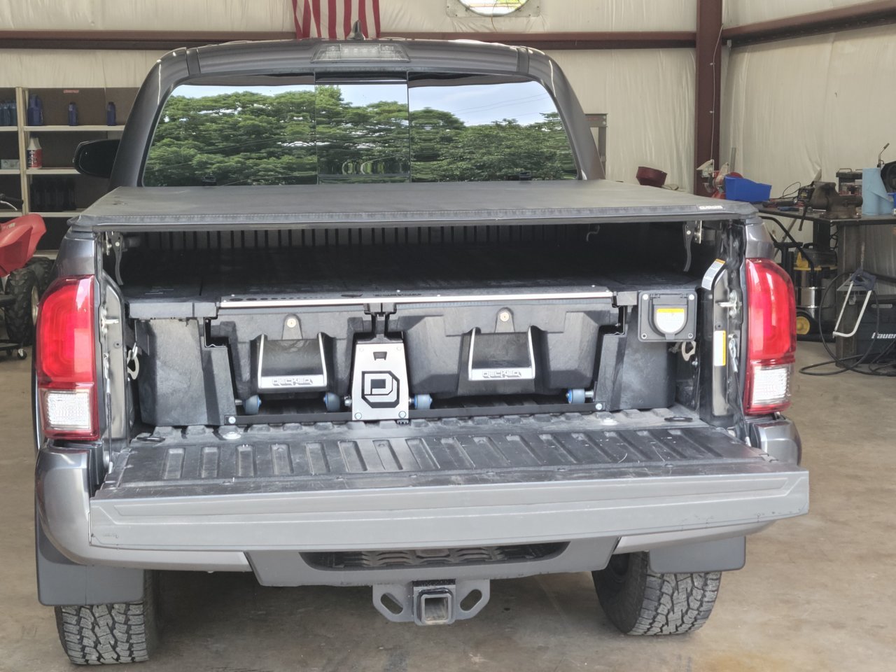

  13. Jun 3, 2021 at 5:10 PM
    The Koop
    The Koop Member
    Jun 3, 2021
    #367563
    10
    The Koop
    2017 Toyota Tacoma TRD Sport
    2.5 lift, Decked, High Tuck exhaust.
    This is what I did. Undid the wire strap for extra length and used spacers behind bracket where bolts go through. Easy Peezzy. Next I am installing Koplin gun mounts to hold my rifles. I will post pics when that part is finished. BTW this electrical bracket is held sturdier than it looks.

    caribe makaira
    caribe makaira Well-Known Member
    Feb 13, 2011
    #51121
    9,090
    Caribbean, Puerto Rico
    05 PreRunner TRD Offroad AutoTrans
    Hood Struts, My version Fogs always ON, Map & Overhead Light Mod,
    No rubber cover for the gapping hole on the bed wall?
  15. Jun 3, 2021 at 5:28 PM
    The Koop
    The Koop Member
    Jun 3, 2021
    #367563
    10
    The Koop
    That's why I have a Tonneau cover. Besides that behind the panel itself is wide open to the elements anyway. Kinda mute to try to seal it up. But alas I digress. Still better than having a cord laying out.
