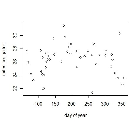

    25-30 is about what I used to get in summer;
    This is the truck's mpg ~140k (day of year 1= Jan 1; 200= July 18). Mixed driving, mostly highway.2009 mpg.jpg
    I still keep track of mpg, thought I haven't made time to enter it in a spreadsheet the last several years.
    So you disagree that the sensor (02 or MAF) could be off enough to affect mpg, but not throw a check engine light?
    I agree that the compression check would be very informative (and I'll get around to it), but on the other hand, I'm not going to rebuild the engine...if compression is well below spec, then that's my lot. Regardless, I'll still consider other cost-effective ways to improve my mpg (like replacing the original 02 sensor/cleaning the MAF), before I eventually sell/scrap the truck.
