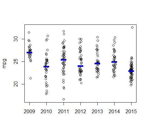

    I took some time to enter summer (May to Oct) mpg for the truck into a spreadsheet;
    Each black circle is a MPG calculated after a complete fuel-up, and the blue lines are the median (i.e., 50% of mpg records are above or below that value). I didn't do much quality control entering this, but should be good enough for my purposes.
    The drop after 2009 makes sense, as this was the last summer before I moved west, where highway speed limits are 70-75 mph (instead of typically 55-65) and lots of gravel road miles. 2010 was a low mpg summer, and I think this was because 80% of those miles were gravel.
    In a given year, I believe the points above the median are probably paved highway miles, and those below the median are gravel and city miles.
    So noting all that, it appears that summer 2015 was the year when my mpg dropped off substantially. Average mpg is 1-2 lower than previous 4 years, and even in good conditions I get very few mpg over 25, compared with 2011-2014.
    I've had the same summer tires from 2013-2015.
    Seeing that the decrease in mpgs wasn't all that gradual, very curious about a compression check now.
    Any other ideas on parts that could influence mpg like this without throwing the check engine light?

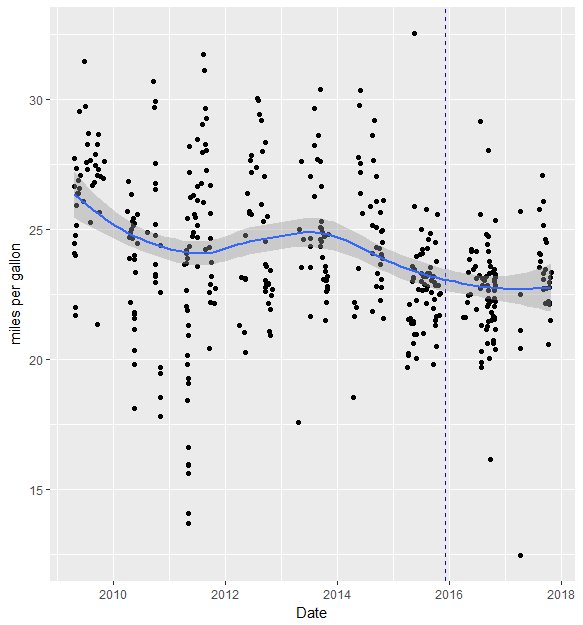

    Its been about 2 years since the last post so probably have enough mpg data to answer the question of whether new 02 sensors, MAF cleaning, and new spark plugs made a difference in fuel economy. The answer seems to be no. The vertical dashed line in the graph below is when I made these changes. The truck is now at 298,000 miles.
    tacoma world vertical line is change of 02 sensor MAF cleaning and new plugs.jpg
    Seasons are color-coded. The definition for seasons was Nov 1- March 31 = cold season, April 1-Oct 31= warm season.
    Tires have different shaped symbols, don't seem to be a confounding factor.

    mpg you have to factor in the terrain and since we now have ethanol in our gas that too effects mpg. low rolling resistant tires seem to be a thing when it comes to mpg but not sure how much when its mounted on a truck. mix driving of city and highway is usually between. also weight.

    Agreed - lots of factors affect mpg which I didn't record, that's clear in the variation within seasons. But there doesn't appear to be a difference in the average directly before and after the maintenance I did. My location and driving habits didn't change in that period. So based on this experience, I wouldn't recommend the preventative-maintenance I did to improve mpg.

    Agreed. I thought I might be able to find a "fix" because the drop in mpg seemed to happen "all at once" in 2015 with no change in driving habits/location. The change wasn't substantial enough to warrant "chasing" the problem, besides doing some overdue maintenance. In any case, I hope my experience will be informative for other owners of high mileage tacomas.
    The graph below tells essentially the same story as the last one, but with a few more years data for context. This is my summer mpg (mostly highway) with a line that's kind of a moving average- note how the distribution of mpgs changed somewhat abruptly in 2015, and stayed down even after maintenance. (the change from 2009 to 2010 was probably due to moving to an area with higher max speed limits and more hills).
